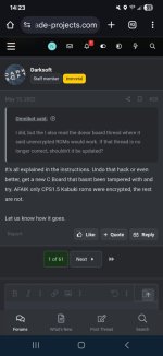

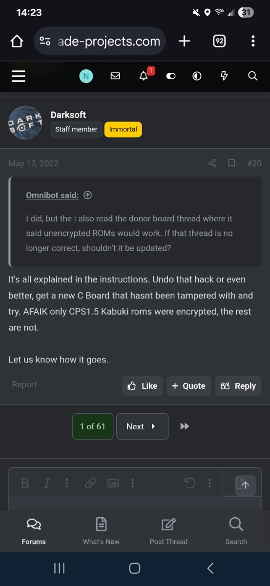

Update, just spotted this post from @Darksoft. So its only the 1.5 roms that are encrypted?

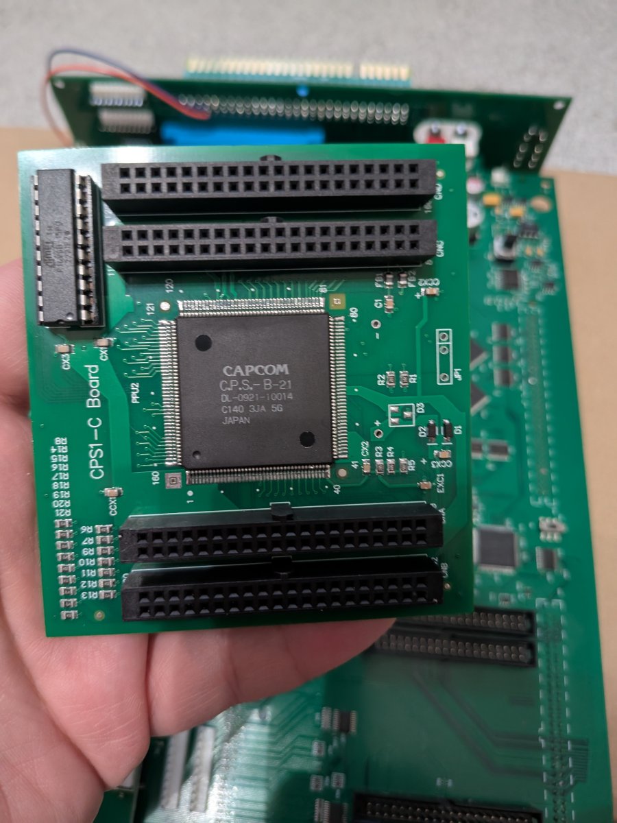

No, only sound CPU was encrypted. In the rest of the games, what changes is the chip in the C Board. The multi is able to inject keys and make a C board with a B-21 if it's proper version, to work as any C Board.
I have 3 x donar boards and all have the same c-board 92631C-6. I understand these are only rated as 'good' donar boards in the guide which is not ideal,
Don't mess with that. IMO is better if you get a repro C Board or try to find another donor which has not been modded. My 2 cents.
Thanks for that. I guess I'll need a to find a repro board.

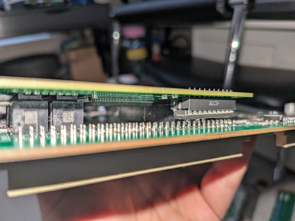

I think it was very well in place haha, still managed to gently take it out and put bit back, still the same as before, static : (amplified like crazy so you can here something helpful(?)
https://streamable.com/882txu
(I did screw it back obviously👍)
Follow up, Darksoft sent a we dsp15a q-sound module replacement, but just before it got there, I received a PLCC extractor and reseated the Lucent Chip, and it did the trick8o (as a warning, do not attempt this without said extractor and without knowing what you are doing, it would be a shame to brake one of those chips:thumbup:)

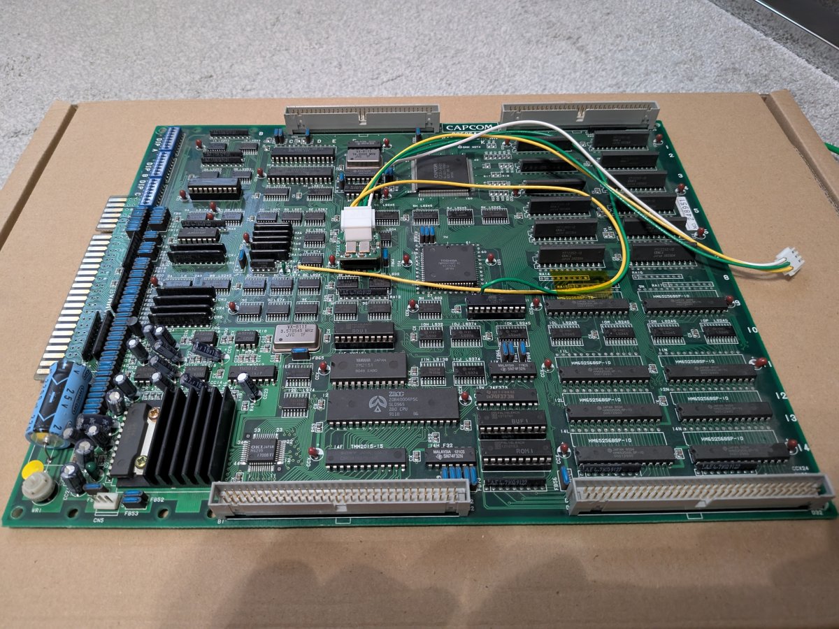

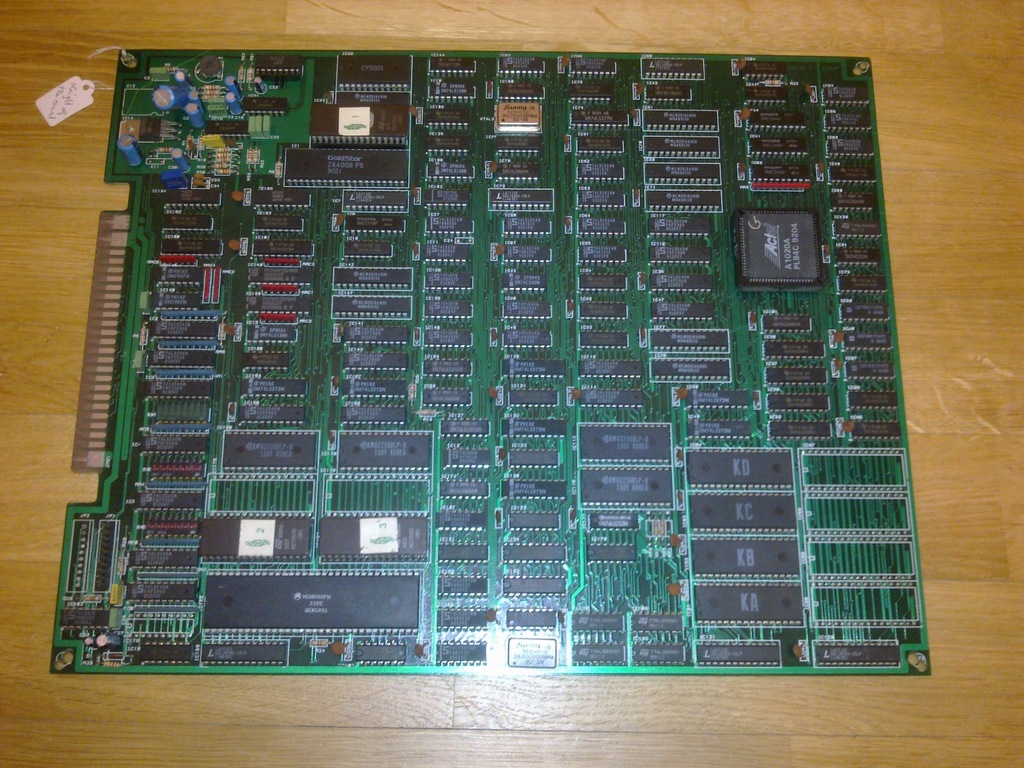

There were some cps1 bootlegs/hacks that came on pcbs that looked like this
Not real cps1. So those wouldn’t work. Others do, but they’re actual cps1 hacks. Which rom are you trying to get working?
