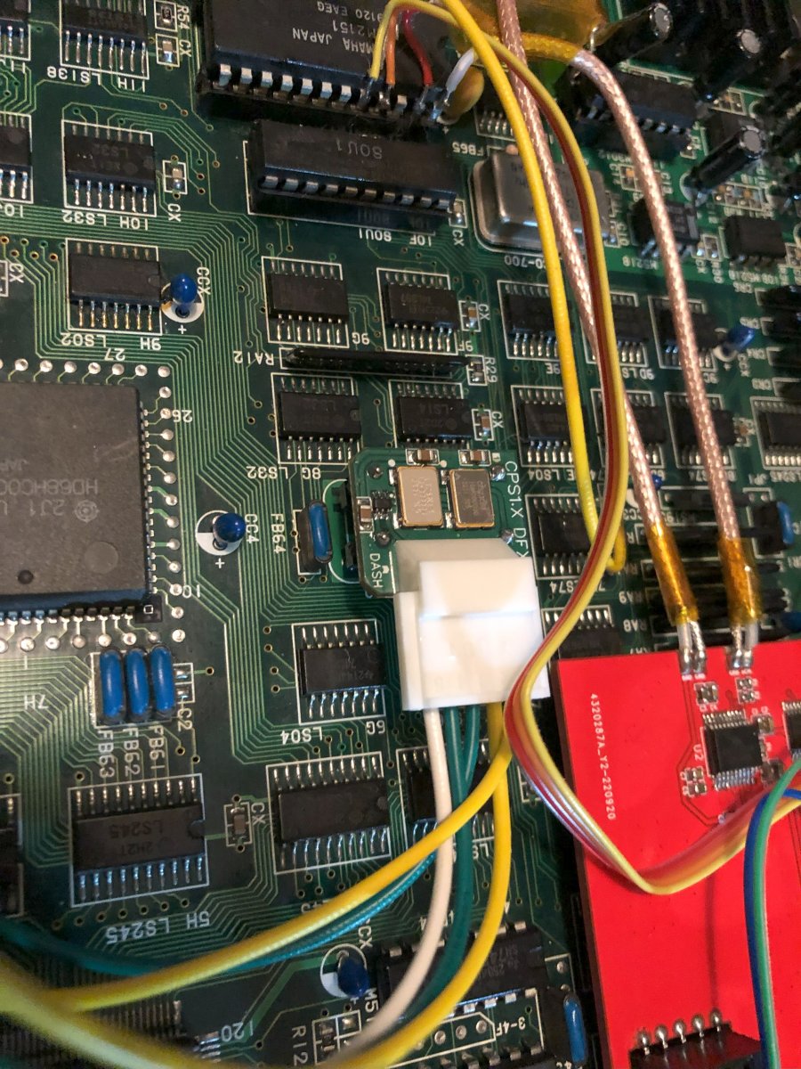

If the wire isn't hooked up at all to the wire on the multi - can I assume that it just fails to the 12mhz crystal?
DO NOT leave the DASH pin floating/disconnected. The switching IC requires the connection to be made to function properly. If you want it to run at 12mhz, you have to ground the Dash pin if you are not hooking it up to the multi.

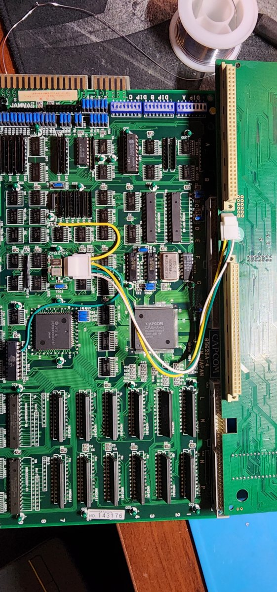

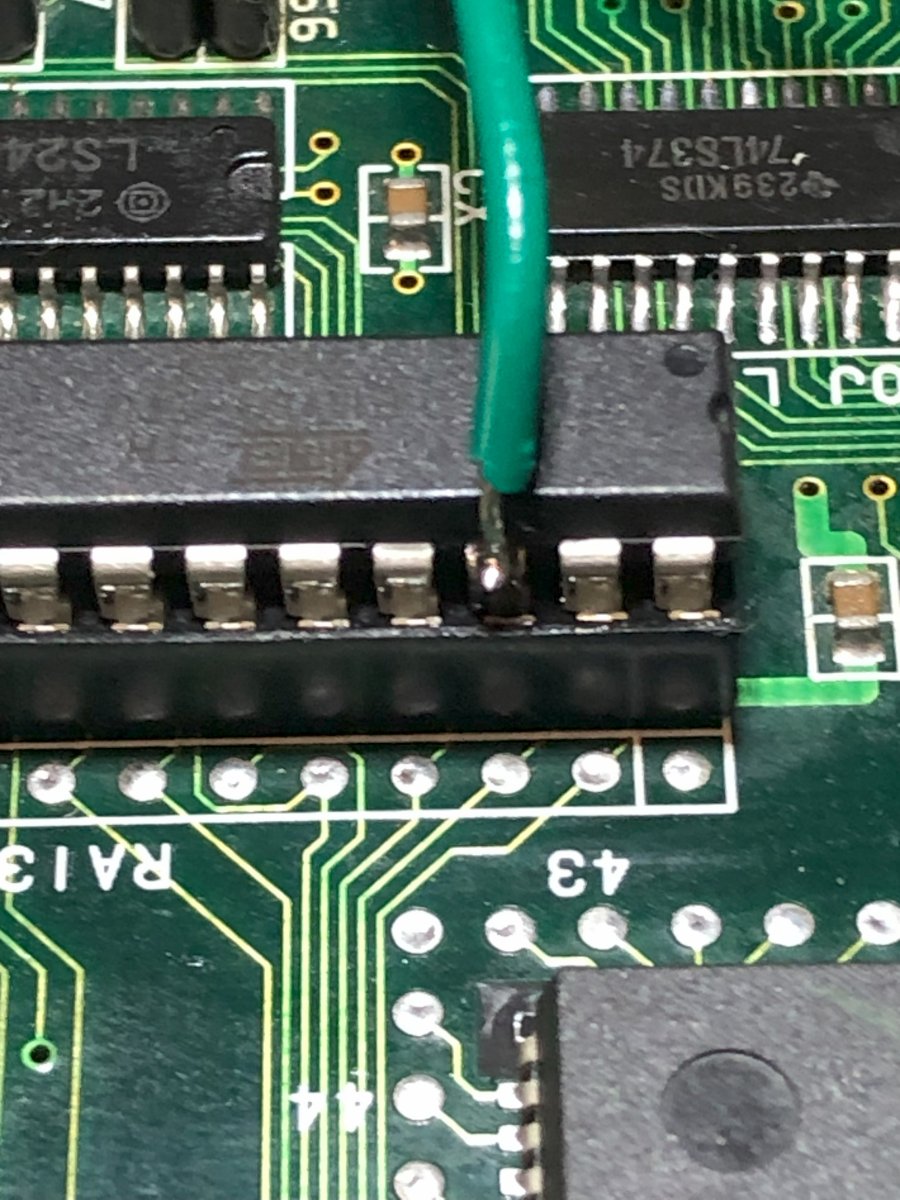

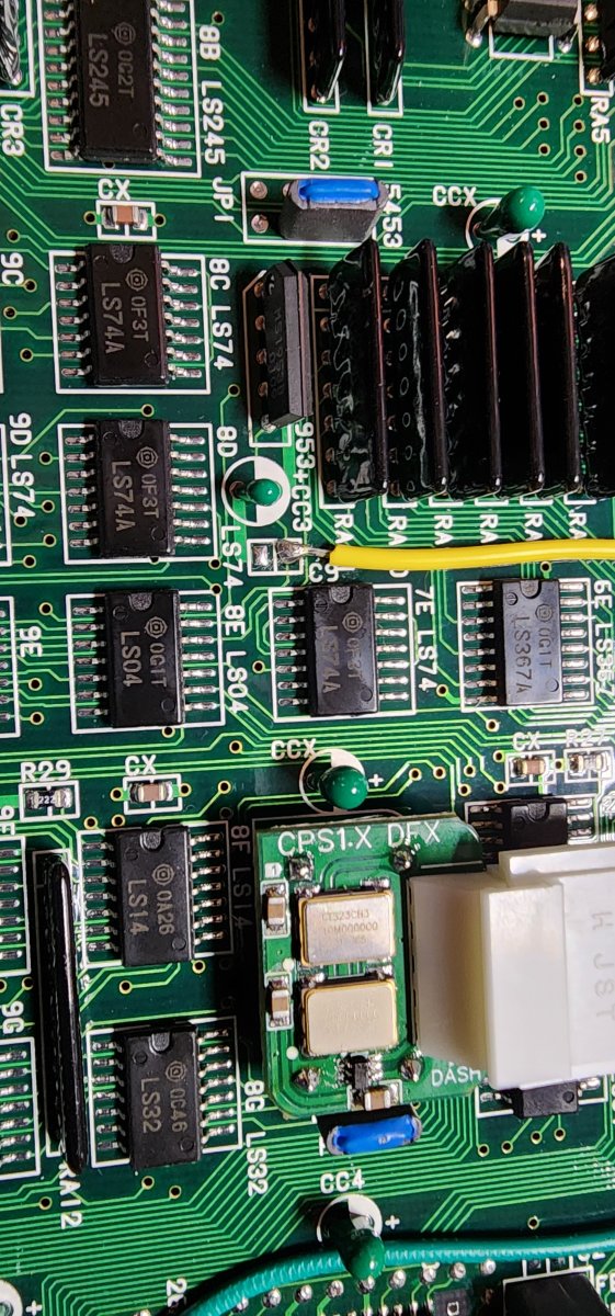

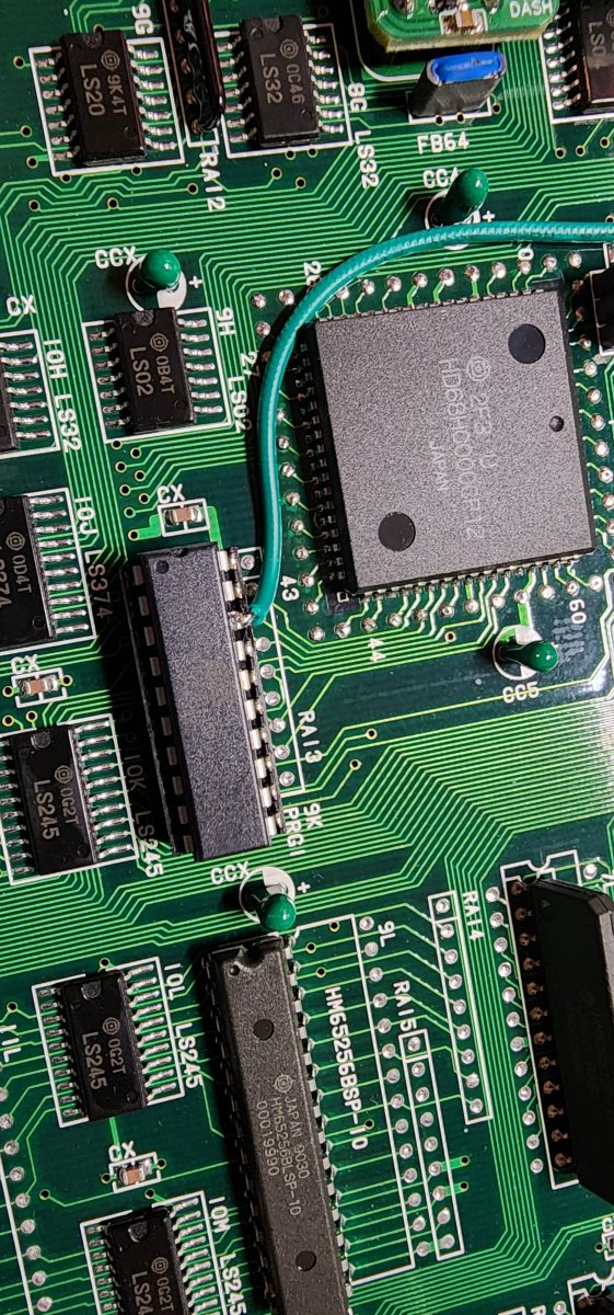

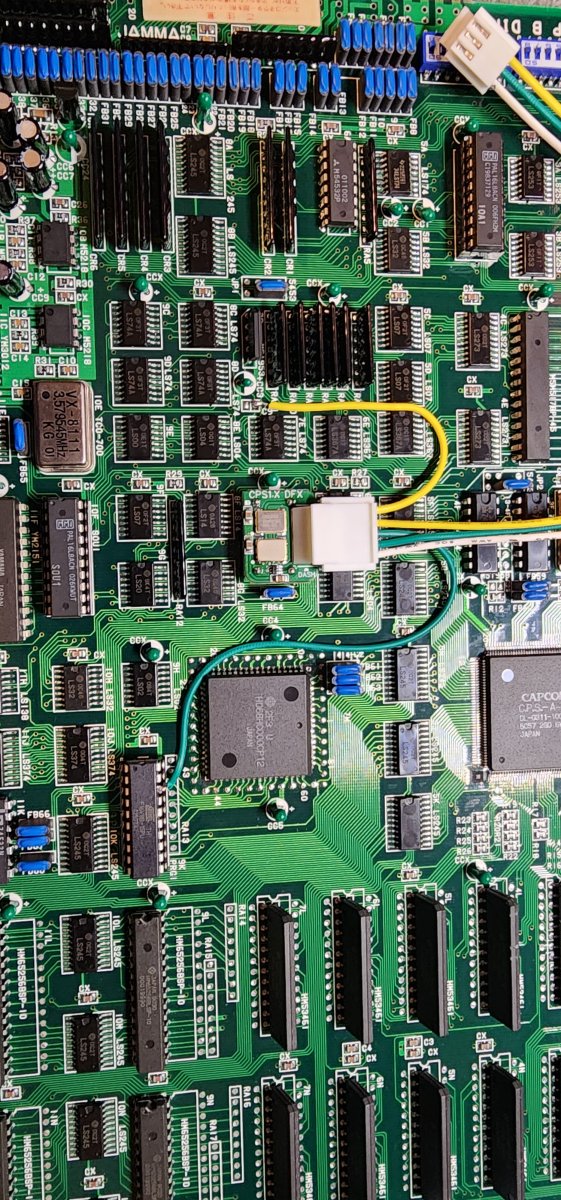

Well turns out I didn't have to wait! Install went super smooth and now my novice testing shall commence!

@raynex what game were you going to where you could see the difference?
I noticed it in Knights of the Round. At 12mhz some places were too smooth; like 60fps fidelity, where 10mhz was fast, but not like that. Overall pacing feels better too at 10mhz.

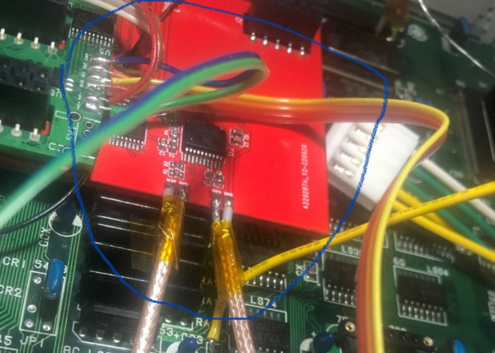

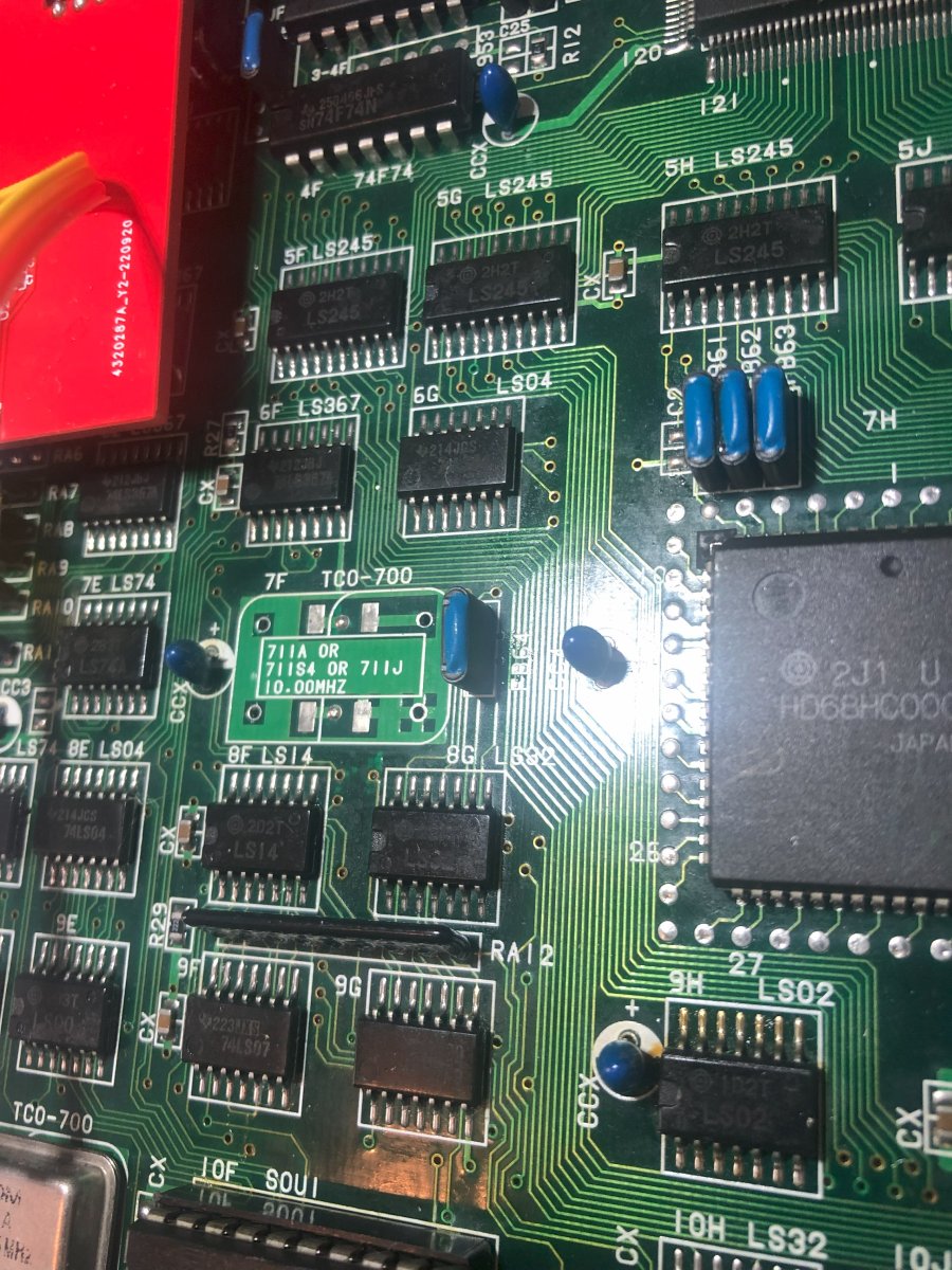

Hi. What is that red PCB for?
CPS2DigitalAV HDMI mod. You need that adapter board to work on CPS1. That's the next step later this morning for me to finish up cause there's a new board that directs the Qsound audio through the HDMI mod. The red PCB wasn't designed to do that.
