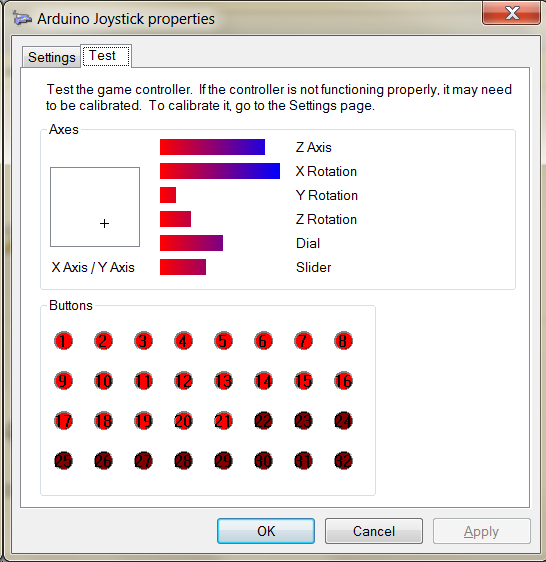

I'm ditching the HoodLoader stuff in favor of something much easier. I read over both HoodLoader and HoodLoader2 documentation and don't think it actually does what I want.
But I found something more appropriate and pretty simple. It doesn't need any fancy libraries and it uses the DFU programmer to upload the firmware and makes the MEGA2560 recognized as a HID gamepad with 8 analog axes and 40 buttons. Guess what? That fits in with what we need for a Type 1 I/O. I'm not going to screw around with trying to relabel the axes. It doesn't matter what it reports itself as. All that matters is that it's usable in a PC program, like MAME.
It will be up to someone else to make it more advanced, if that's needed, like making it report as 2 gamepads, etc. It will do what I want as-is and I'm kind of tired of messing with figuring out HID stuff on the MEGA 2560. :P (KISS: KEEP IT SIMPLE, STIPID!)
