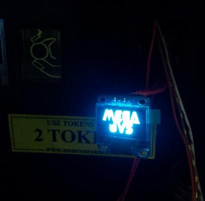

Look what just occurred to me! I know where the display is going.
is that monochromatic or are multiple colors available?
It's monochromatic. I'm not sure what the options are for colored displays this size. I know the library I'm using has support for colored displays, though.
I'd think for an application like this monochrome is sufficient. I would also think OLED would be superior to a TFT equivalent for clarity and viewing angle. I'm not sure on price for similar sized colored screens. For sure they're more than $10.
Edit: it looks like there are cheap colored OLED screens of the same size available on eBay from Hong Kong for about $12. They look like they require 7 wires instead of 4, so not sure what all they'd need for driving them with an Arduino. I don't need one for this project, but it's nice to know colored displays are out there.

Great! These screens seem to work fine mounted remotely over a few feet of un-shielded wire in this high EMI environment.
The only potential for issues now that the screen is incorporated is that it takes a little longer to change profiles. I'm still able to swap profiles in realtime, but it's important not to be spamming the profile button during JVS initialization or you can cause the communication to break down and fail that process which needs quick, uninterrupted replies.
