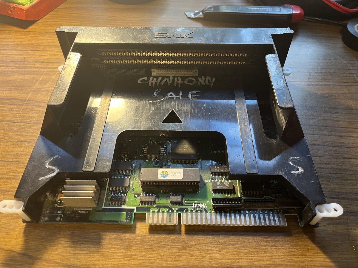

Thanks for the picture. Do you think that you can remove the 4 screws and show us the actual motherboard. I can only see the plastic shell.

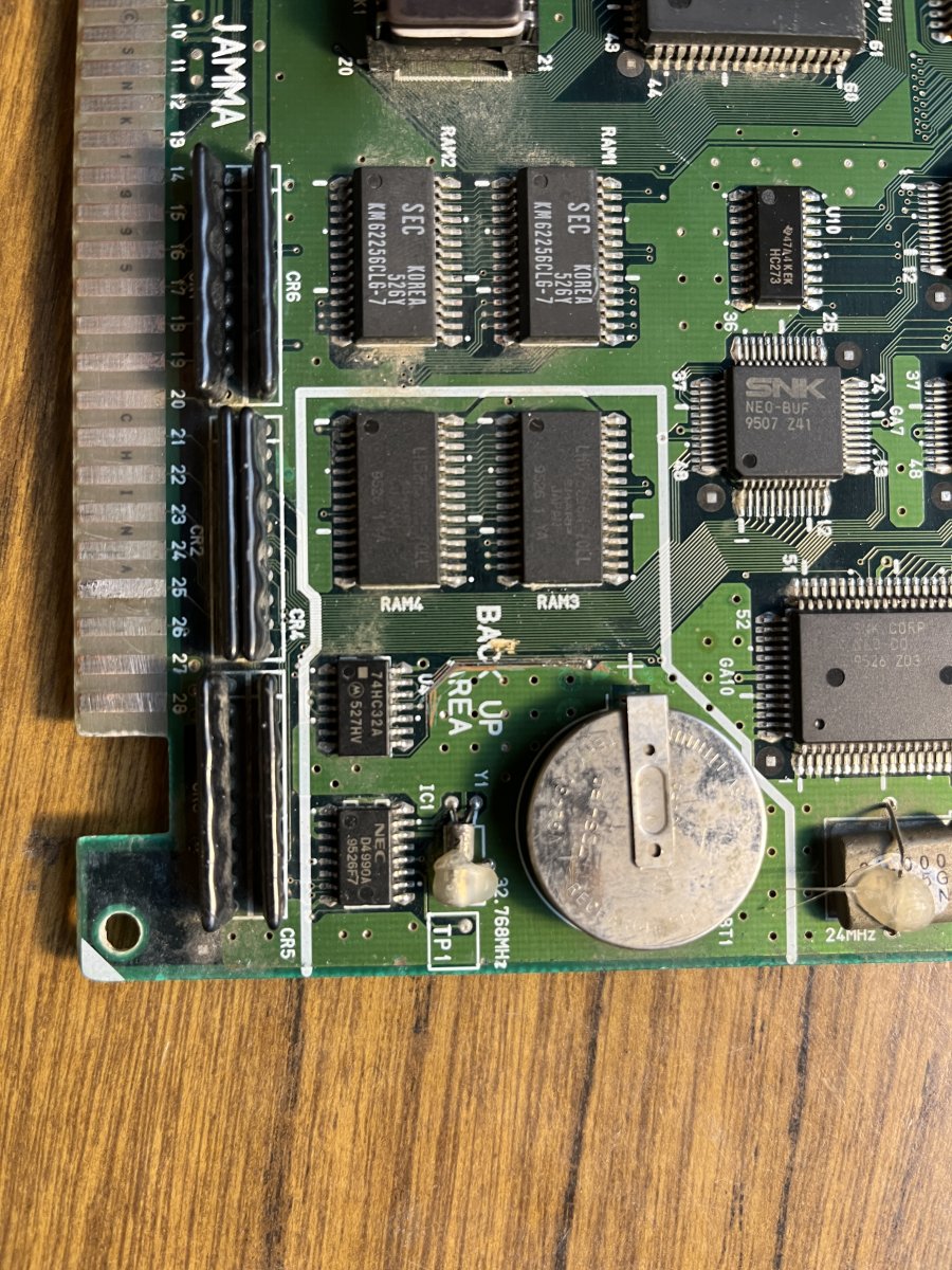

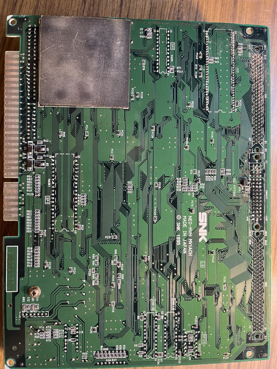

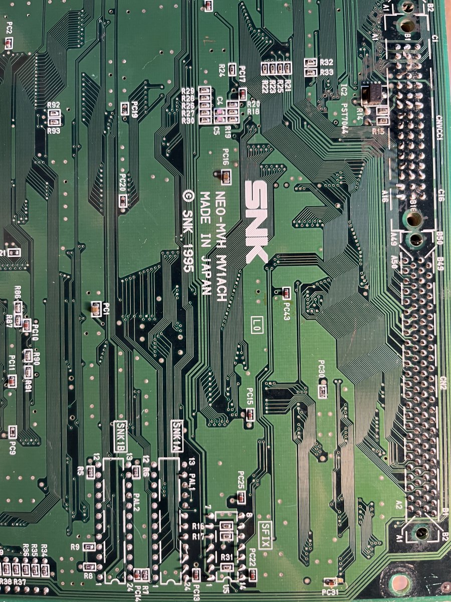

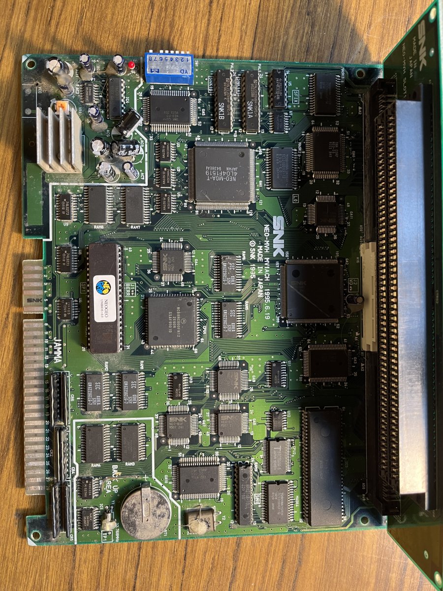

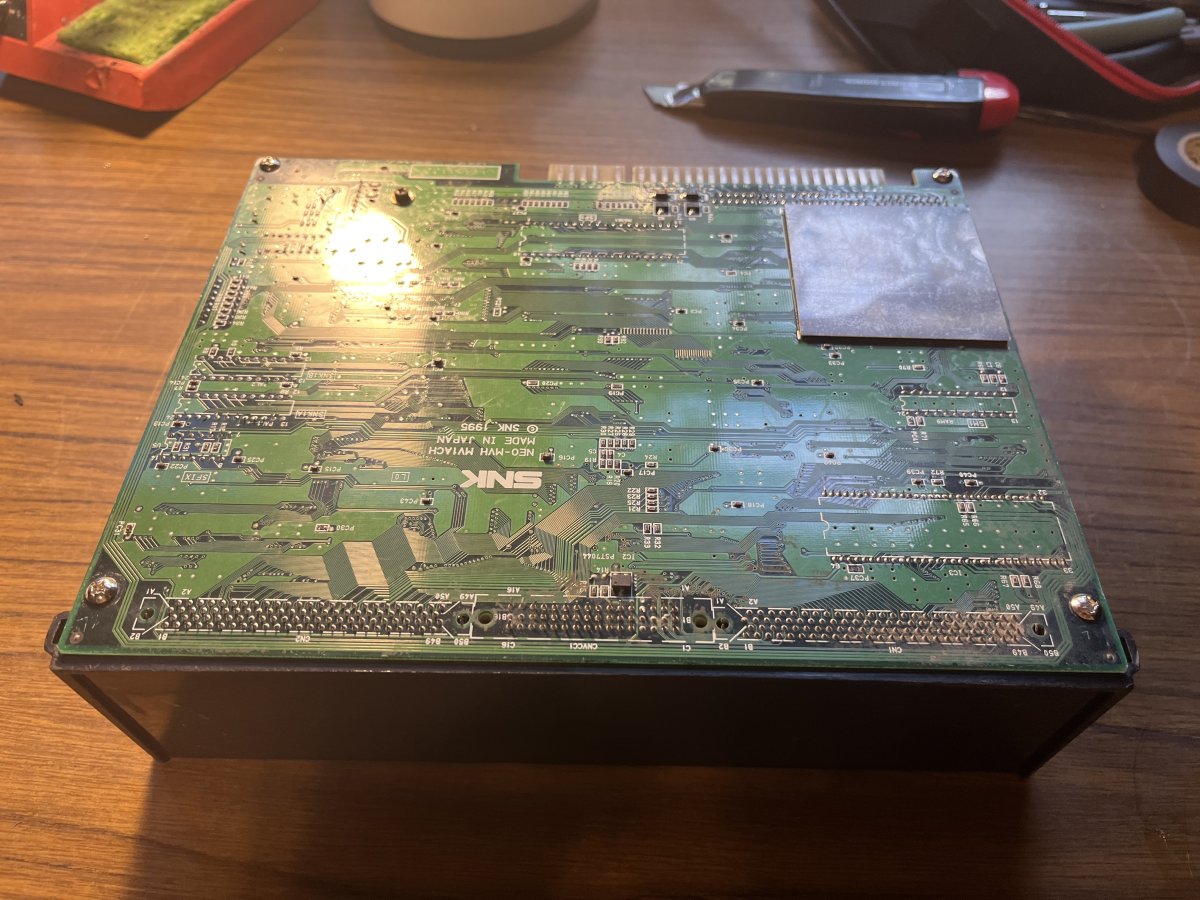

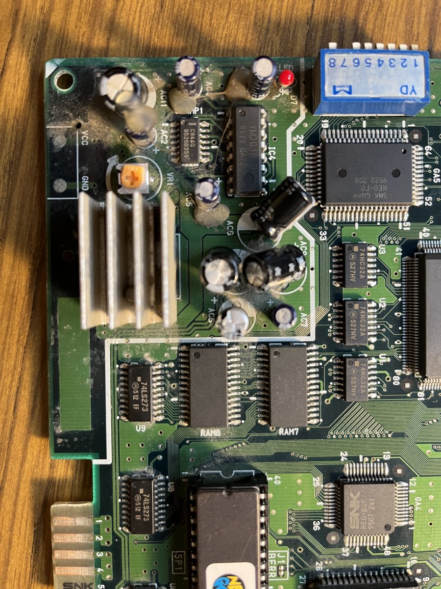

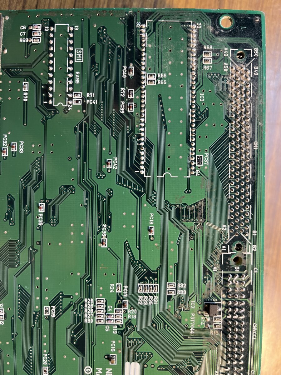

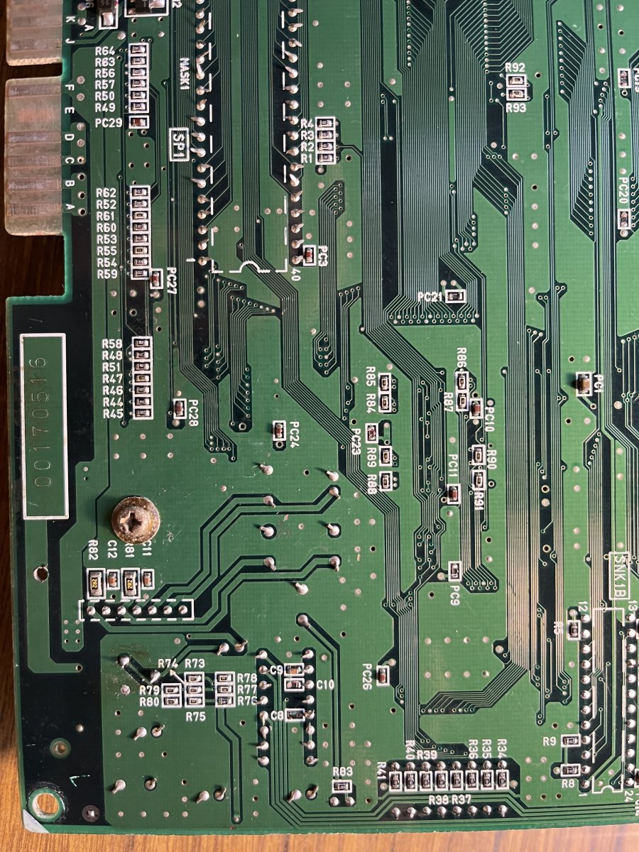

Bios didn’t change anything. I am potentially thinking maybe this is a motherboard problem not a cart problem as now I get no sound at all and even in bios testing the sound doesn’t play. There are also some missing components on the bottom of the board that could be suspect

I plan on doing a recap on the board anyways (cap kit on the way), and will use that time to inspect the board more thoroughly and will likely re-flow cart connectors while I am at it. If that doesn't work I will look into acquiring another mobo since I don't have access to another at this time.
Just wanted to provide an update on this, did a visual inspection, recap, re-flowed all connector pins for MV1FS, MVH and cartridge, no change in behavior with the MultiMVS cart. I will try to source another board like a MV1C to see if this resolves my issues.
