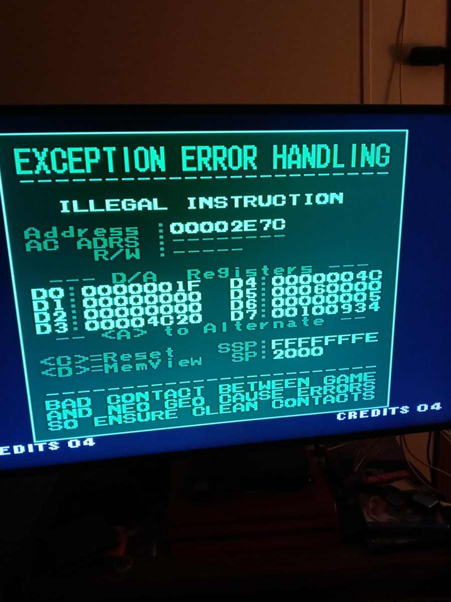

The private messages are lagging on my end but I have been having issues with games loading and restarting from a Sandisk Extreme as well. I am going to try to get a Samsung SD Card before I send anything in. I keep getting this error on most games.
