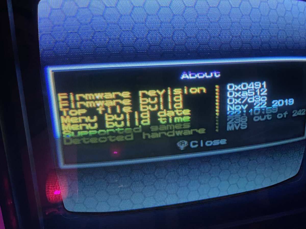

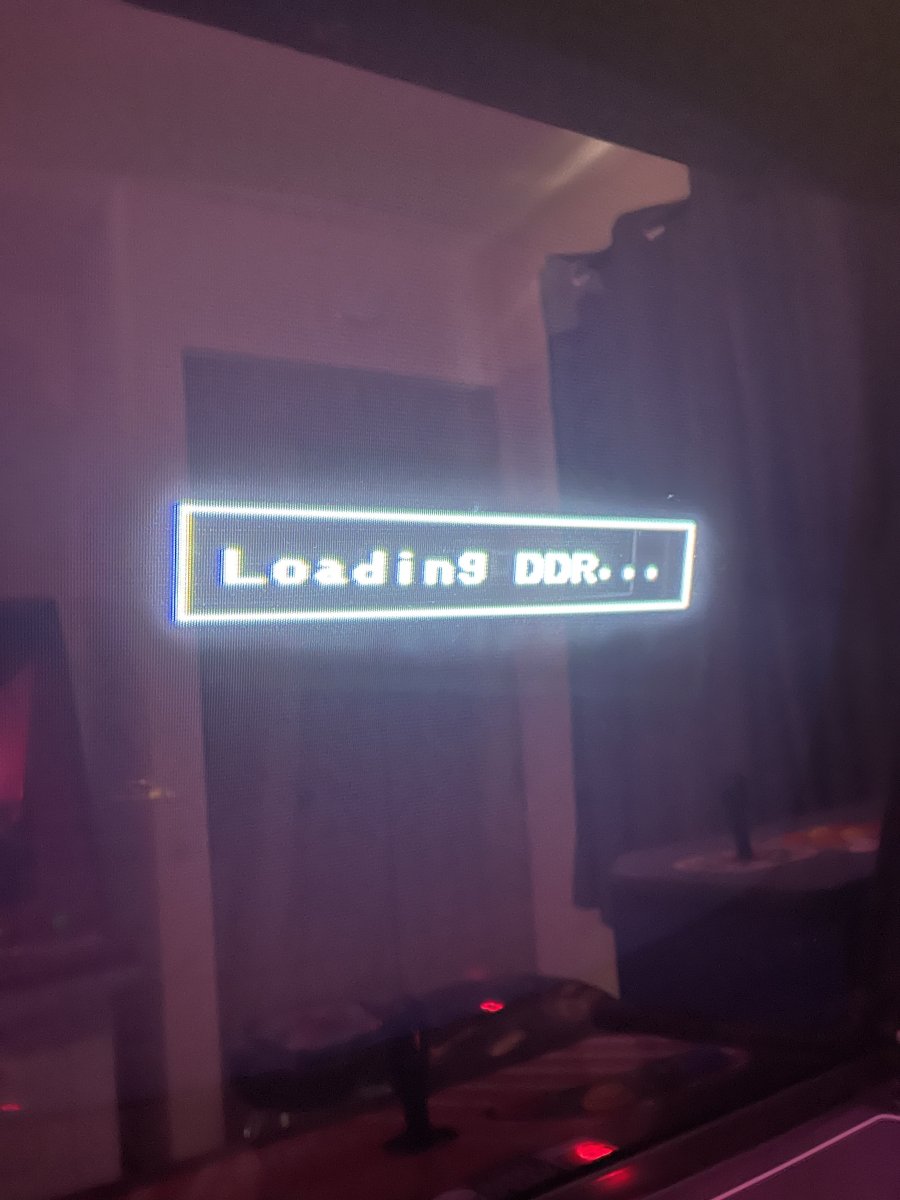

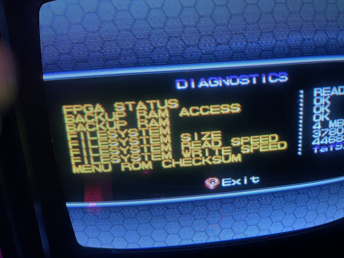

Yes, I checked it and tried ranges from 5 to 5.2 on the prior cart. There are different issues here between the two carts, the first just had the graphical glitches while the second hangs at loading. Now I kind of wish I'd just kept the first because I could live with the glitches but can't use this one at all.Well, two non working carts is little probably, specially because they are all checked before shipping. Can you please check the threads for troubleshooting? Specifically the first 2 posts in this thread and of course the instructions. To me it looks like a power issue. Did you check your 5V on the Jamma edge?
Ok, I can do those things and let you know.delete all files in the main directory of your microSD like REVISION or BUFF, SLOT, but leave the folders update and games as they are. See if that helps,
if not, just try to do a FW update and let us know how it goes.
So the issue was that there was something wrong with that SD card. When I put it into my computer it couldn't read it. I bought a new one and now it's workingdelete all files in the main directory of your microSD like REVISION or BUFF, SLOT, but leave the folders update and games as they are. See if that helps,
