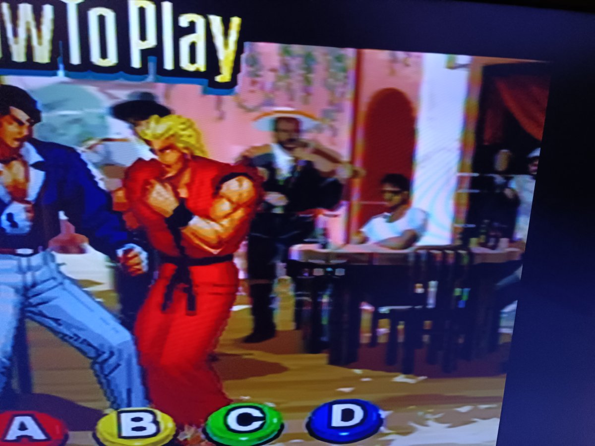

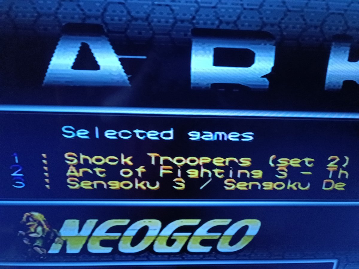

Hi, my cartridge came today. It's having some graphical issues where horizontal lines are flickering across the screen. You can see them on the Dark soft logo and in the background of AoF3 in the images below.

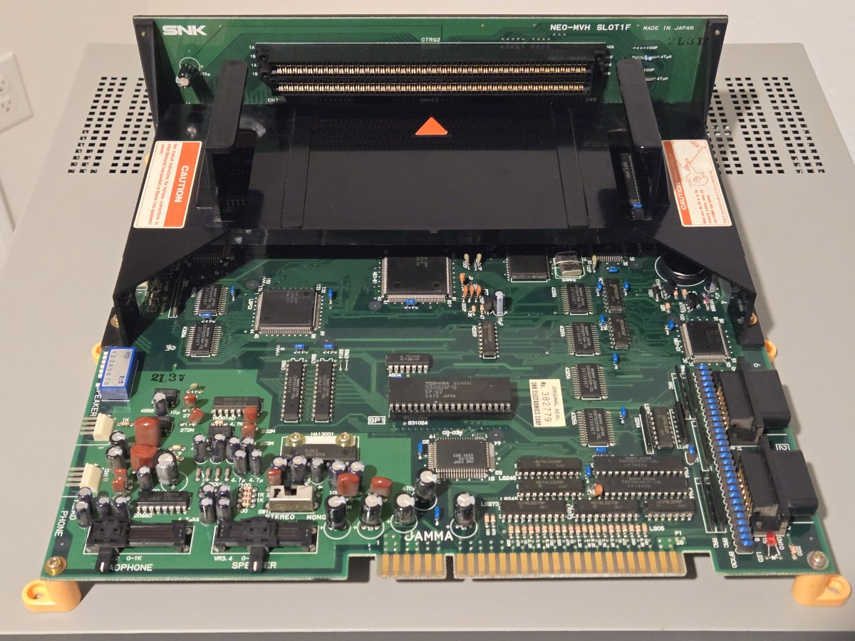

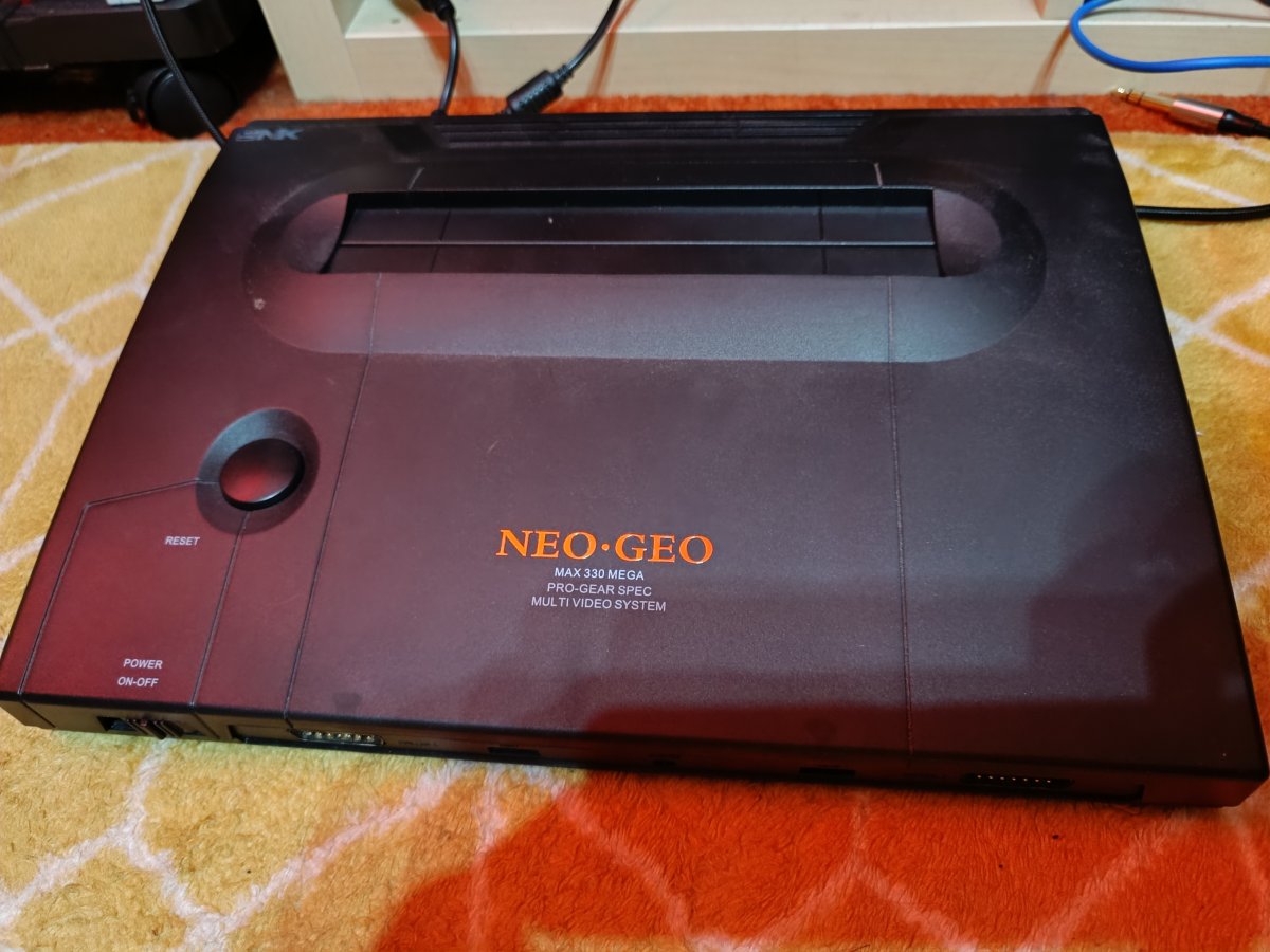

Consolized? Can you show some pictures of your NeoGeo setup? Including the PSU, please.
:unsure: What is that? Looks like an AES, not a MVS. What is actually inside an AES or a MVS motherboard? How do you insert the cartridge? Do you use a MVS to AES adapter?
Yeah, that is a bit far away in many ways from original Hardware. I would say that those glitches come from the PSU or some bad caps in the motherboard, sometimes a bad chip can have that effect too as it introduces noise in the PCB. Do you have another MVS motherboard where you can test it? Does it happen in all games?
Yeah, I can see they've changed quite a bit. I don't have another MVS at the minute to test but I have all of the Art of Fighting and Fatal Fury games and they work without any issues.

3. Minor glitching - I have seen, mostly in the menu, minor line glitches especially when scrolling. This may be expected behavior, I am not sure, voltage doesn't really seem to matter as much for this.

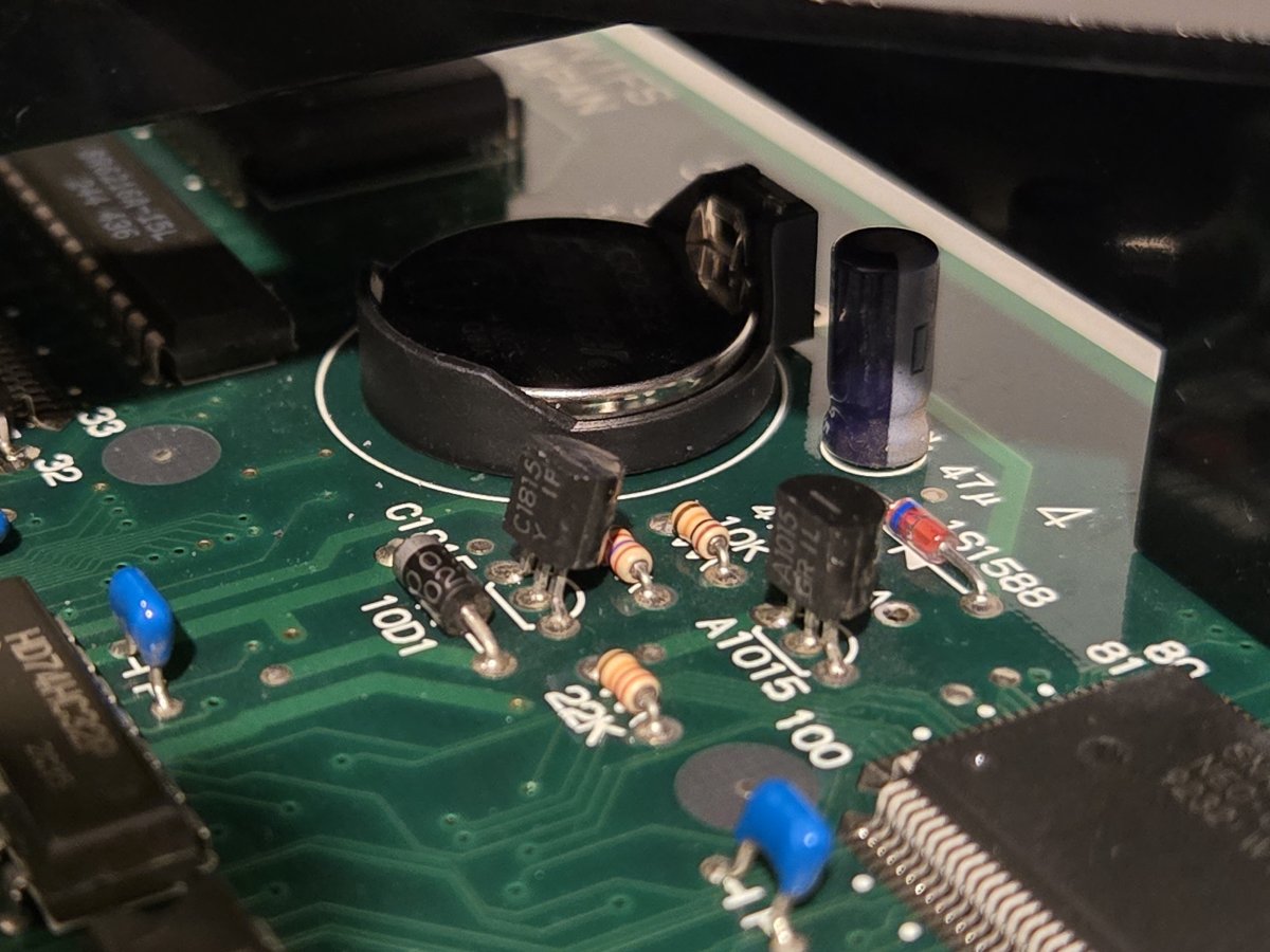

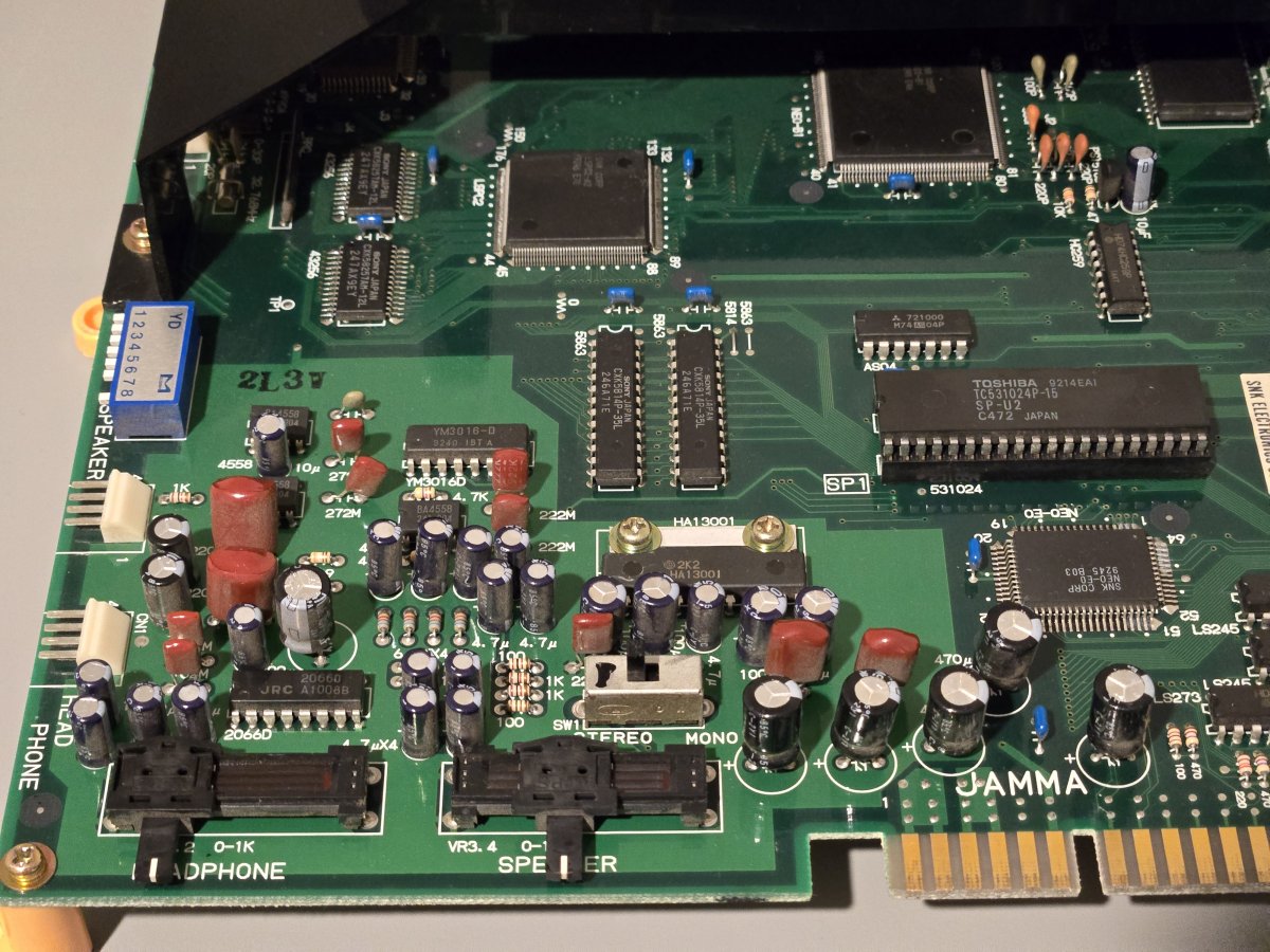

Can you post some pictures please.
Looking at it they have removed the Neo-Buf chip, could that be the issue?
Sure, if you need me to take more let me know, thanks
I don't see anthing out of the ordinary there. How do you power that Mobo?
