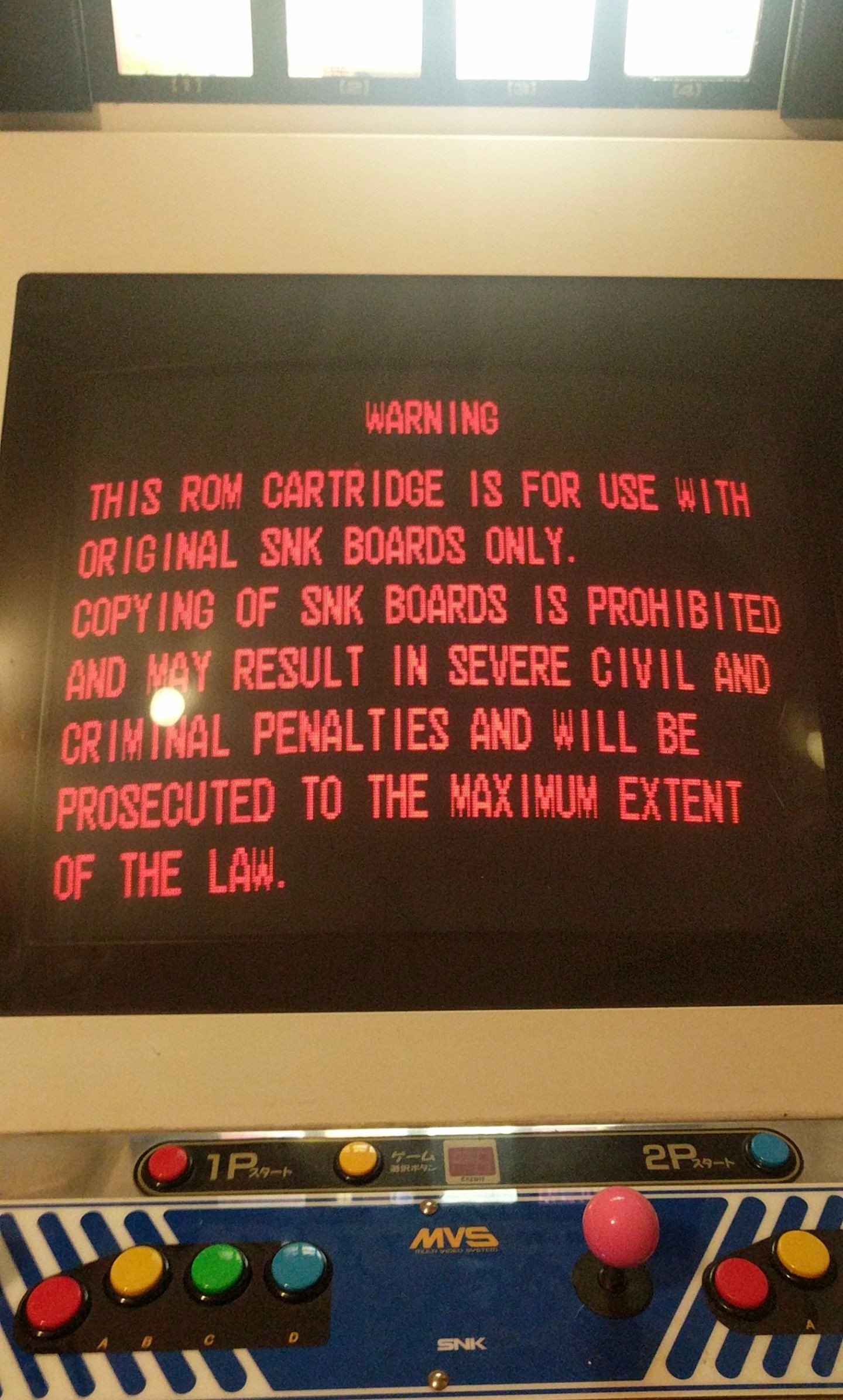

Metal Slug 4 doesn't seem to work.
Now it gives the error saying how it should only be run on legitimate SNK boards. Tried swapping regions, and that didn't do anything to resolve it. Not sure what else to try. Once that screen pops up you can't swap games any longer..
Formatted the card, put everything back in with the updates. Other games run fine, but not MS4 (tried all 3 slots).
Edit: Metal Slug 5 also does this.

Hey @rewrite - I think you are somehow stuck in AES mode - maybe clear NVRAM and try to get back into MVS mode? When I set mine to AES mode I could duplicate your MS4 and SSV:Special issues...
Yeah, turns out I too had gotten the October Menu mixed with the new firmware, and it sticks you in AES mode despite saying MVS.
Downloaded the 1129 menu and all is good now.
