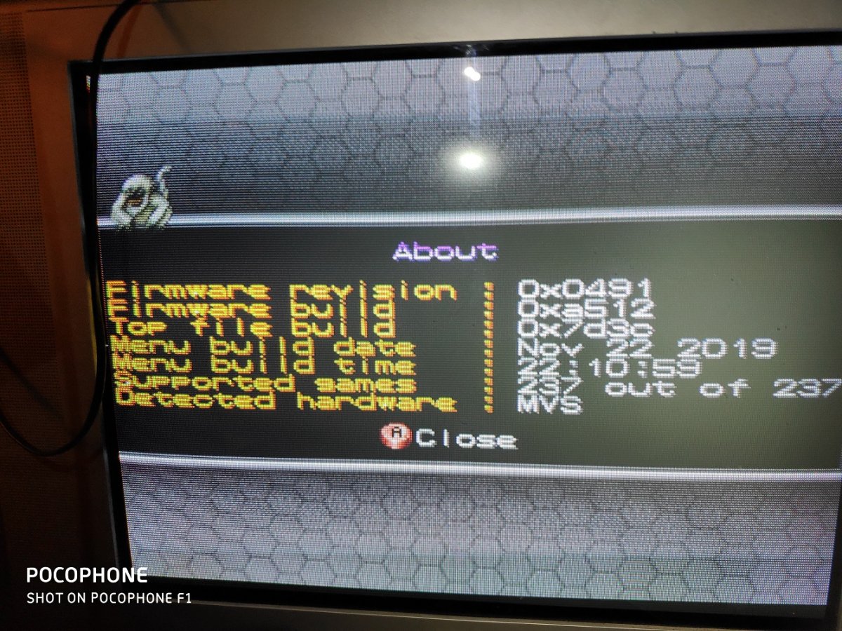

I've update with the latest firmware and it's worst now .
i use a sdhc samsung 32 evo

update like this ?
first flash, mvs on for update,mvs off, i remove sd card.
2 top , mvs on for update , then mvs off , remove sd card .
3 remove cartridge, mvs on clear up backup nvram. put cpld for update and mvs on.
menu was already the last one (22 nov 2019)
But always full of graphics glitches.
I don't understand.
Maybe the cartridge have an issue, no ?
