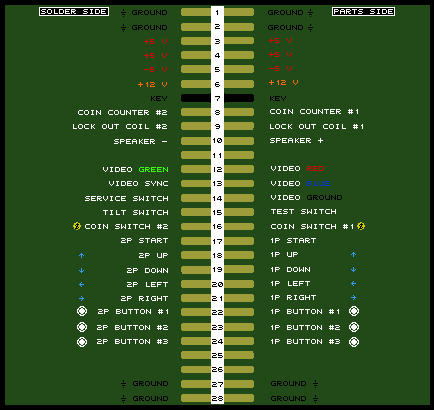

Thank you, this what I thought, there is a potard to adjust the voltage, on the side of the sigma av7000 supergun but I never touch it. Does anyone knows this supergun ? First I need a Jamma meter to know the actual voltage on the card.
Yes I have a multimeter but I don’t have a jamma meter. Where on the edge should I mesure the voltage ?
Between pin 1 and pin 3

I am back with my problem of gamewhich is restarting unexpectedly after intro or during playing. With my meter I could not mesure the voltage properly so I purchased a Jamma meter connector. And the voltage is at 5.11v after one hour 5.10v, is too low ? Or too high ? I noticed also when I just start to play The restart append less. There anyway some unplayable games like SVC and windjammer, when I strate to play it restart with the green screen the neo géo etc.,

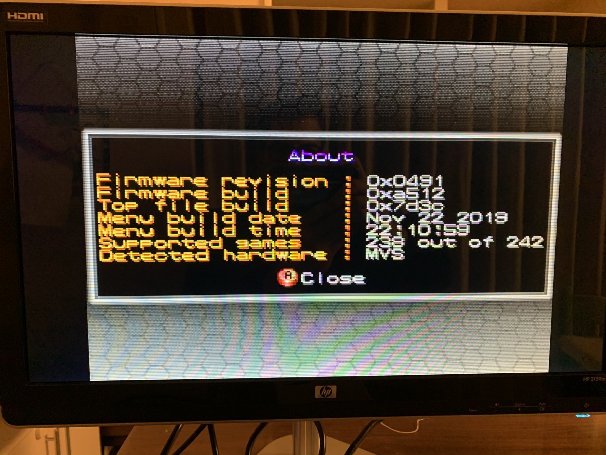

The multi MVS cart purchased, is from the last batch from December, from Save your game. I guess the last firmware is installed inside so I didn’t install anything and just add the games file at the root of the sd card.
