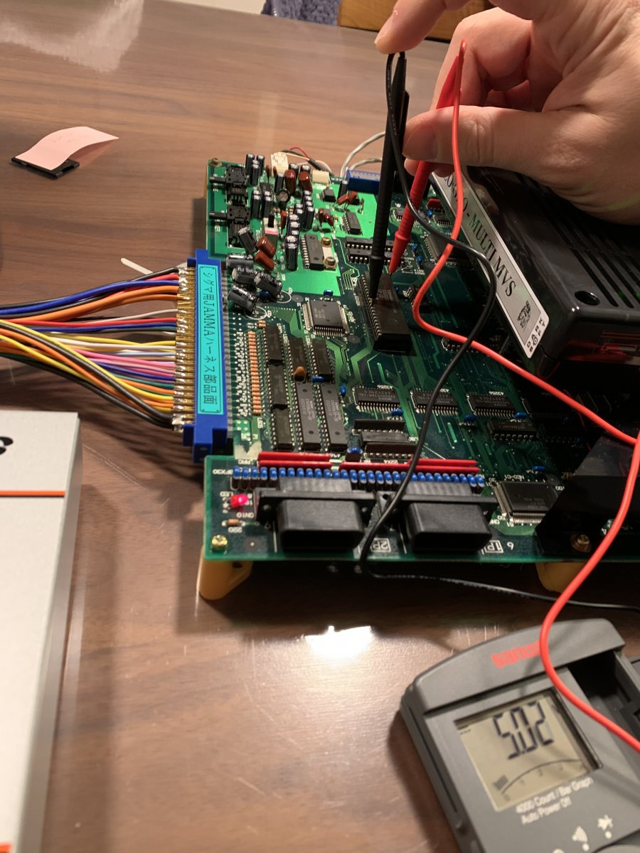

Hi everyone, I checked the voltage between pin 11 and 40 and I obtained 5.02 as you can see on the picture and when there is a random reboot of the game this value of 5.02 v doesn’t drop .
Is it possible that the problem comes from the cartridge ? How to confirm it ? I noticed that when I start on the first game loaded a previous day, there is no reboot even after hours.

At the jamma it was 5.03 and 5.02 at the sp1 bios (at pin 11 and pin 40 ). The battery was 1.36 v (system just switch on). 2.65 v after use for 1h . But sorry it was on the first MV1FS. I should mesure the battery voltage of the second MV1FS slot too. The second one has a button cell battery. Both slot were showing the same issue of random reboot. I didn’t change the SD card because I didn’t had any issue with the game loading only when the game was loaded and when the game starts and while playing. I got my multi MVS at the end of December 2020, our multis come from the same batch.

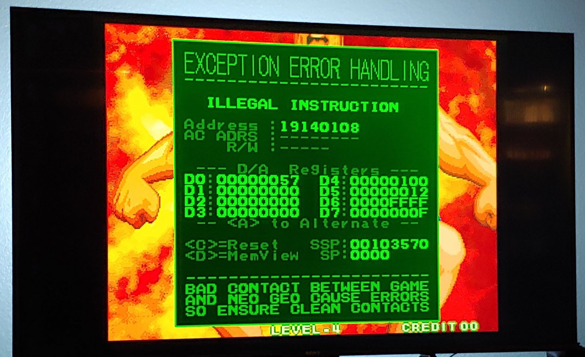

I attached a screenshot of when Super Dodgeball crashes. This happens immediately on the intro screen. Doesn't matter if I've had the system on for hours or if it is the first boot. If I add credits and start before the crash, I can play the game with no other crashes.
The battery voltage you have is low. Mine was below 1v so I swapped it out with a new coin cell battery like your second board.
It might not hurt to try a different SD card, just to see if anything changes.
*edit* Forgot to add the Super Dodgeball crash is a known issue in the Games with Issues thread. https://www.arcade-projects.com/threads/games-with-issues.5220/
Hi, when it crashes you obtained the « exception error » screen . If you use the original bios does it still crashes ?
It is not related but recently on MiSTer FPGA we had the same error with CPS1.5 cores games . The ram was faulty frequency problem. With original game, the slot works perfectly ? It is strange that only super dodge ball shows that error .
