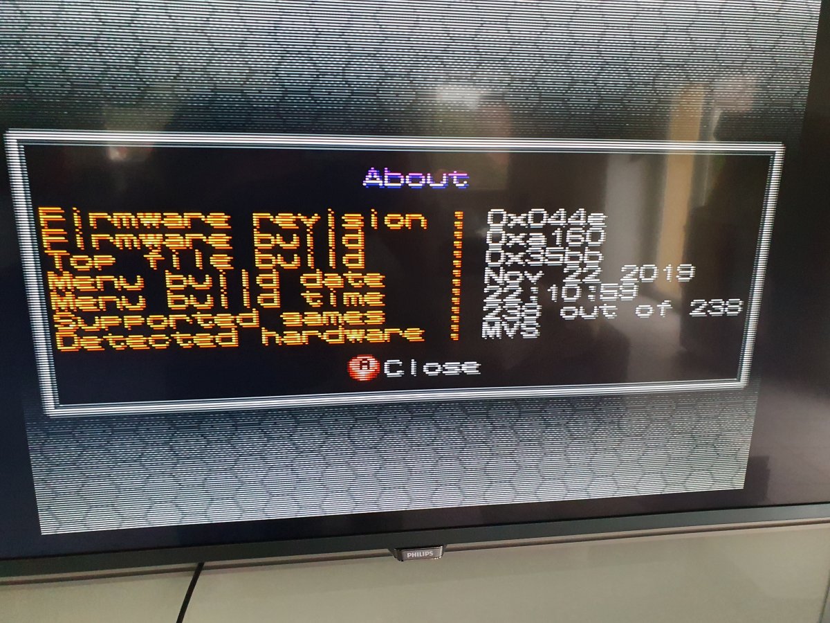

Hello everyone,
First I really want to thanks Darksoft for this great multi MVS and all people who contribute at this forum.(sorry for my poor english I'm french...)
I have sounds trouble (intro, how to and selection screen fighters work great but when the fight start all the the voices and sounds are played in one shot and after no sound) with the king of fighters 2003 who is in the roll pack that I found here. I have the multi MVS since 2 years and this is the first game that I found problem. I tried console mode or arcade mode, USA, japanese or Europe bios but sounds problem keep playing...
I use a mv1fz consolised slot, others games played work great. I have a 3.3 unibios.
My informations about Multimvs are on photos.
Thanks to all.
Looks like you dont have the latest version of the Firmware and top file. I'd recommend to update it, but I'm not sure if that's your problem. Have you tried with an original cart? Is it also happening there?
