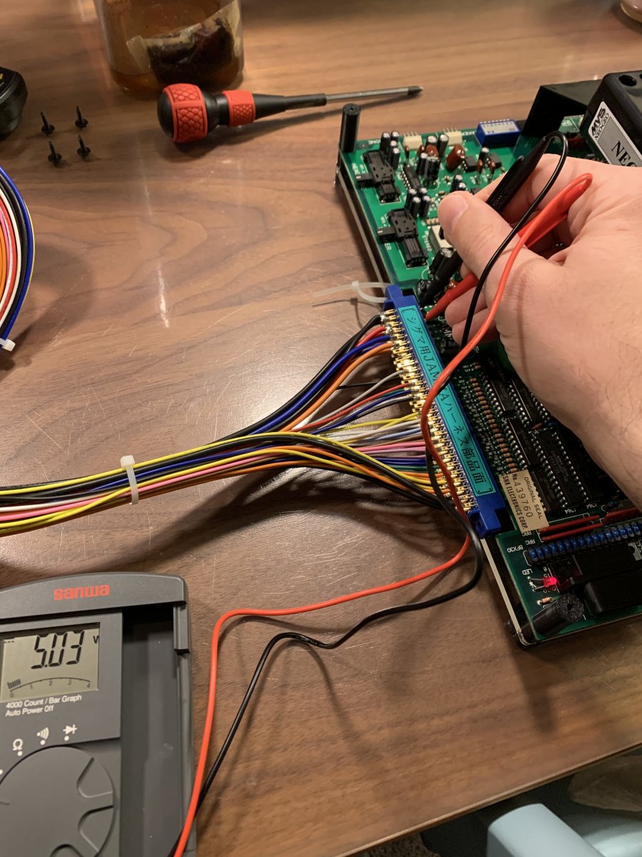

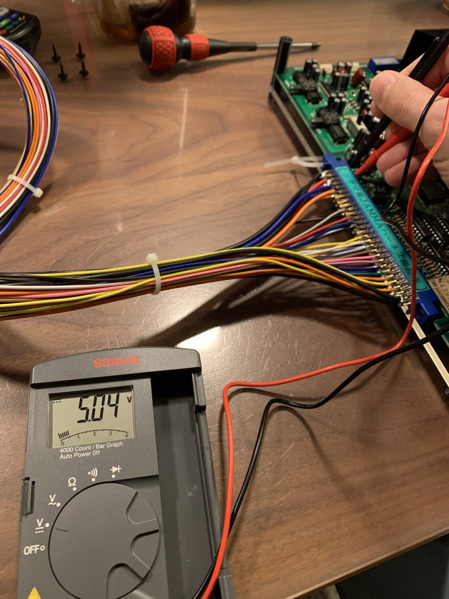

It’s fine. Use fresh batteries. Turn the wheel one click to V with the solid and dash lines (not ~). Black probe on negative, red on positive. Try on a simple battery first if you want.
with the system on, put the black probe on jamma pin 1 and the red on jamma pin 3.
Ok I first mesure the battery and it was 1.36v.
Then, system on, the jamma was at 5.03v (cf pictures). After playing, system off, the battery was at 2.65v (it decreases with the time).
