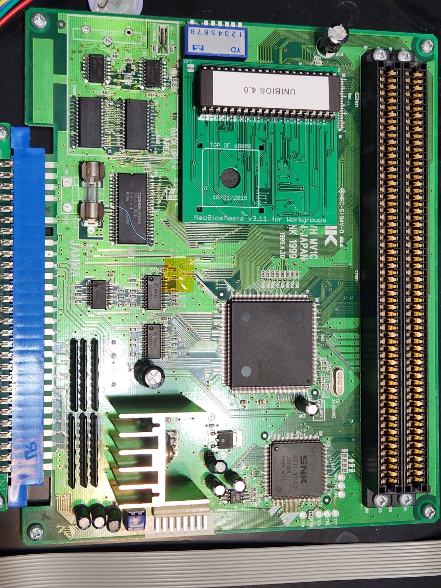

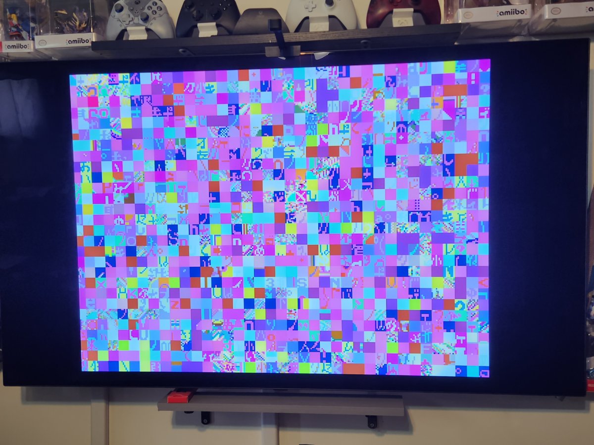

Good morning. I got my Darksoft MultiMvs. When I try playing on an Omega Mvs with NeoBios Masta and Neo Bios 4.0 the system just reboots and then get a green screen. I tried regular MVs carts and they play normal. Any help is appreciated.

I took off the Neogeo Masta and all I get is a square pink with purple screen

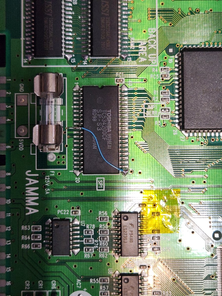

Installing the NeoGeo BIOSMasta requires disabling the original BIOS chip - that's what the blue patch wire running across the OG BIOS chip is doing.
In order to use the original SNK BIOS, you'll want to re-attach the BIOSMasta and swap out the UniBIOS EPROM chip that's plugged into the socket on top of the Masta. I can send you a suitable EPROM with the stock BIOS if you need one.
Regarding the green screen you get with the Darksoft MVS cart with the UniBIOS, is the file system set up correctly on the SD card? Post a screenshot of the directory structure please.

The cart was working very good for 2 weeks. I even did the update, and was working well. I have read that it might be the Masta coming loose at some point and that I have to use hot glue to maintain its contact.

Ah, if the cart was working fine before then definitely check your BIOSMasta fit and make sure the cart contacts are clean. It’s rare but SD cards can fail too, so maybe try another SD card too if need be.

Hey started working again. Made sure the Masta was inserted firmly and added hot glue to the center and sides of it to make sure it would not move. The Darksoft cart loads perfectly again. Thank you once again. 🙏
