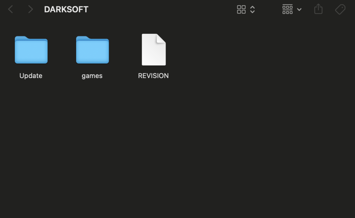

I have created a games folder and an update folder on the root. So once I place all the games into the games folder as instructed above I should be good? I got the red and white grid screen before. I have a 4 slot and all 4 slots work but when I place the multi in I get the grid screen or the slot is skipped.
The rollup pack should have everything you need. The root of the SD card should have the game and update folder in it. Inside the games folder should be individual folders fir each game.
Can you show a pic of your sd card root?

There’s no need to worry about the “update” folder for the moment. You just need the games and menu for the time being.
Can you show the contents of your /games folder as well as any sub directories under it?
Also what brand / size is your SD card. Also, what motheboard are you running.
The more info the better we can help.
Make sure you are using the rollup pack. The game roms need to be in the format in the rollup.
I'd use the 1 slot to set up your cart. Once your sd card is setup correctly (cart does nothing with an incorrect sd card) you will get a setting up filesystem message. Dont touch anything until it advances to the menu. It can take up to 5 minutes to complete.
Once your sd finishes being setup by the cart it will work much more similar to other flashcards you may be used to.
Also make sure your sd card sdhc and NOT sdxc. SDXC CARDS DO NOT WORK IN THIS CART.
