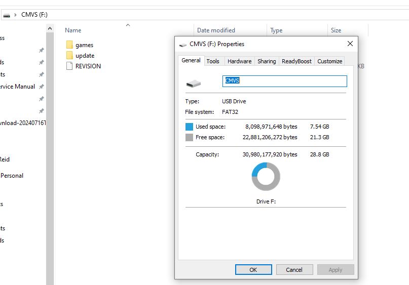

I am using the Tuxera" SD card formatter - the one on the SDcard.org Association website.
- properties of the SD card - showing the file system

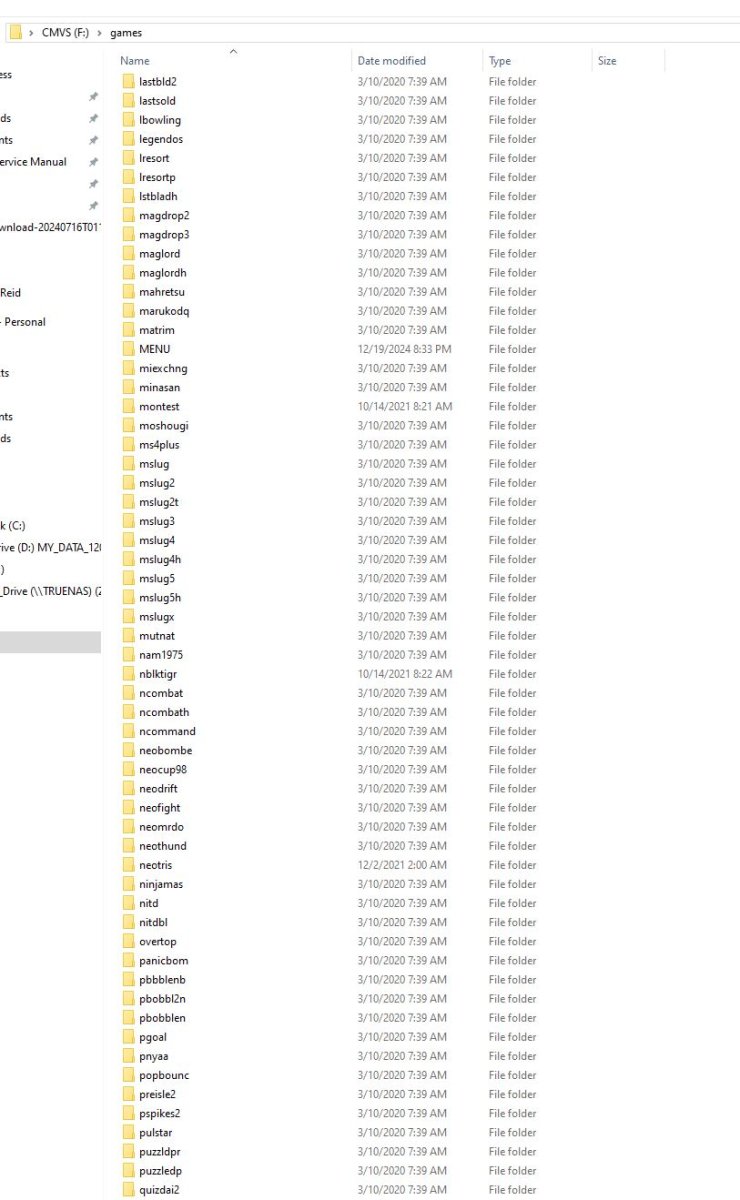

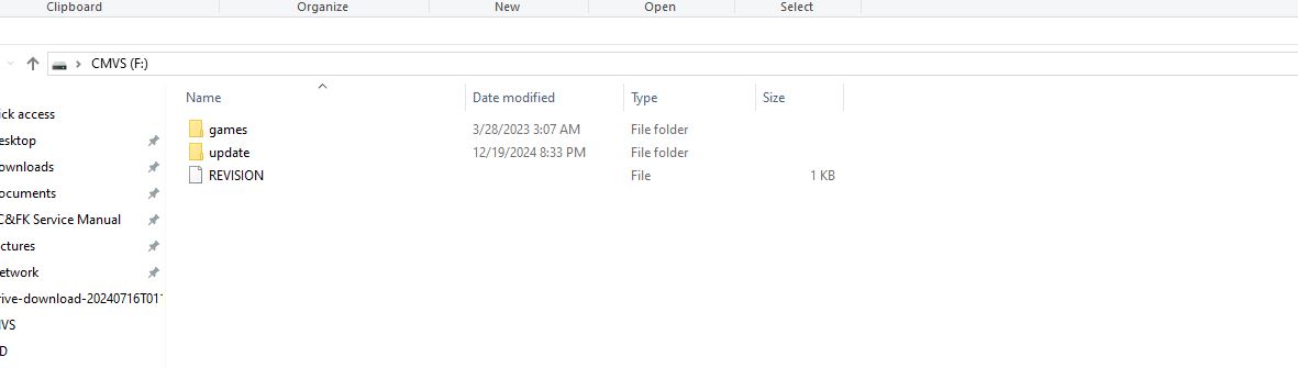

- Root of the SD cards - this is immediately after updating the firmware, then following update of the menu. The updates were performed sequentially and not at simultaneously. Both updates still result in cross hatch screen.
Root:
- example of the /games folder showing menu folder -

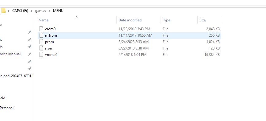

- contents of the menu folder

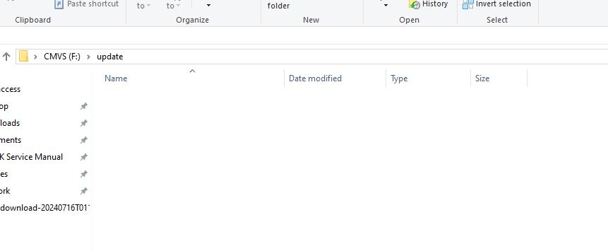

- contents of the update folder after all aforementioned updates (it is empty as expected)
Please let me know if there is anything further you'd like me to try or more information you need from me.
the directory structure looks solid. If it did a proper update and the files placed in the \update folder were deleted, that means that the microSD is read properly and the contents too. You are not using a microSD XC, are you? Multi only supports SDHC. Try to search for errors in the microSD from Windows. Right click and Tools, then check.
Can you show me the files that you copied in the \update folder as they are when you put them? Just for the info, you can delete, no need to make again an update.
