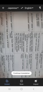

I have one aswell I'm trying to get running but looks like it may need to be connected to the all.net server to work

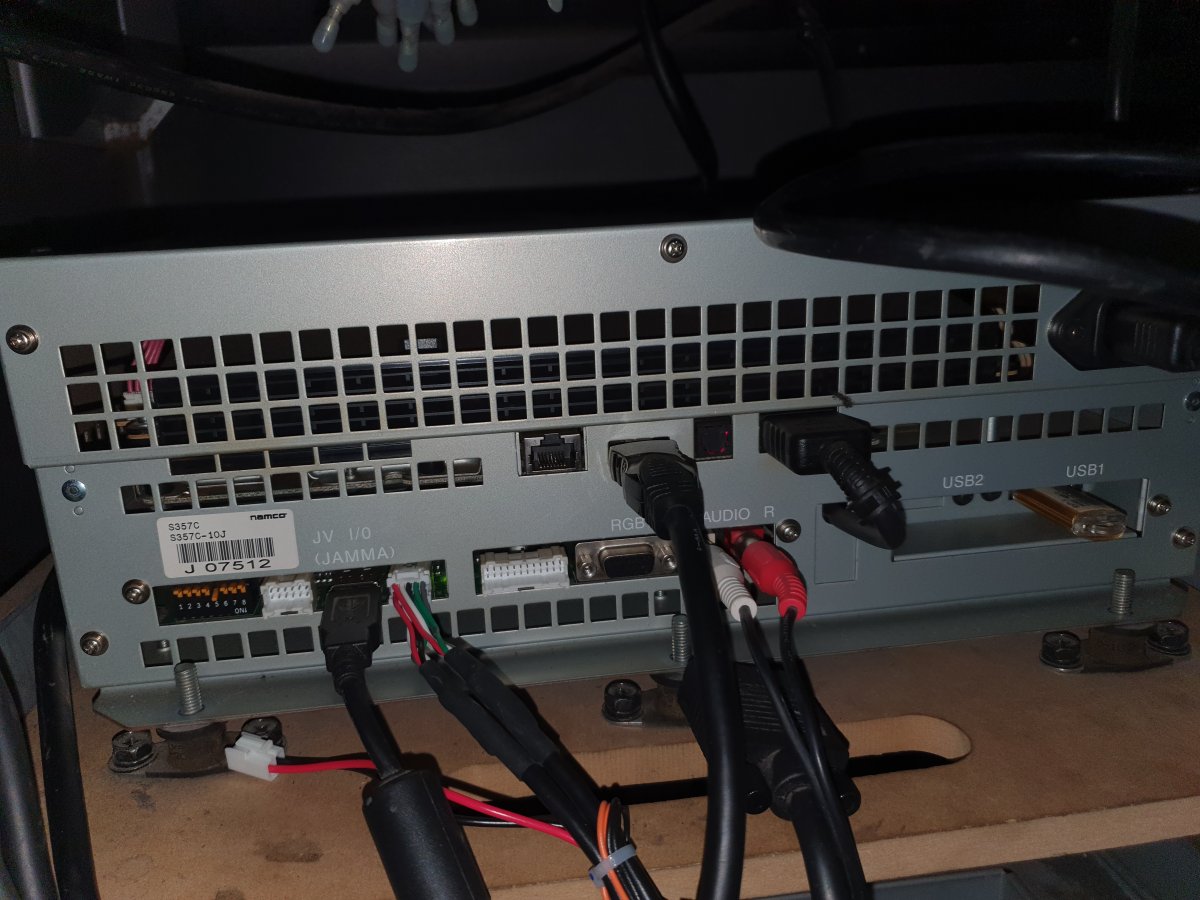

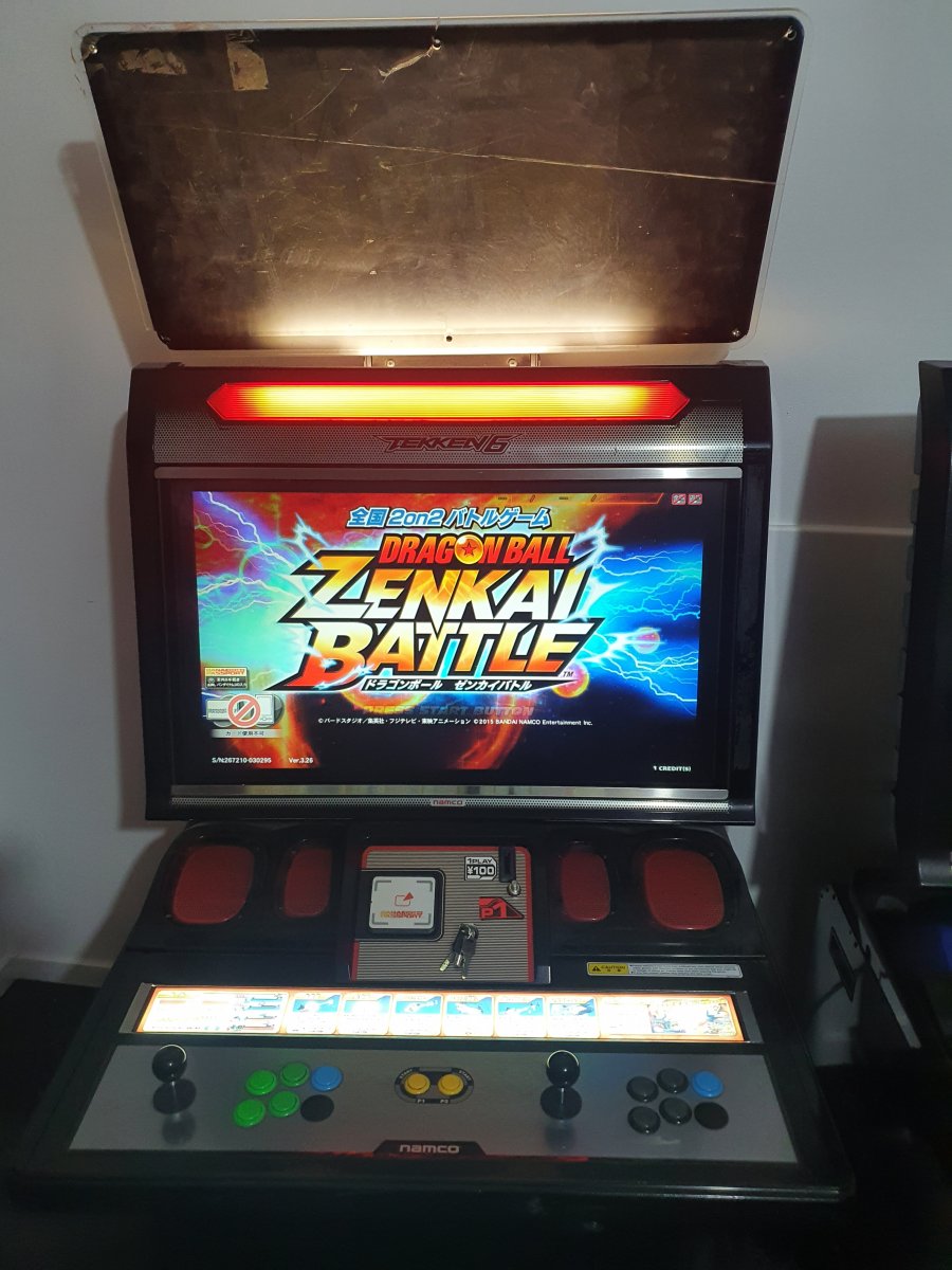

has anyone had any joy with this game yet, i've got the dedicated namco blanc but the game only runs in test mode like in the video.
Did you mean the story mode? In the video, Cereth played the story mode.
I don't have the cabinet. I got stuck during hardware checking screen because I can't press any button. I was using jvs io board but the system doesn't recognize it.
the system will recognise it , but you have to have dip 1 off and rest on , but it will only play in the game test mode

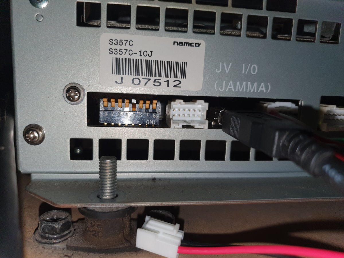

if you want to use jvs set your dipswitches to the following.
Thank you, I'll try this dip setting and the one from Tonybolony.
Do you know what that dip does, can’t find anything about which does what.
I don't. There's not much information about it on the Internet except 2nd dip is for enabling 31KHz.
