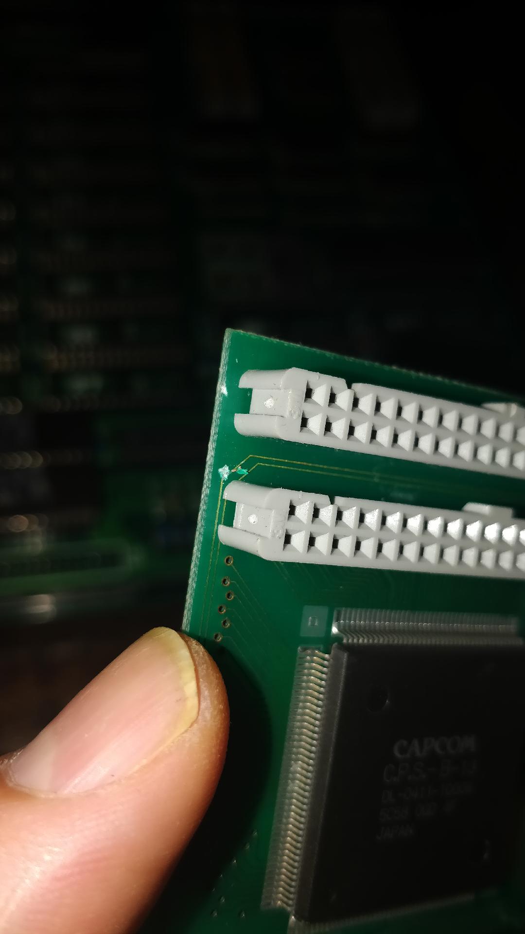

@xodaraP - I don't know how I missed this but took a closer look and my Magic Sword C board had a broken trace. Patched it and BOOM I have a working PCB now. Graphical issues went away.

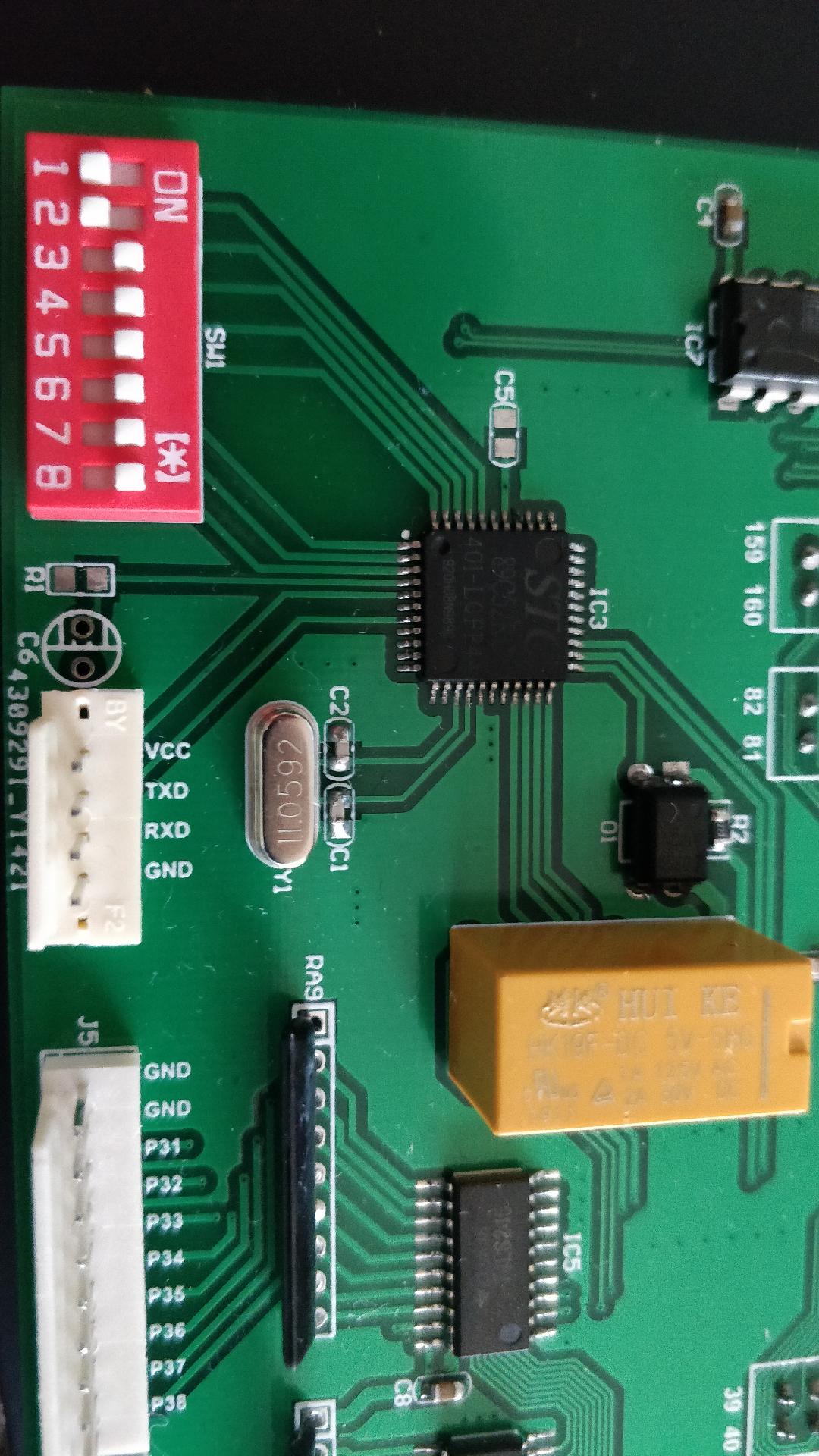

@lydz my PCB is definitely working now with the stock C board but I still get those weird blocked pixel graphics when I use your DIY board. I still need it because my other PCB has a failed C board that shows no obvious physical abuse.
See the attached pic. I have the settings as 00111 and I can't get it to behave like a B13. What am I doing wrong?

I still can't figure out how to make these work. @lydz would appreciate if you can confirm my screenshot above. Is that correct? Cuz it doesn't produce anything but garbled graphics for B13.
motherboard is fine. It works if I use the original C board. I actually fixed the original C board by repairing a broken trace.
Are my dip switches correct in the pic? I actually bought 2 boards off ya and neither works with those settings. So I'm hoping I have it configured wrong.

@lydz i took one more crack at this trying with multiple settings for what I assume is B13 could potentially be starting from right and left. Can you look at the pic I posted 3 messages prior and tell me exactly what I need to set the DIP switches to please. Not sure at this point what I can do further to get these to work..
