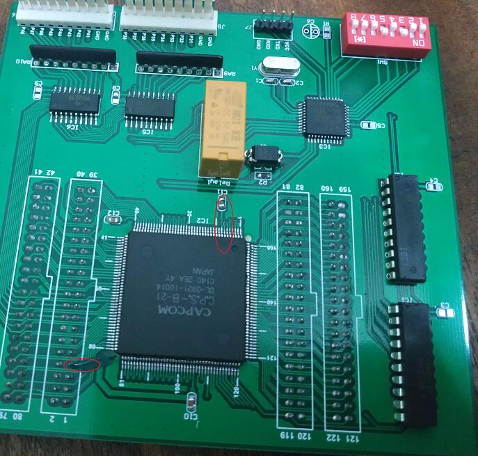

@-Ace- thanks for the picture, it helps me. If you have time, please try to turn off all switches. This game should also work in that state.
"It is possible you guys might have to burn these:
diy cps1 c boards b-xx"
This content is too short. We need the file that contains the entire hex content. Can anyone who has used a chip like this tell me how the data in it can be read? I found a program that I can write with but it can't read unfortunately.
@BlackLord if not secured you can read it with a programmer (but requires desoldering) or through the boot loader (RS232).

@Apocalypse I can remove the chip from the panel, no problem. I found this program that can program the chip.
Software
I have an rs232 interface. I don't know who can read the content in it.
Can you possibly recommend other software to try to read it?

You could try that program yes, but I'm expecting the chip to be secured.
B - xx in some ROM plate 89624 b / 89625 b appears on the screen problem, in this to make corrections.
PPU b-21 pin7 ---- dip2*20 ---pin7
