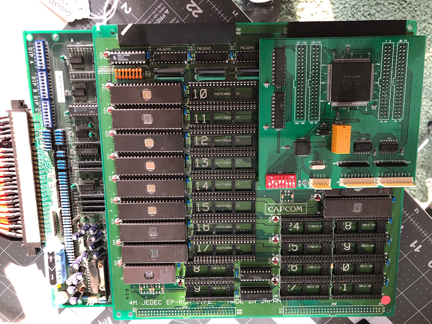

@BlackLord is it an optocoupler (left to the yellow thing) and a relay (big yellow thing) I see? :S
Could you please post hi-res pics (where components ref. would be legible)?
@Apocalypse
I have tried every possible dip position. I have several original cps1 games. There is one that contains a battery. Only one game started but the picture was very striped. Do you have any idea what can be done? I have two such panels. This is a mistake for both. I think lydz didn't test these enough before he started selling them. It would be nice if he could answer too. Maybe you could say something that would bring everyone closer to a solution.
@ApocalypseI tested a game that is b21 chip and does not contain a battery (original street fighter 2 - champion edition). All dip switches are off, working perfectly. I tried it on an SF2 - World Warrior game that contains a B-17 chip. I set the dip switches to the appropriate position based on the attached document. The result is just a striped image. Same result for the original Final Fight and Magic Sword, Three Wonders (battery included) games. Presumably the code is not loading or the code is incorrect.

@-Ace- Can you upload a picture of your motherboard?
Sure- it won't be until later tonight when I get home. I already tore up my SF2 WW (B-17), but I switched the dips on the C board to B-11 for this G-n-G conversion and the game worked fine.
