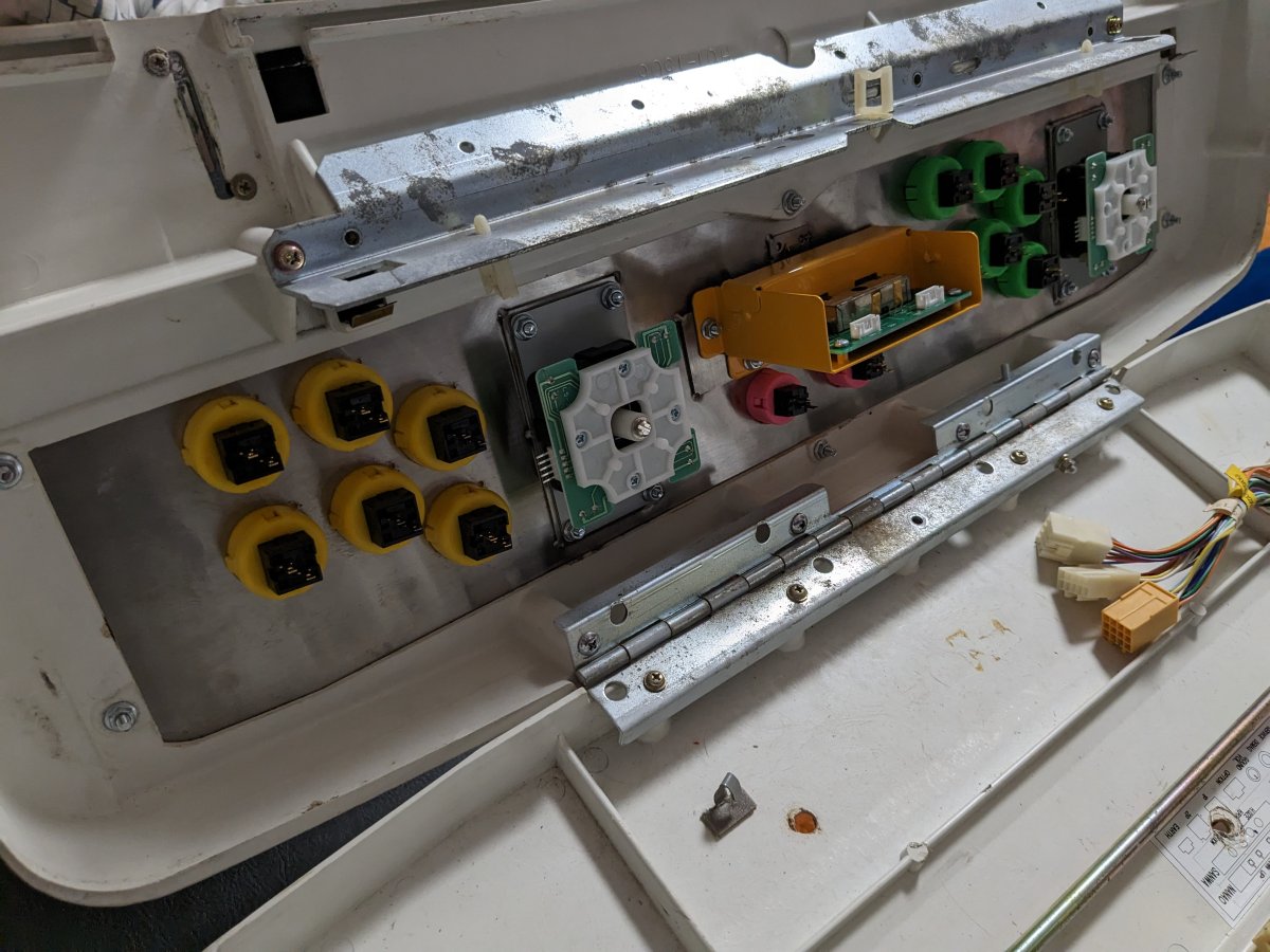

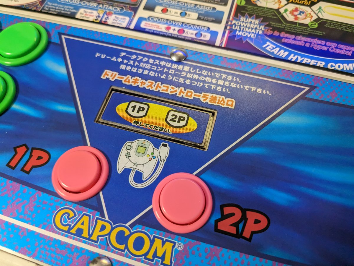

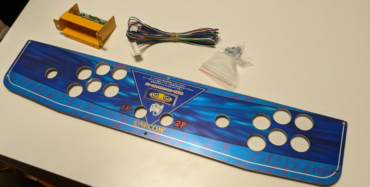

I got my panel today. Overall impressions are positive. The sheen for the overlay is really nice. It's not matte like a US panel, but it's not glossy either.
I have some nitpicks. I want to preface that I've never seen a real one in person, I am happy with it, and these are extreme details that I'm nitpicking.
The door is a little floppy.
My door in particular has what looks like a chunk missing (I assume it was a weld blow through).
The overlay wasn't lined up 100% perfectly.
It would be nice if the wiring harnesses were zip tied or sleeved.
The panel is unpainted and it looks the the original is powder coated white.
It doesn't have the little tabs that hook the panel into the cabinet.
Joystick mounting studs are for an MS plate. The original was for an SE plate. (I also think a lot of people are going to incorrectly flush mount a JLF to it.)
Joystick studs are mounted to a plate that's welded to the panel, causing the stick to be mounted 1-2mm lower.

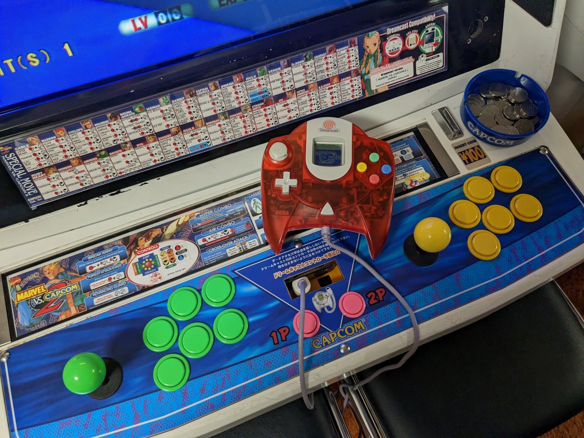

I went with Seimitsu parts because almost all of my other panels are Sanwa and I wanted to try something different. I like the LS-56 but I feel like their buttons are worse than they used to be.
