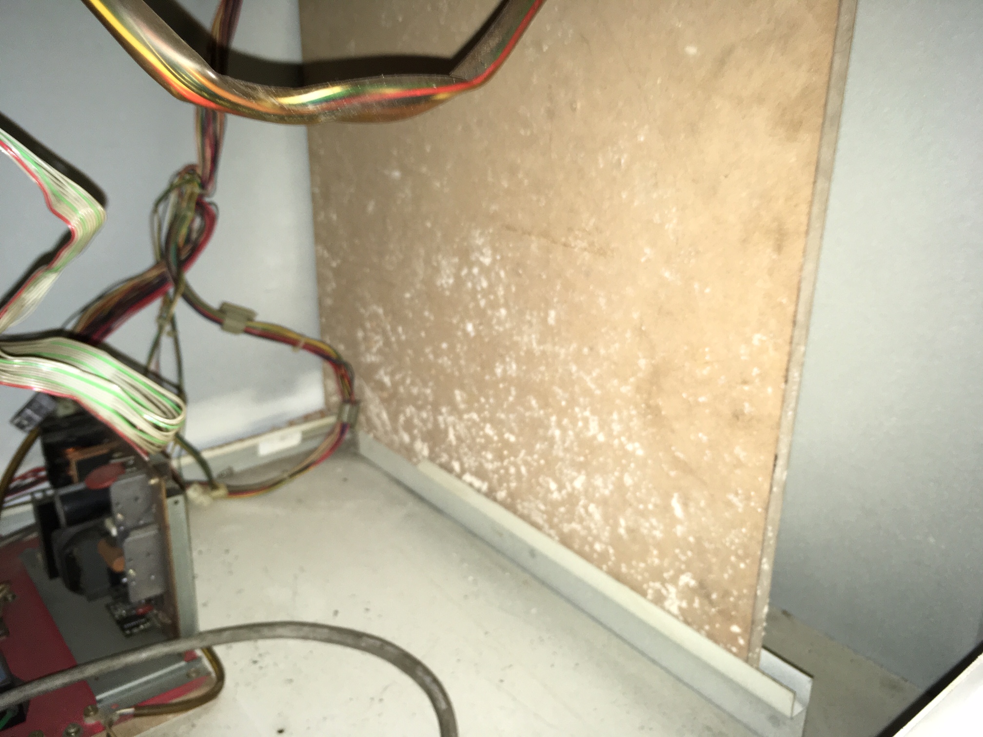

the monitor powers up, it’s the PSU putting 0.1V on the 5V rail. Once I get the death mold out of here I’ll get the new PSU in.

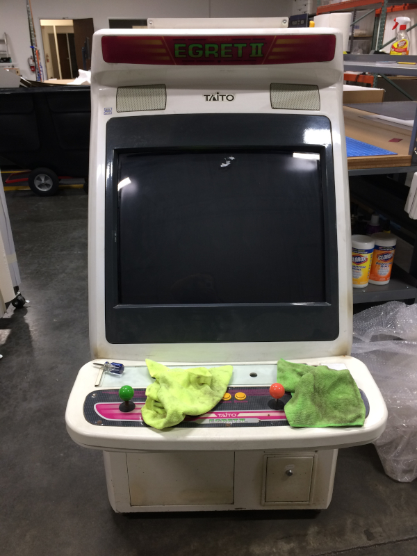

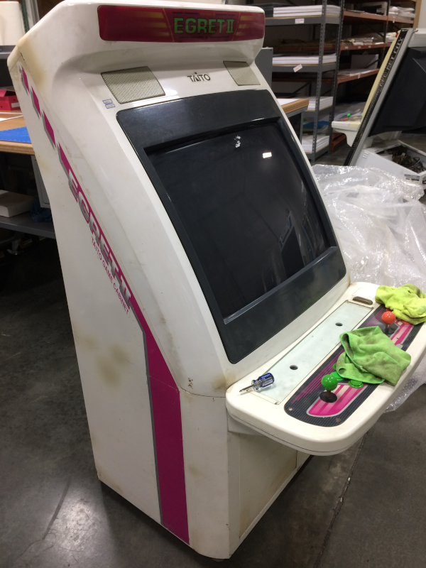

And here is my E2:

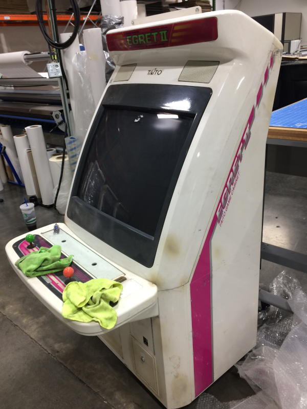

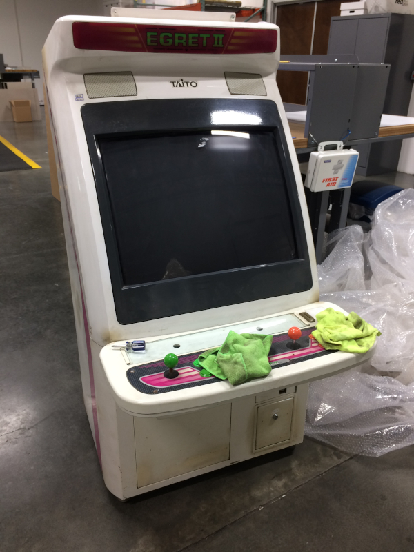

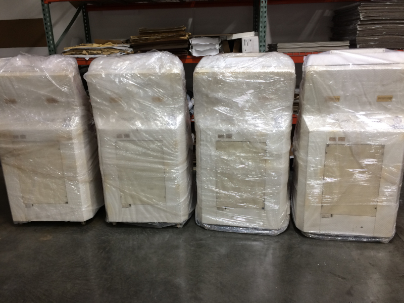

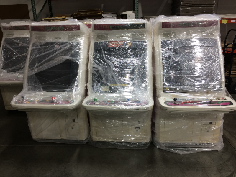

And here is some of the rest of the others. They all have the same pecadillo hatsune mike mentioned (touched up with spray paint which turned yellow).

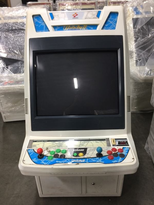

And here is the Windy II that is going to my buddy that lent us the processing site:

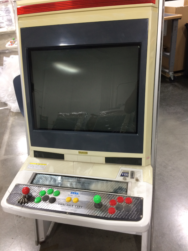

And here is the NNC I am ending up with (swapped with my buddy for as he really wanted the Windy II and we were shorted a Windy II by Yaton).

  • 8x - New Net City's: Very Good
    • The monitor shrouds on all of them were yellow which is inevitable given this much time since they rolled off the assembly line. Aside from that, they all looked very good consistently across all the cabs. All the cabs have 2P/6B per player. The only problem I could see is that it is a rat's nest back there. XeD posted a photo earlier.
  • 9x Windy City II's - Good
    • All exhibited yellowing on the monitor shrouds in spots. Not as consistent in terms of the imperfections as the NNC's.
  • 15x - Egret II's - Fair
    • And here is the bad news. None of these are in good shape. Even through the shrink/bubble wrap, they all show signs of having been touched up (see pics). Of course, the touch-up spots then yellow quickly. The good news is that the monitors do look pretty good. As these were last off the container, we were able to position them in the sun to illuminate burn on the tubes. We didn't see much or any through the wrap. Then the clouds covered the sun. All had 2P panels, some of the Astro City layout through button 4, and some with the 4 button Neo Geo style layout.

And the mold scares me considering the Q25 is 50% wood...

. On the topic of necking tubes, to the people getting windy cabs be extremely cautious. You will not be rotating this monitor often. If you want to do it plan on keeping it that way for a very long time. there is no frame around the tube, there is just a very narrow hole into the plastic frame where the neck board and neck go. I recommend laying the cab on its back and disassembling the brackets that hold up the bezel and having a friend to help. If you do end up necking it, good luck finding a replacement tube and retrofitting another monitor tube well require cutting a lot of plastic more than likely.
What's the point of a rotate mech if you have to have to disassembly the bezel, lay the cab on it's back, and have a friend help... by that metric every cab has a "rotate mech" because that's the process for rotating in anything else.
at that point I'd rather not even have it, at least in a normal cab there's a frame that protects the neck.
I was only talking about the windy, it does not have a rotate mech. The monitor is just a tube with the neck board, no frame at all
