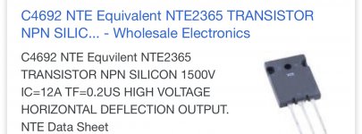

How do I identify which transistor is the HOT? I was told it's "closest to the flyback" but there are three equidistant from it...
Is that Q603?
I have D1910, NTE2302 equivalent there. Which tested bad.
This one!

Well, the other one tested bad anyway. So... Ha.
