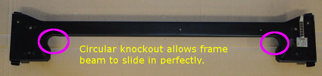

My LED lamp seems to be fine with the 100v step down. I screwed the old brackets right into the case, and added some bolts to the inside. Seems stable. Very happy with it! $15 on sale at home depot. (Don't mind the tape on the sides of the marquee...)
After trying three different fluorescent bulbs and a replacement starter, I finally gave up on my original ballast. It's too warped/loose and impossible to get the pins to seat right on both sides.
So I decided to follow @ekorz lead and got the same LED strip from Home Depot. Installation was a breeze with moving the brackets over from the original ballast.
Going to zip tie the cables down neatly like the speaker wires are done stock. It's great to finally see the illumination panel lit up! :thumbsup:
