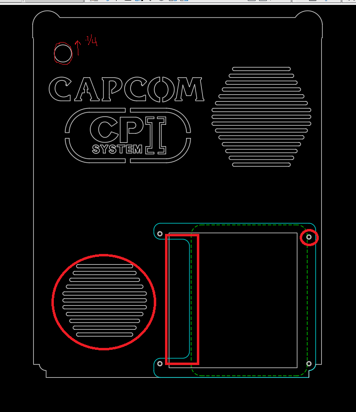

Ok , whats new !
i post a picture with new little changes.
-new air vent : because i know that some B-board may have more chips in that section... i can't really know if it will heat or not so prefer to not take any chances...
and besides, it won't hurt to have a little more.
-Volume hole has been better centered. It should be *mostly* centered but i can't make a new model, but based on mine it should not be far from perfect.
-Added one more insert for front panel...because it looked weird. having 3 and one side without one. it will also be more solid.
-Made the connectors holes on front panel bigger... i not sure if you guys need more space for unplugging connectors for players3-4..
i was think they were a little too close so i decided to get the hole a little more bigger just in case.
-Stickers (green line) will be a smaller (just a little) to fit with new hole and will have round edge.
-Screws on both front and side panel will be changed to round head (ill try to get black ones) since i can't get any from a shortage from my supplier.
I guess it will look better...having counter sunk was making holes bigger and it was reaching the labels... i think it will look better.

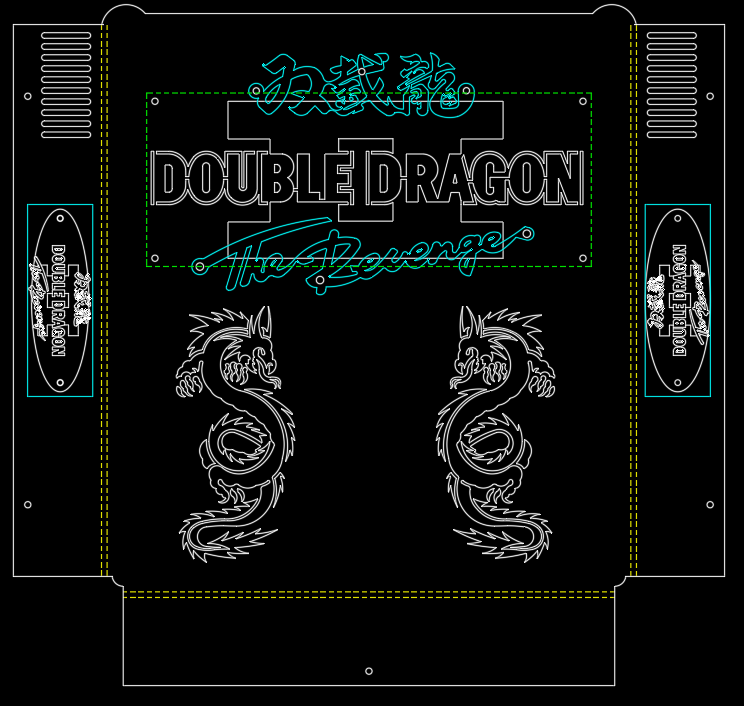

while i finish things up here with cps1 cases order final details,
ill try a new proto along the other cases

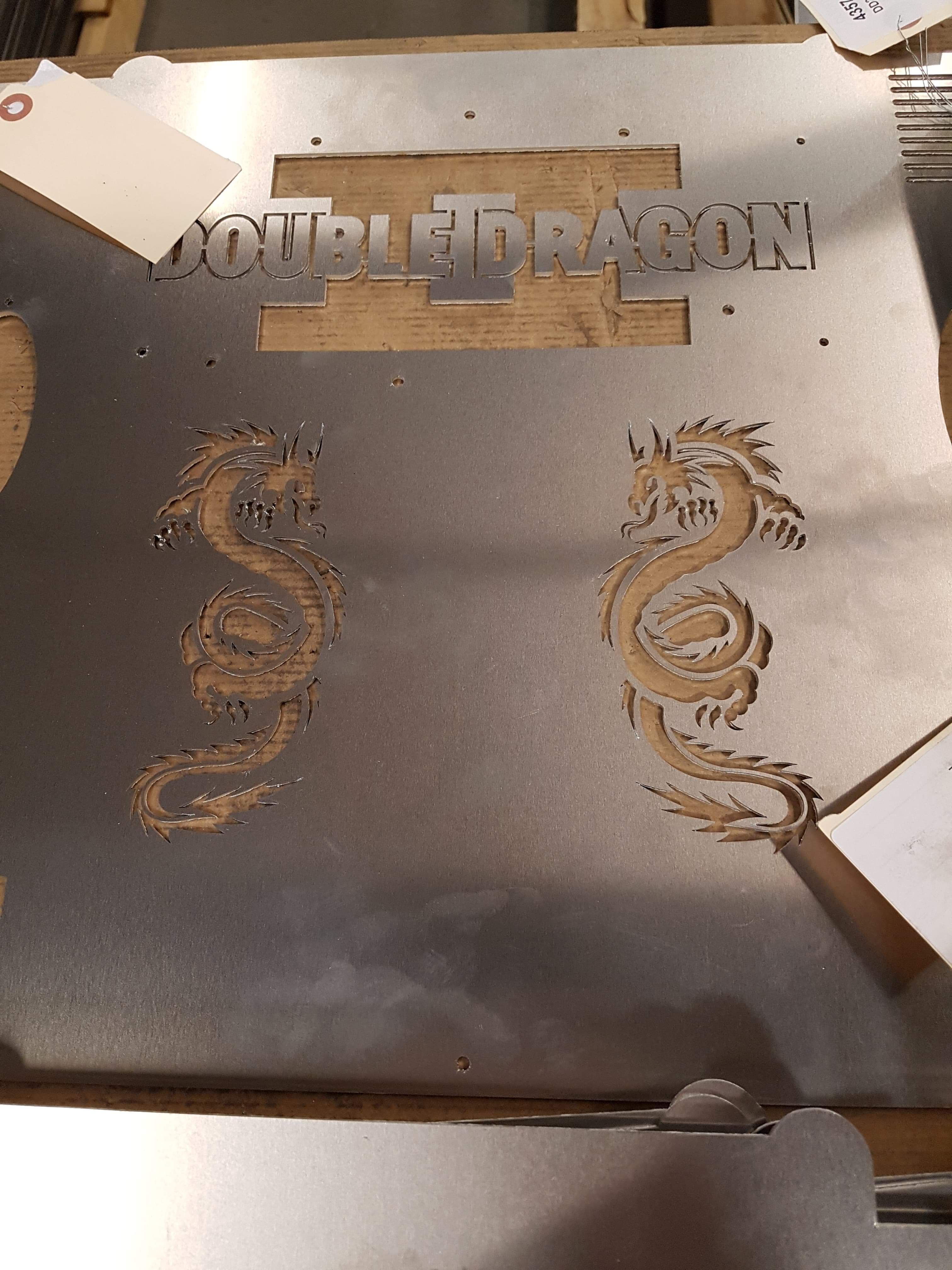

here's what might be the final product on Double Dragon 2 case.
japan text and revenge will be on top, (orange for japanese test and red for revenge)
everything will be laser cut (color blue like astérix if possible)
the big number 2 will have a plate underneath wich will be painted yellow the color will spead all around the
double dragon logo.
will it look beautifull ? hmm can't say...ill check for a lighter blue if i can.
(and a double dragon II logo on sides)

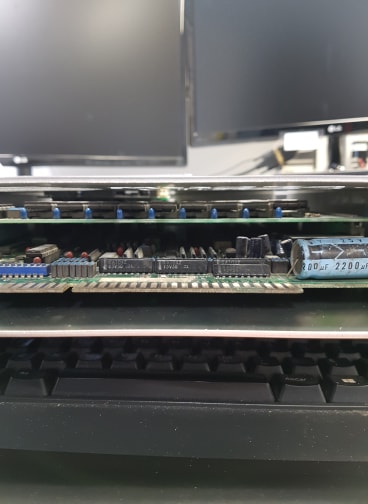

if you put case on vertical, the jamma plug would be on top.
distance from pcb to the base (after installing plastic disks) is approx .500"
here's an old picture from previous tests.

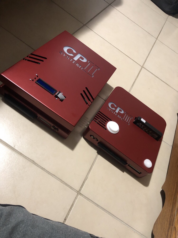

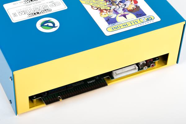

Thanks! Anyway we can enclose the ends a little more? Something like these CPS2 cases?
for now i can'T do that.
i was aiming at making all cases like that.
Having a full side open really helps evacuating all that heat IMO.
(especially sexy parodius)
I could in the futur make 2 more bendings to close up that part if people thinks its ok.
but since i dont plan to use fans.. EXCEPT for KI-KI2....wich heats like burning hell.

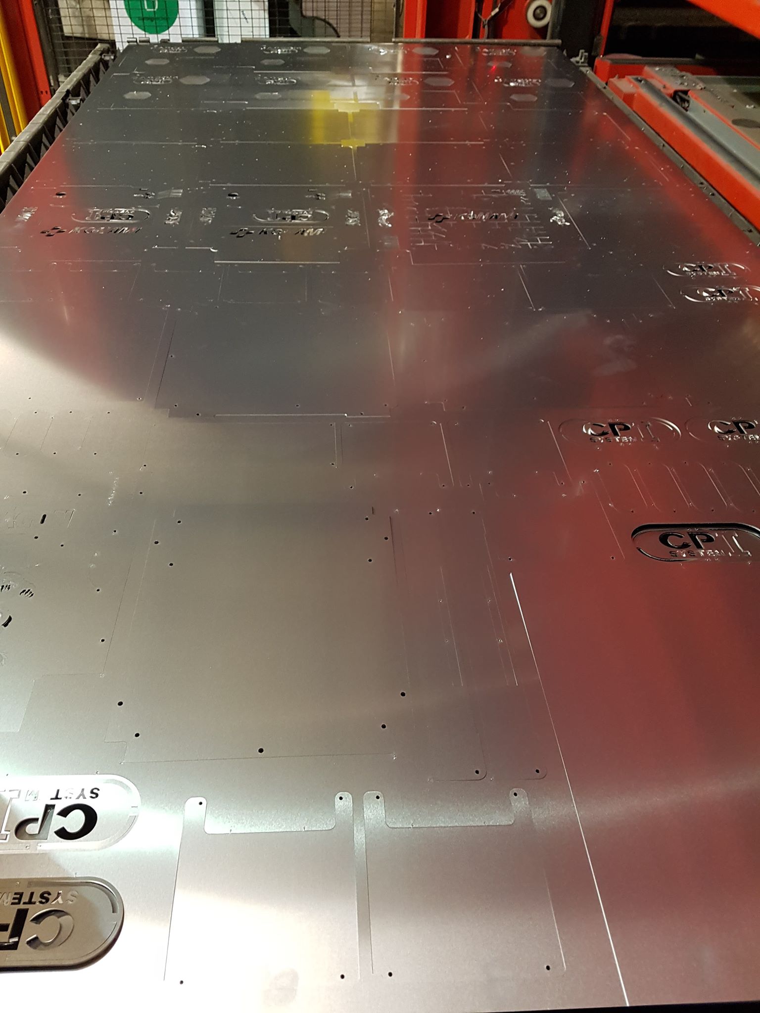

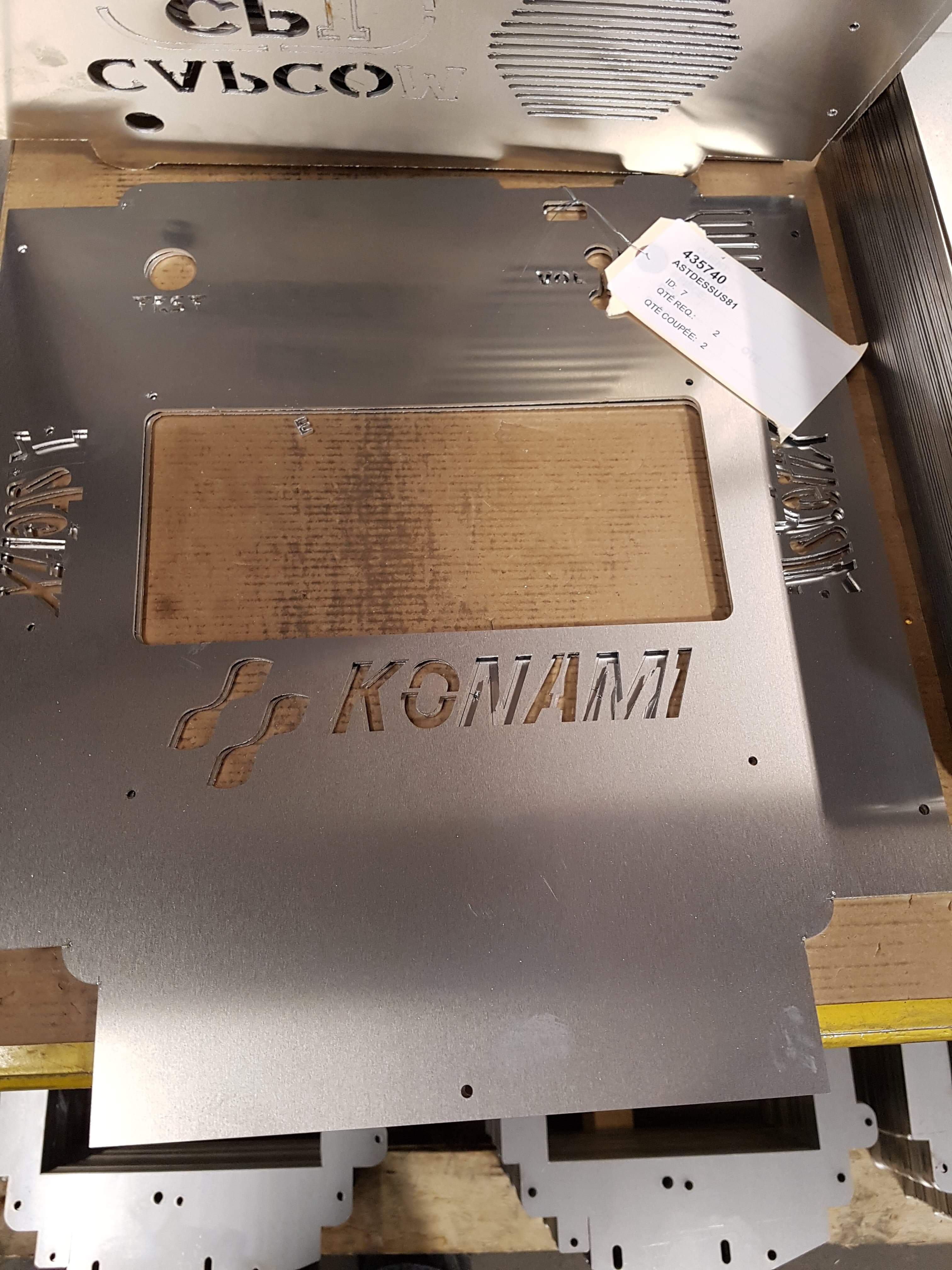

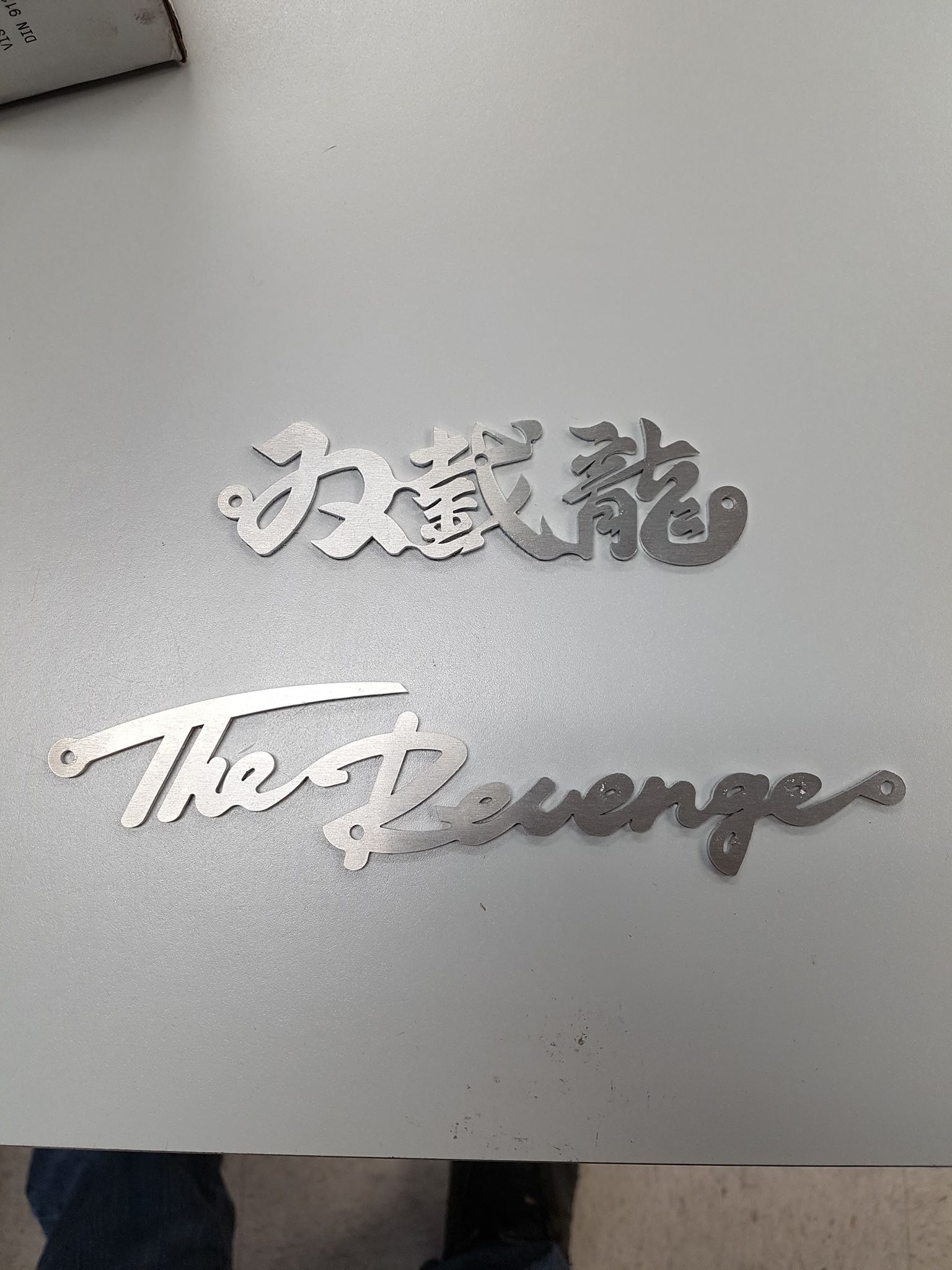

Proto is on he way ! it will have quite a look :)
Look in pics uploaded to see text that will be included.

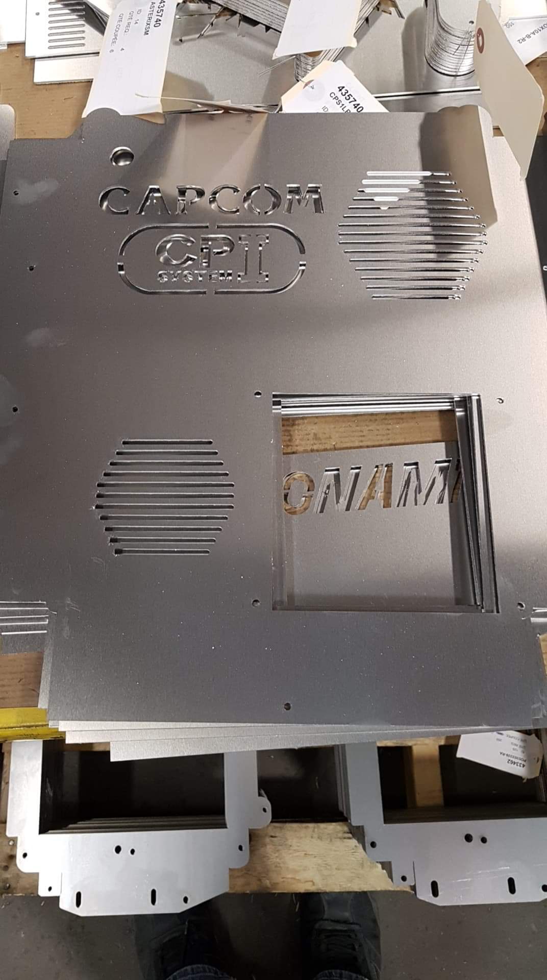

as for everyone's order. it started this morning. still a long way to go !

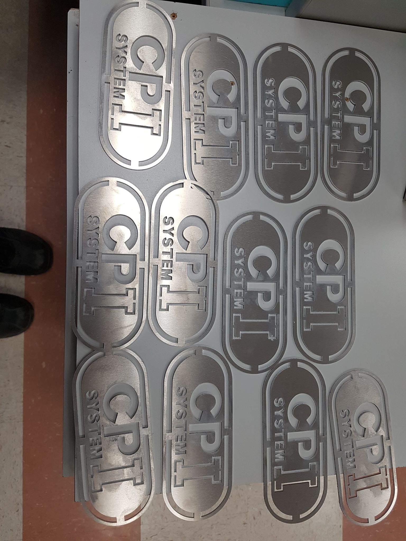

Everyone will have a small extra CPS1 logo made from aluminum :) (only for this order)
just for fun. (no paint)
Here's a movie about how it goes for one main part of a cps1 case.
...and well.. someone wanted to play a joke on me while i filmed...don't mind that music ¬_¬ (0:53)

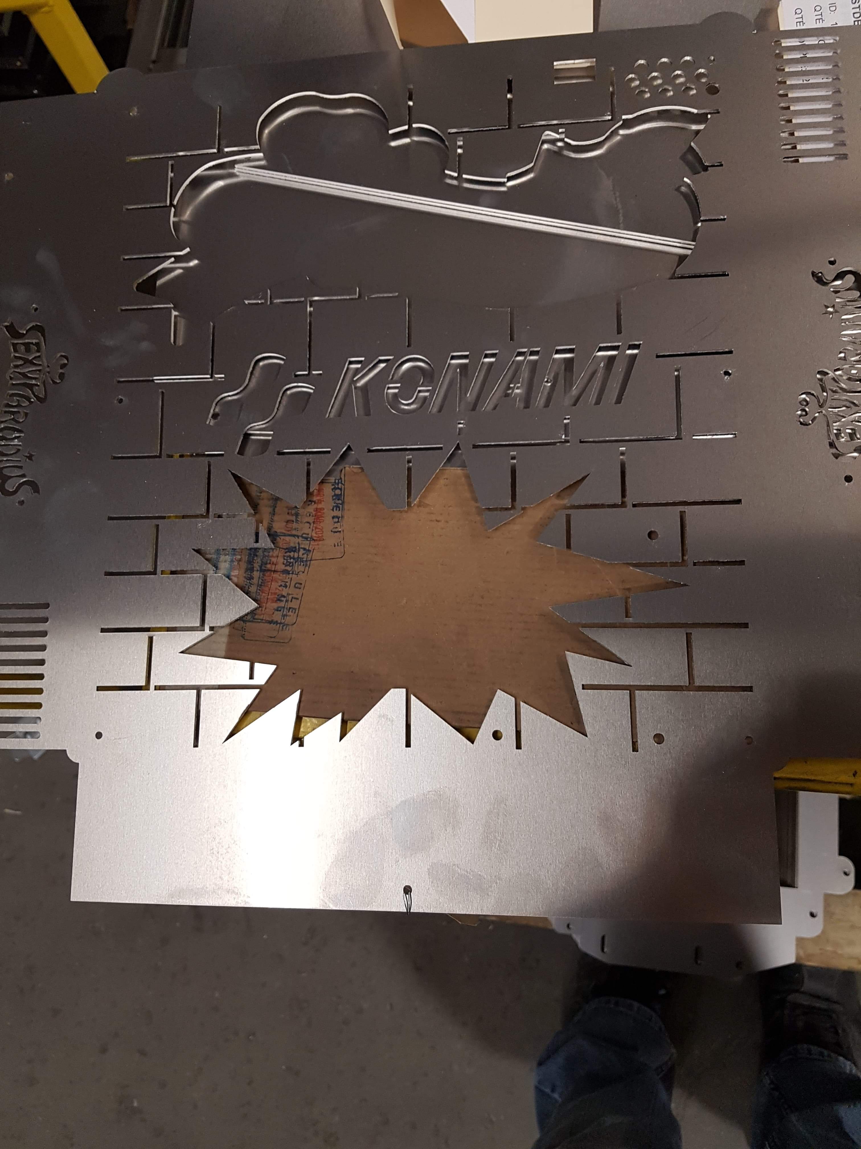

Updating !
well, since we're going into this month's end it went a bit slower then expected.
cases are still in the process don't worry everyone ;) (they're waiting in line))
I had to think about those cases seriously. I have to say that using the company's names/logo (like capcom and konami) and stuff like that is rather
dangerous to play with. Being a fan i always try to make stuff very precise ...but selling it to others is another story.
The cases i've done so far have everything like i've shown so don't worry. Nothing's been changed.
But those might be the only ones with company name/logo carved directly on the case itself. I'll do some researches on that matter
and will look for some way to twist everything in a legal way so i don't get in troubles :) if anyone have some tips or help ;) tell me !
anyway !

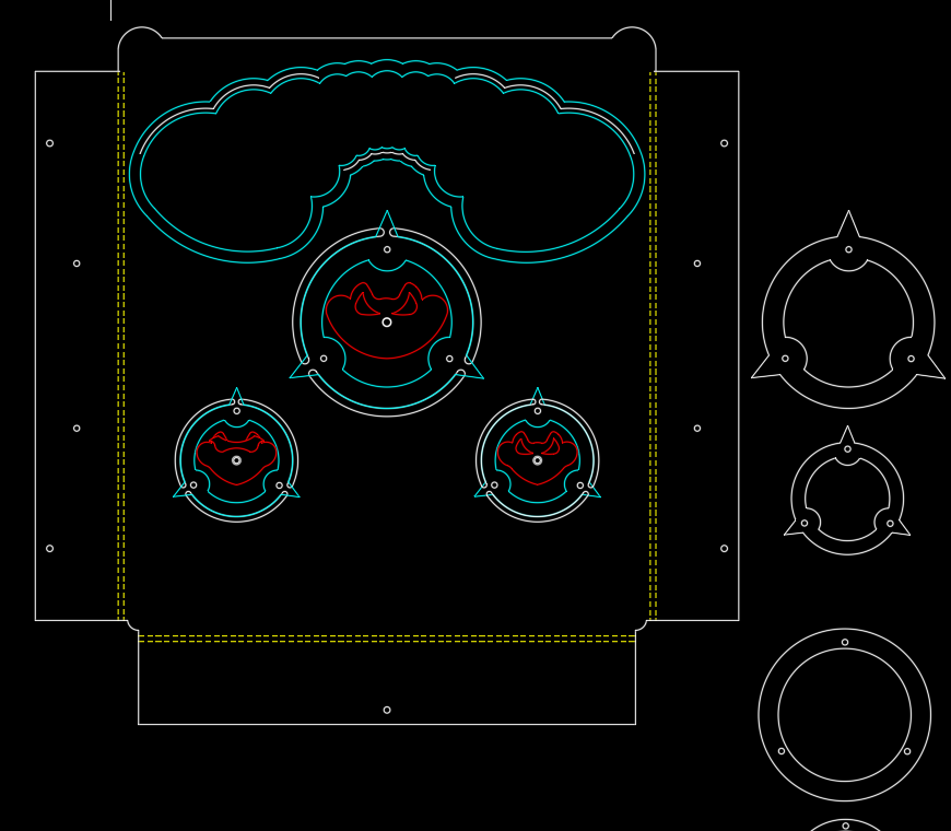

while i wait,why not shown what's been done with Battletoads so far ! :)
(and yes, i will have to look for what i can do about Battletoads as well)
