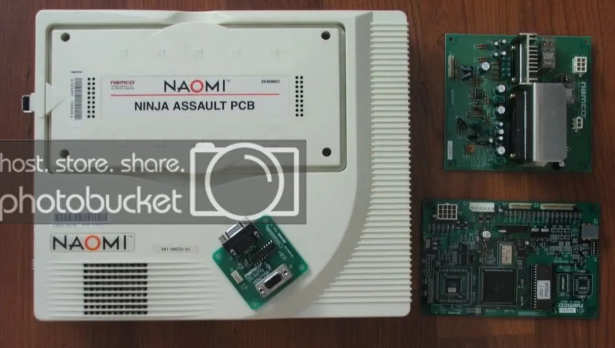

Ninja Assault does not use analog inputs, that's the problem.
This game uses a special IO board with CRT guns, the IO board then translates the CRT gun position into X/Y coordinates that are sent over JVS as "touch-screen input" coordinates. AFAIK it's the only NAOMI game that works this way.
^You can see it has a VGA pass-through board that extracts the sync signal for the IO board for the CRT positioning to work.
What we want to do is play this game using Analog input type guns, like the rest of the NAOMI gun games. But it would need to be patched to accept input over analog INSTEAD of the touch screen input.
