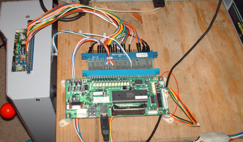

But remains the problem than capcom I/O may occure an error with that kind of adaptator, on the picture from psikyobabble its a common sega i/o :

indeed It seems than some wires are connected to extra boutons on sega i/o
as per my previous pictures, mahjong adapator is connected to sega i/o to on extra input CN
4 - P1 button 6
5 - P1 button 7
6 - P1 button 8
7 - p1 button 9
8 - p2 button 6
And as per Capcom Converter doesn't have those extra boutons it doesn't work.

Yes and No...
Sega IO can change IO port for Input OR output. (set by jumper)
When using with Mahjong it is OUTPUT. Capcom does not support Output.
Mahjong is very different from normal joystick controls.
With a normal joystick there is 1 input per button.
Mahjong has many buttons, there are not enough inputs for all buttons.
So it uses outputs to turn on only a few buttons at a time.
In the wiring grid on psikyobabble, the left column is for outputs, and the top row is for inputs. When one output is "ON" then only the buttons for that row will work, then the game turns that output "OFF" and turns "ON" the next output/the next row to read those buttons. etc.
This is slower, too slow for fighting game, but fast enough for mahjong :)
But that's why outputs are needed.
Alright, I'm sad but I understand :).
you seems still not really understand it, the important part: Sega 838-13683 I/O have jumper to configure CN3 function - input buttons or output lines (required for mahjong games).
Capcom I/O have an connector for "extra buttons" too, but they can not be configured to outputs.
and btw, not all NAOMI mahjong games uses same wiring, Idol Janshi 3 uses slightly different wiring than other 2 games.

I thought it was the purpose of the pcb under the panel :
With Hot Taisen Gimmick 3 (psikyo pcb), the panel MJ pcb was connected to the psikyo pcb with adaptator to fit with the psikyo pinout
As i understand the scheme (it's hard to explain with my poor english, sorry for that ... ), the choice of the bouton, for example KAN, appears when the panel pcb send the signal for light purple and orange in the same time (A & S on the solder side of the adaptator), I think it's the way to define many inputs, the two signals sent define the input from mj panel, in this case the KAN
On sega Naomi multiplex, indeed the second "signal" is defined by sega I/O board CN Pin 3-4-5-6-7. I regret only than capcom converter was not designed to allow the Mahjong pinout, it seems possible but not defined.
I didn't know than sega i/o was able to send input and output, I learned new things today :).
nope
See those pins labeled "COM" those are all OUTPUTs.
How can the game send the signal to the panel PCB if there are no outputs?
