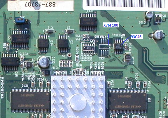

Well,im not 100% sure from now about revD (and my main Naomi is an read) but I'm sure to have tested it on different motherboard and it workedit worked ? its not possible.older NAOMI bioses (NAOMI1 rev A,B,C and the one used in hotd2) require mainboard s/n eeprom to be x76f100 (secured one).and i tried hotd2 bios and original game on an revD and worked
newer bioses (rev D and later) supports both x76f100 or common 93c46 eeproms.
as you may know hotd2 mobo have x76f100 eeprom, so it will work with any bios version, but newer "rev.d" mobos have 93c46 so it won't work with "old" bios versions.

it doesn't really matters, but it important which EEPROM type used.How do you know Naomi version B, C or D ? Is there several Naomi 2 revisions, too ?
