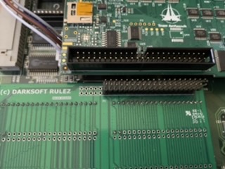

I’m installing the CPS2 multi and after installing the main board I notice that it doesn’t have a full set of header pins. Is this going to be a problem? it looks like it’s going to be a problem.
Yes, looks like there are some pins unsoldered there ||
Can you or someone in your area solder those missing pins? Should be pretty easy if they know how to use a solder iron.
Fortunately I had some header pins I could use. They don’t have the second support on them but I was able to get them to the right height. I had a few connections that weren’t flush and one of the solder points on the quick solder board wasn’t quite full, but after that it all works great now! Thanks!
