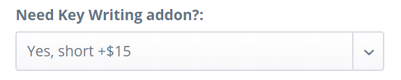

hey
before order cps2 multi
what is "key writing addon"?
also what is the standart lcd cable lenth?
thanks
originally the CPS2 multi required that you use modified/decrypted game code to bypass the built into the CPS2.
A few years after the multi's relese it was discovered how to re-write the security/decryption "keys" on the CPS2 so that we could use original unmodified/encrypted game code.
the add-on is a little wiring harness that is necessary to be installed if you want the ability to run original/encrypted game code and re-write the security keys. Without it you will need to run modified/decrypted game ROMs.
so this allows me to simplify the installation and use the suisided board as is?
how do i know if i need short ot lond lenth in key writing addon
and in the lcd cable
Regardless of your donar B board, suicided or not, you have two options.
Run decrypted rom pack.
Install key writing wires and run original encrypted roms.
There's really no difference between both in terms of gaming.
LCD cable, do you want to mount LCD selector directly to CPS2 or run it somewhere far away? That will tell you if you want the longer cable.
