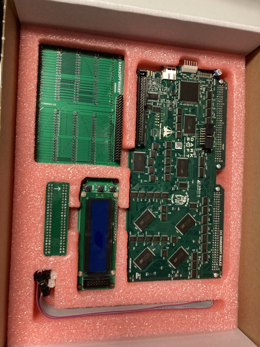

The installation went smoothly. Everything is working properly. I used a SanDisk Ultra MicroSDHC 32 GB Class 10 UHSI card because smaller capacities are difficult to buy.

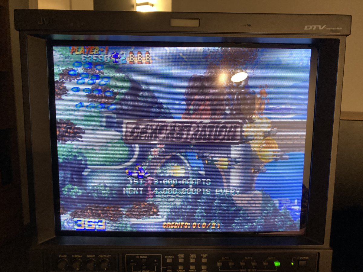

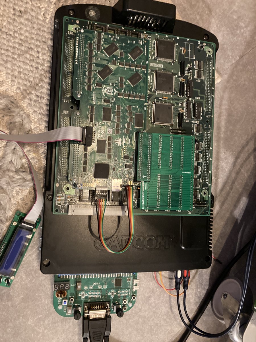

ok so set mine all up , and tried the first game D&D it loads in , i have to turn off after the loading as it doesnt reset, then the game runs but no sound , tried progear and the same no sound , also tried a SF II /also to add this board was running fine with sound before i did the multi , and the games i am trying are from the Decrypted roll up pack
Make sure that all PCBs are properly plugged, specially the connection between A and B boards. Maybe try the B board without plastic shell first.
yeah took it all apart and did that , its hit and miss to run a game but when it does they dont have sound, checked another pcb to be sure its not my Cab and my Fantasy Zone II has sound

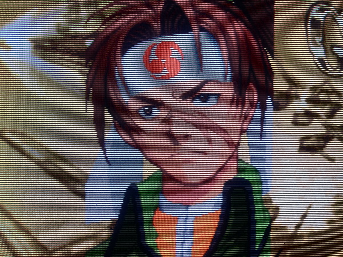

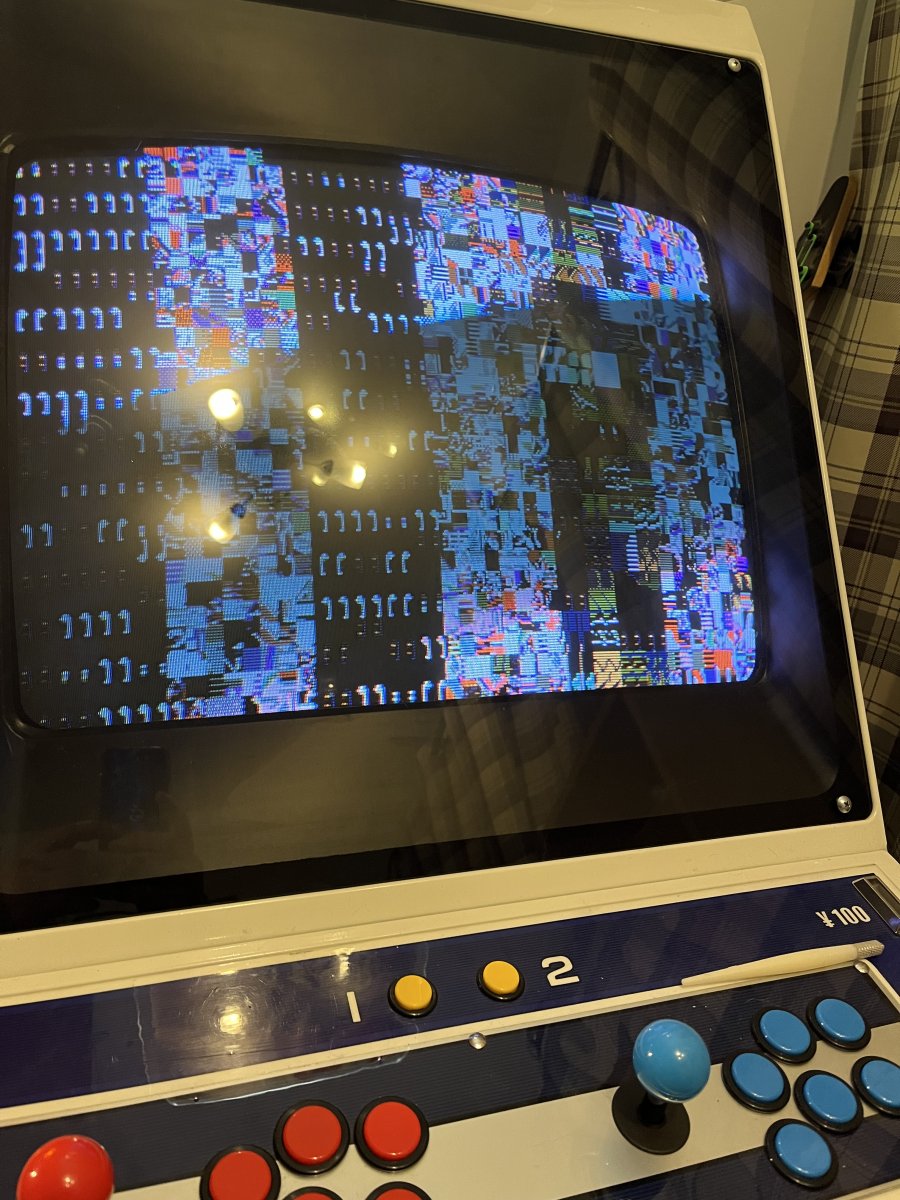

Loaded marvel v capcom , I get a load of sound like machine gun fire from a 1970’s game and then this screen
Something is definitely wrong. Can you try with another A or B Board? Even if you are loaded games that don't need keys. Do you have the key writing cable installed? try shortcutting again EXC5 and the try. If you don't have the key writting cable, you still need a reset cable installed to make sure the CPU doesn't execute code while you are programming the flashes.

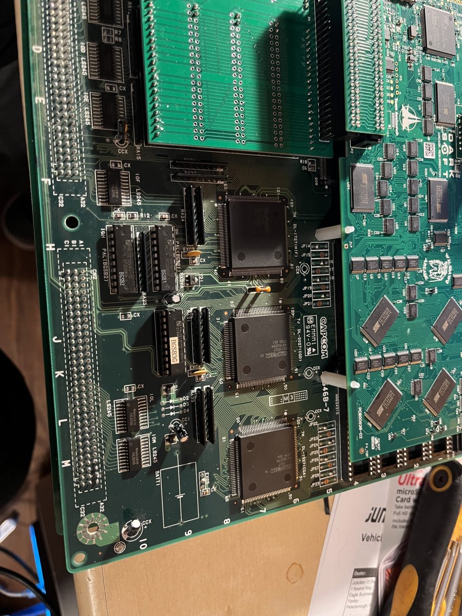

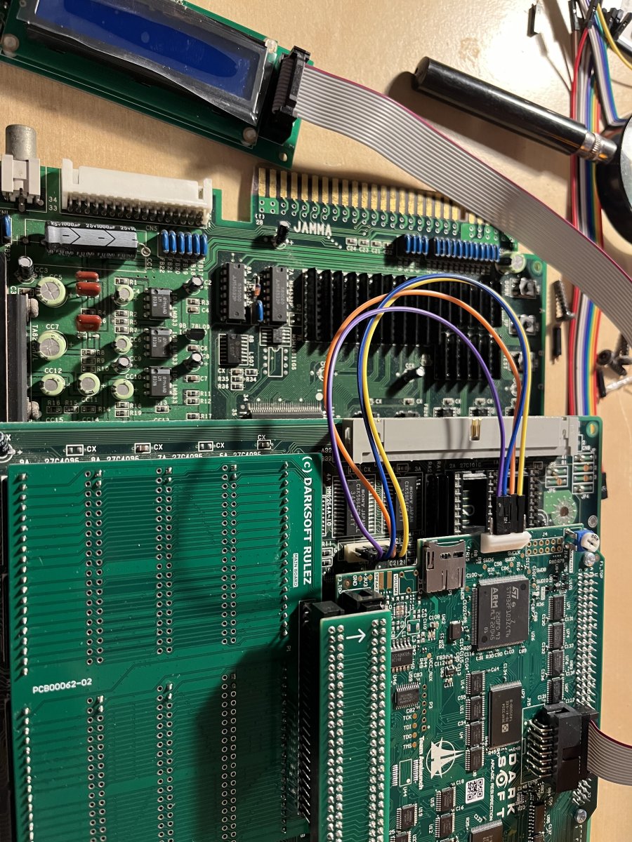

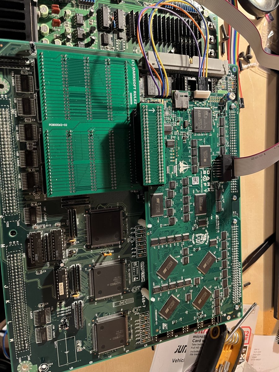

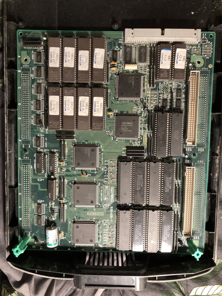

@Tonybolony is your CPS2 Multi kit one of the brand new "Champion Edition" revisions, or a prior revision? The previous revisions could have sound issues if a PAL chip isn't setup correctly. Photos of your installation would be helpful.
Pics
