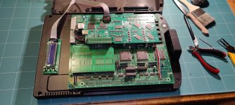

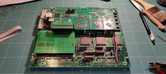

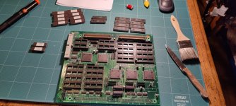

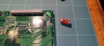

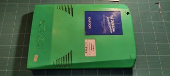

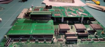

One month before the tournament my SSF2X CPSII died, last week I got the Multi Kit from my friend Aldo @CPZ - SAVEYOURGAMES , whom I thank for his speed and professionalism, and I modified my second X-Men CPSII. I share my work with you all! I am happy to have this beautiful product! And the January tournament was saved! Thanks @Darksoft for giving us all this.
