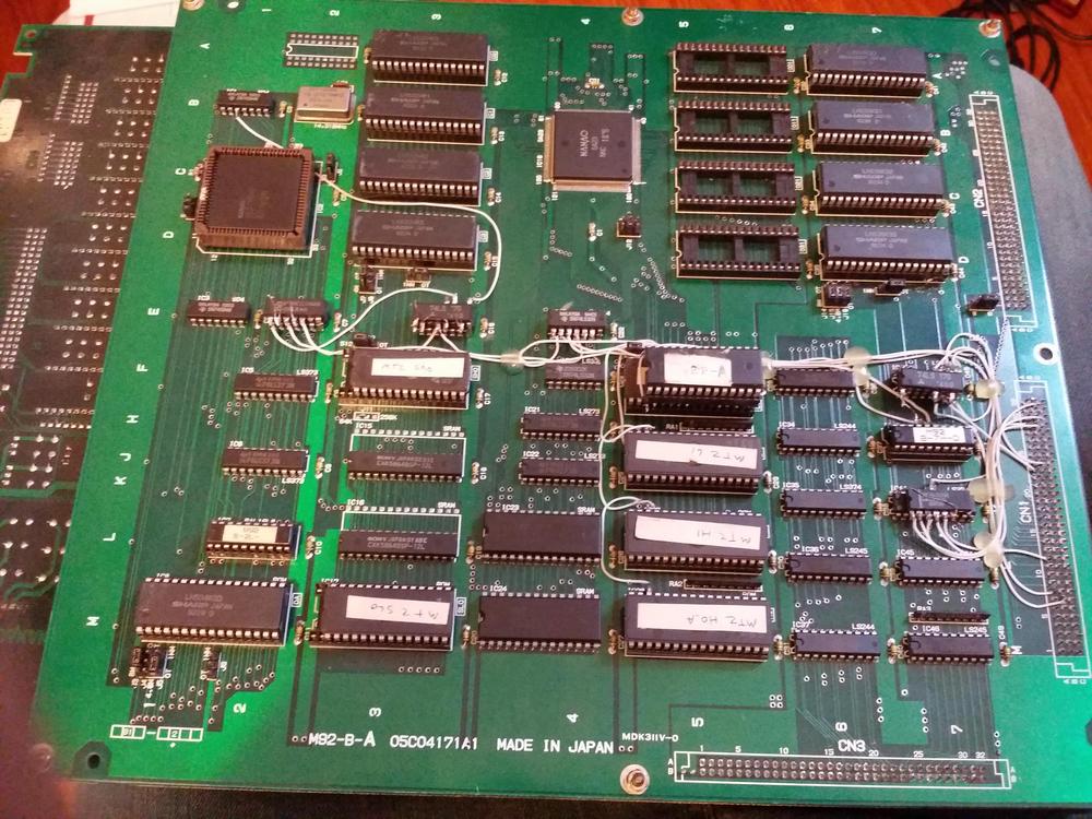

I will also post pics of my Gunforce --> R-Type Leo conversion. I don't have any info on how it was actually DONE, but it works flawlessly. Maybe the experts here can find out from the pics.
Yes, I had my Gunforce converted into R-Type Leo. I had a technician do the job for me using files provided by Apocalypse. Works flawlessly.

To make a M92 convert, you need decrypted sound roms and disabling the jumper near the PPU (or use reencrypted sound roms to work with your PPU), then use the rest of the romset and move the jumpers depending of the roms sizes.
Gunforce doesn't support enough ROM space to work with games other than Gunforce, which is the reason it's not suitable as a donor.
