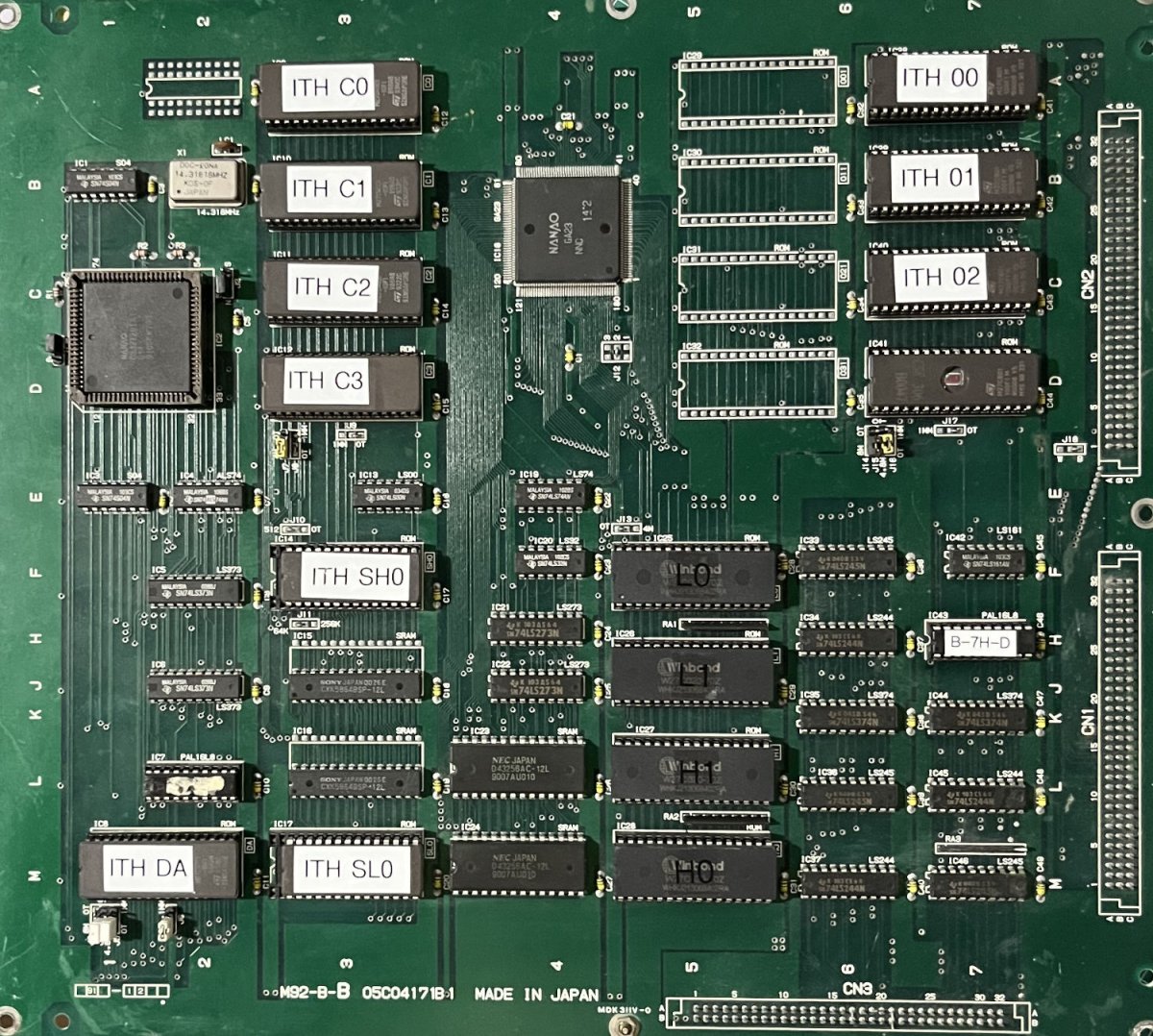

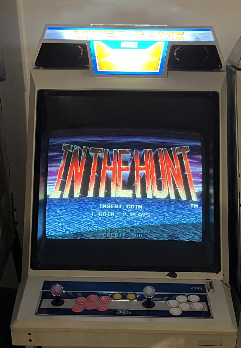

@wickerwaka Thank you for sharing your research. It inspired me to go try convert my Gunforce into In The Hunt.
  • Desoldered 9 32 pin roms, installed sockets in their places
  • Programmed the ITH rom set + decrypted sound rom + M92_B-7H-D GAL
  • Set up jumpers accordingly
  • Success!

Games like Ninja Baseball Bat Man and Geostorm are impossible to make with donor games like Gunforce, Undercover Cops, Mystic Riders, R-Type Leo or Hook. The max these rom boards can handle on CPU zone is a total of 6MBit (2 x 256KB eproms + 2 x 128KB eproms).
If the game needs 4 x 256KB eproms (8MBit on CPU zone), it needs bank switching so you need Major Title 2 and similar rom boards.
Yesterday I tried to make a Ninja Baseball Bat Man with a Undercover Cops donor rom board and it's impossible. Aisled A17 signal of H1-L1 sockets (default tied to +5V) and tried to make that signal work. Graphic garbaje, gameplay bugs and bad H1-L1 roms checksums on boot.
