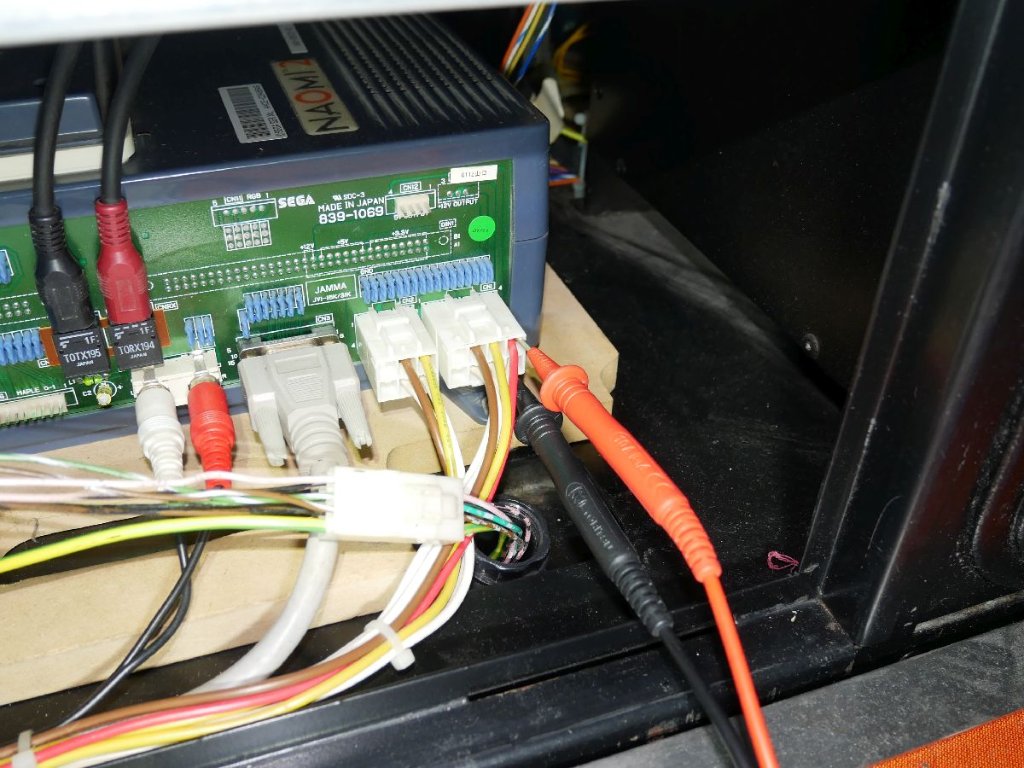

Since you already have a multimeter, how about testing those voltages? That should have been your first step.
Set your multimeter to DC voltage and put your black meter lead on a ground point and the red meter lead on the voltage that you want to measure. Ideally you want to measure as close to the system as you can.
On a Naomi I would measure from the filter board power connectors:
Brown wire is +3.3V
Yellow +5V
Red +12V

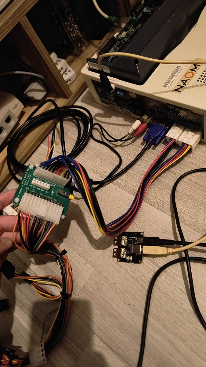

I have an adapter pcb, from atx to naomi.
For gd drive a attached the 4 cables to gd drive pins from a Molex Cable.
If you tried attaching a picture, there isn't one.
You do know that standard ATX wiring color is not the same as the one Sega uses?
Im at work, i will test the power with multi meter soon and make few pictures from my setup at home.
I do t work with "colors", i read which cables has which voltage, and then i worked with gd rom drive pinout specs.

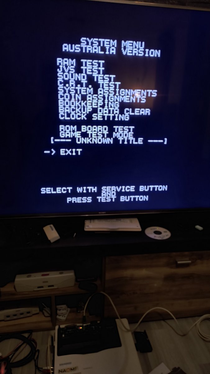

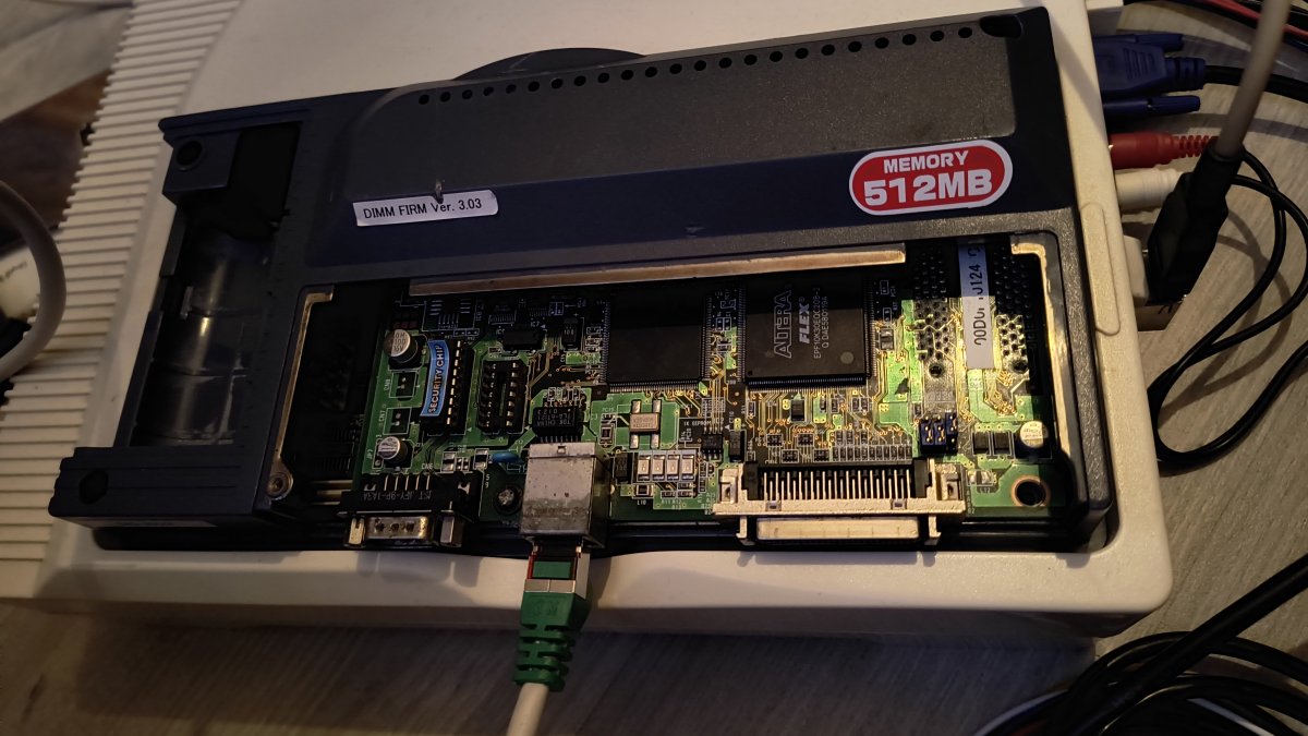

So except the gdrom fail, here or some pictures and some questions.
What are the LEDs on the upper pcb up for? It looks like only for ethernet connections. Cause 3 of the 4 led blinking and shining when a raspberry or pc it connected to net dimm.
I have screws now but same issues.
And what standard ip has the netdimm? I would try a update with pc, but then i need the correctly ip and i would try it with standard ip.
And its not nessesary on which region the naomi jumpers from multi bios are or?
Then, what hase the jumper on the second pcb for functions? You can only see this jumper when you put the PCB apart.

Security chip can be non working also.
You won’t know unless you can read the pic chip ?
Or test in another net dimm
Net work info here
https://8bitplus.co.uk/projects/netboot-sega-naomi-netdimm/
Jumpers on the lower pcb are for diffrent size memory stick settings
Yeh when no network shows up I would try re seating the memory stick.
If not working you could try getting new memory or a new security pic for the network dimm

I have a new secure key from ebay. But it is nessesary to get the network and dimm settings in the test menu?
Yes, it is necessary. The key won't change anything.
Can you put this secure keys wrong in the slot?
So you say, if no key is connected, i dont having network and dim settings?
