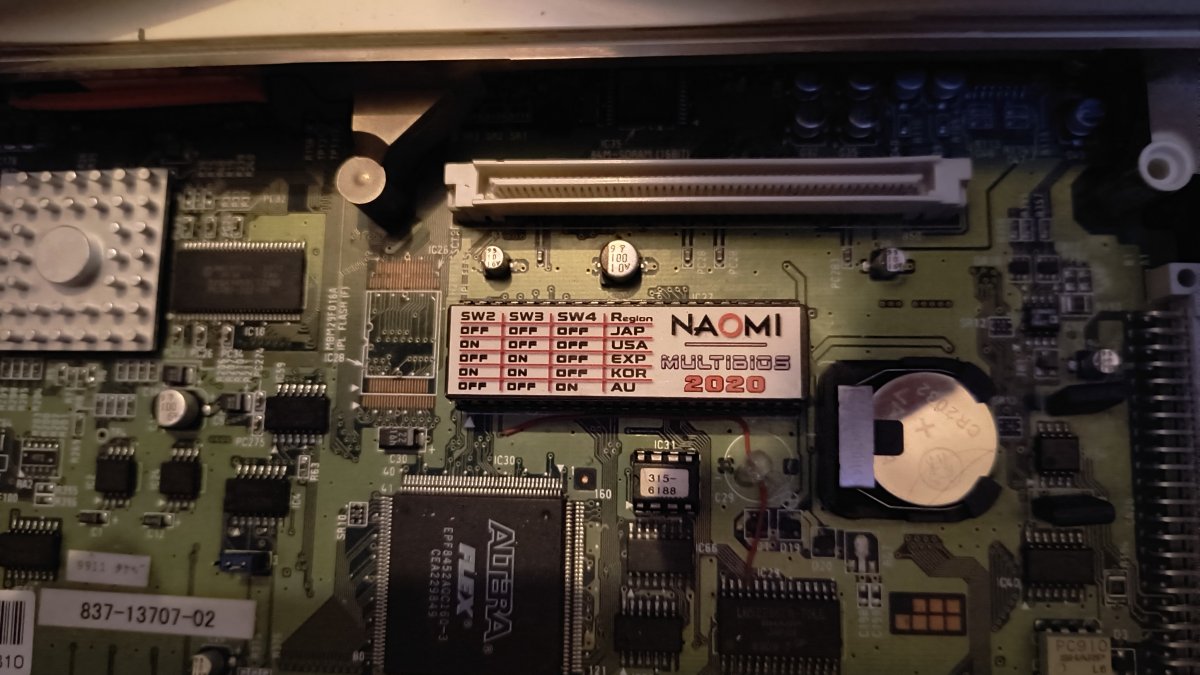

Hmm, never seen a "System Menu" screen mentioning "Australia version" before like in your picture, can you switch the multibios (assuming that is what you have) to Japan?

I switched the regions often when i tested the gd rom drive.

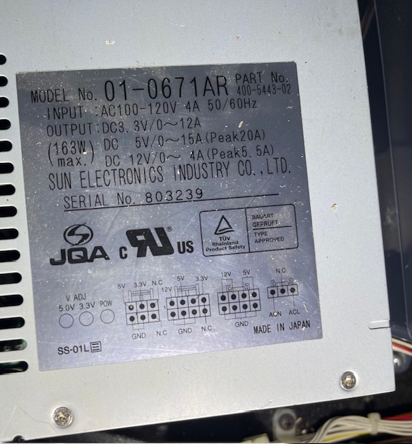

for the record the official sega ps for naomi 2, with netdimm, is 163W max.
Yeah i believe it too, i only want to check another psu then mine atm. Maybe its broke, idk

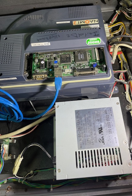

It's not the watts, from my recent experiences setting up a Naomi and netdimm. The Naomi and netdimm need a psu that can supply it a constant 5A on the 3.3v line plus whatever is needed on the 5v and 12v , this also appears to be why you can't power a Naomi netdimm setup off a Capcom I/O as the 3.3v converter cant cope with a 5A load.
I am no expert with atx psu power for a Naomi but I am guessing its not about the watts, just that the 600w ATX psu is able to cope with the the 5A while the 450w cannot. I guess all that work the psu manufacturers put into marketing more watts has people thinking watts over amps. Funny that.

My 350 watt ATX psu ( low grade )
Isn’t broken But won’t power Naomi & net dimm
But it will power Naomi with cart game no issues .
no network settings symptom Is mentioned as bad or incorrect bios …
Are the H revision and multi bios Diffrent ?
Is multi bios a custom non original sega hack ?

gD rom Case designed to mate with the Naomi.
The RAM test looks positive.
The new Screws fixed netdimm tight.
New psu with 750 works fine.
But, no netdimm options in Test Menu.
Maybe the Ram tests are bad? Maybe it looks allfine but one of the Ram are broke?
I will test it again with and without ram, soon.

I have a multi bios i wrote before.
Do you know difference's, good and bad things from some Bios Chips?

Well all you have done is ok I think so
Seems you have a bad net dimm
I have 2 net dimm the same I need to try back in uk mid jan though with new dimms on mine …
Not sure if we can find the fault maybe ?
I have good net Dimms so I am going to swap parts of the three pcbs between known good parts . To find bad pcb but most likely the main large pcb
I know the carts have a gateway ram ( main ram .) so maybe the net dimm the same and has 1 bad ram unfortunately
