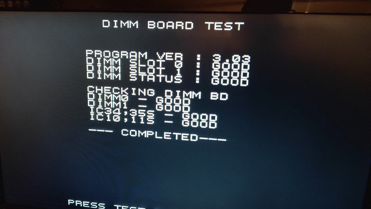

That Zerokey should work, did you test the memory in the DIMM from the setup menu ?

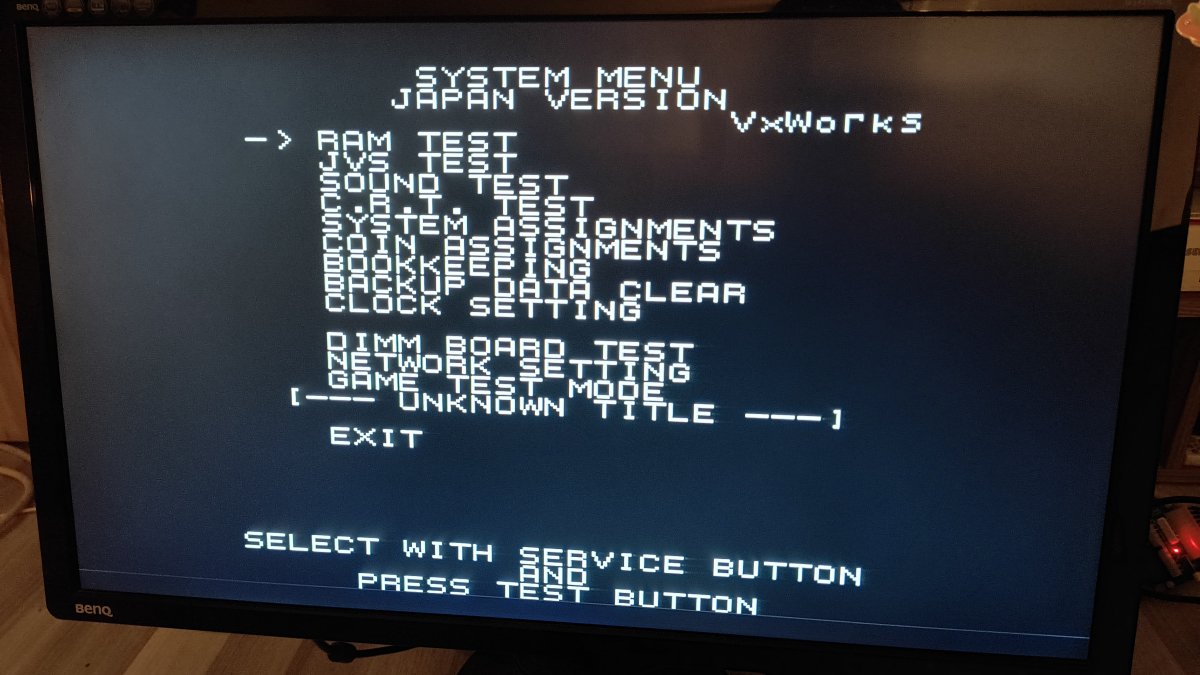

When it resets goto the setup menu and check if unknown title has been changed to something else.
I tried to load a game via gametransfer in cmd and get this screen for the first time, but then it goes back to "network checking" after reboot... And the unknown title is still present.

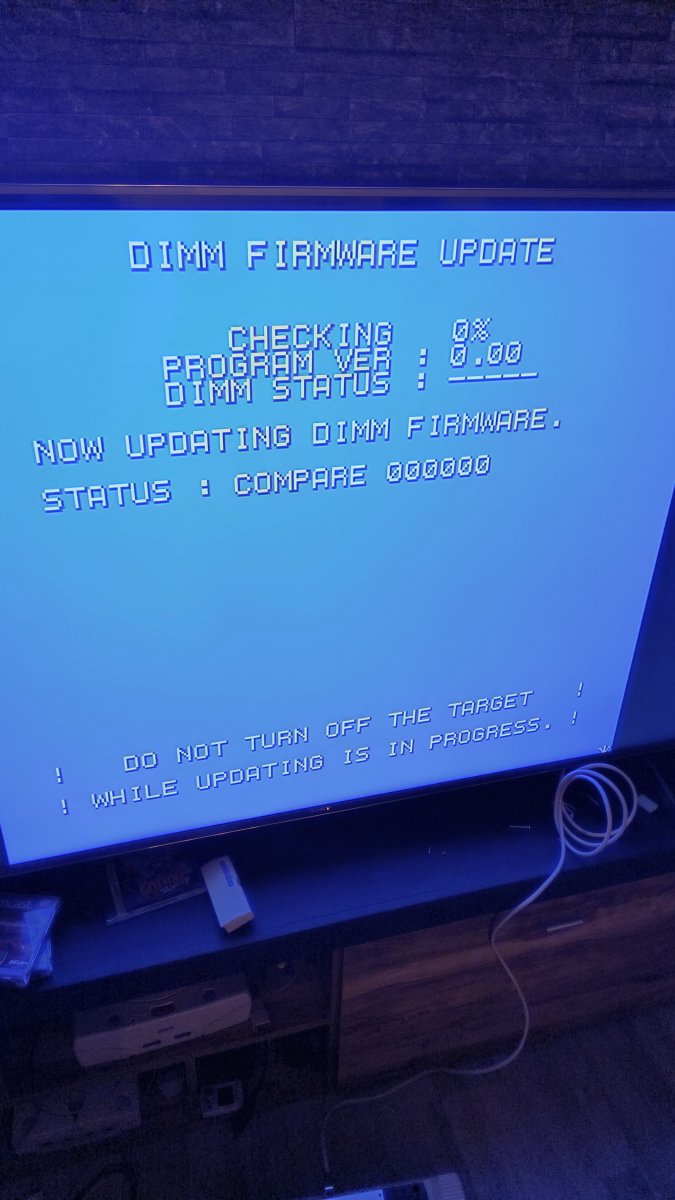

So, i have some troubles to update this bi*tch xD Why i stock at this screen and nothing happens? I tried to load the 4.01 update via wipi or with transfergame.exe and i only get the first screen which show the 3.03 version and after that, at this second screen, nothing happens anymore...

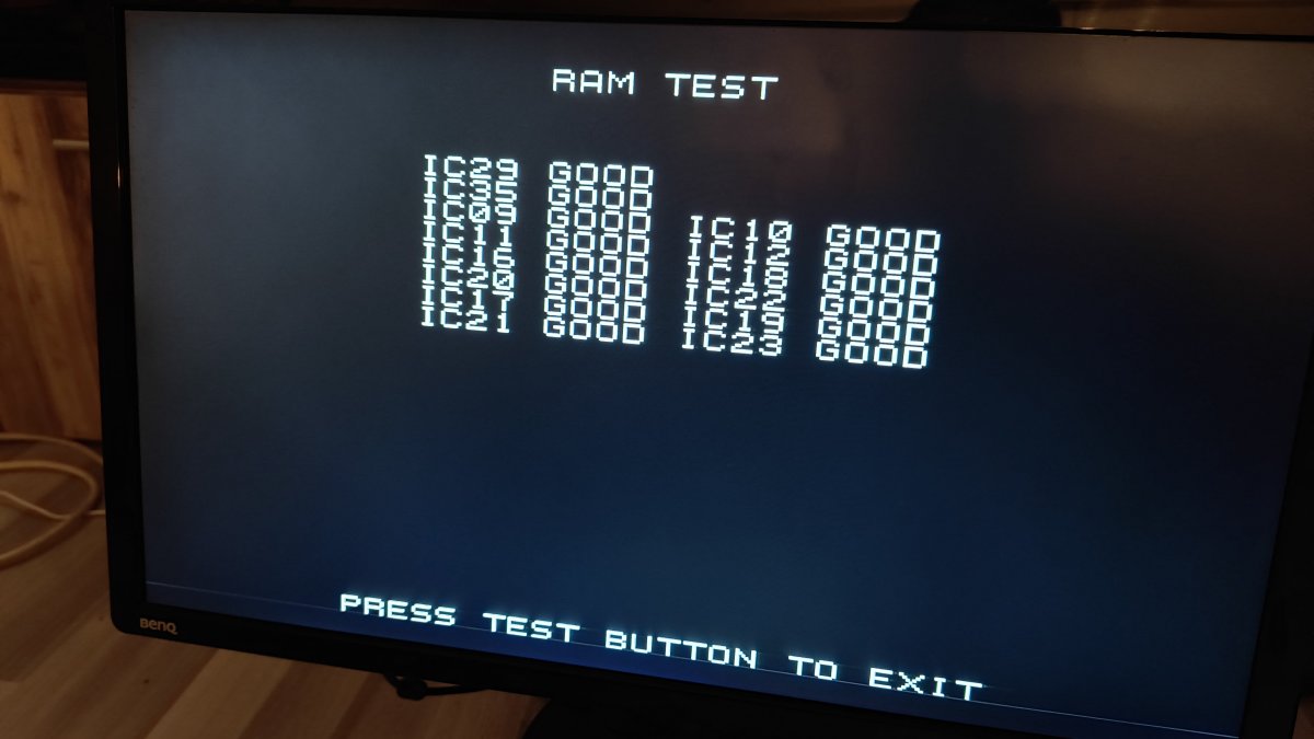

I still have some troubles with the most of games, its going to "checking network" screen but the game is loading which i can see at test Menu. If i doing something wrong?
At first i have to say, that i have the most arcade naomi games original on dreamcast at home.
So i test some games, i cant tell now all, i asked my self why some are not booting, only go back to "checking network" ... And why i cant start the update.

I wrote before, i have net dimm version 3.03, and i cant update it via PC (cmd) with a transfer tool or with Wipi. When I start the update from, all looks fine, but then in the last screen it stands on 0%. When i use Wipi it only restart and it comes only "checking Network" ....

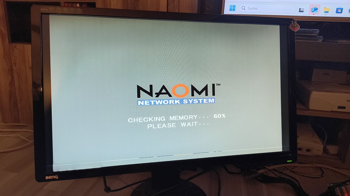

So i tested games again today. At first i have to say, i dont use a switch anymore, otherwise i often (,not only) get a no right netdimm was found... So without a switch i can start all games but not all are working:
"checking network" issues are when the namo going to checking network state after checking memory state!

So then, this "memory checking" extra reboot is cause one RAM dont work correctly. All tests in Test Mode was fine, but i changed some RAM and after it it works very well.
A funny thing is, that i couldn't update the dimm with this broke RAM. After i changed the ram i updated the dimm directly!
