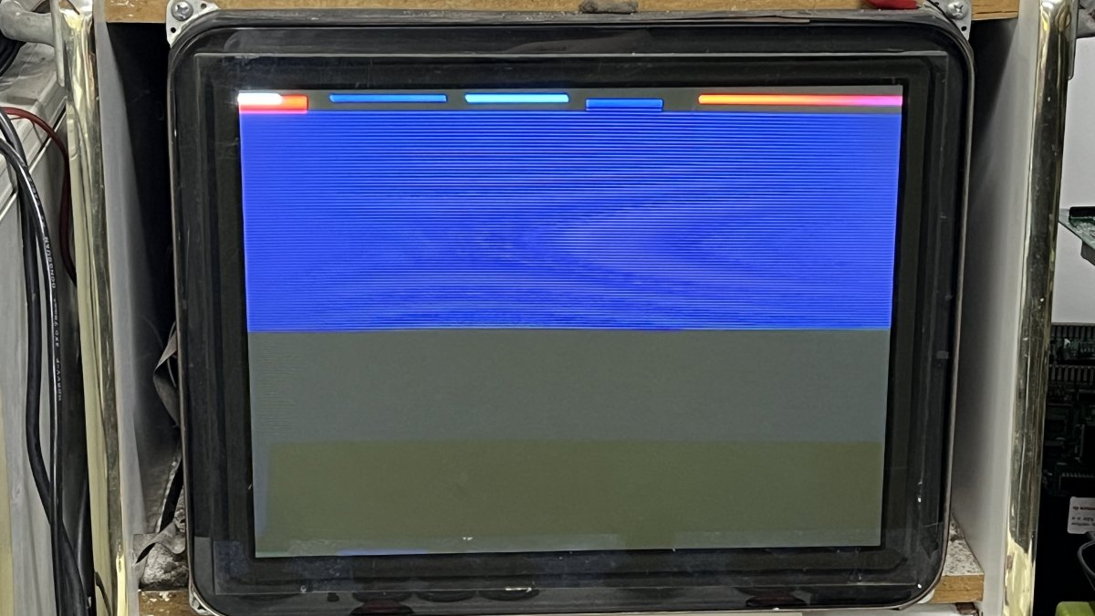

Changed P2 with a 322 without change any jumper this is the result

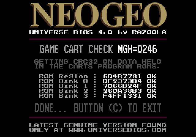

I just ran the CRC check for Shock Troopers 2 in Unibios 4.0 under Mame:

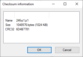

Rom Region corresponds to 246-p1.p1
If you split 246-p2.sp2 into four parts
Rom Bank 0 is the 1st quarter
Rom Bank 1 is the 2nd quarter
Rom Bank 2 is the 3rd quarter
Rom Bank 3 is the 4th quarter

Flashed P1 on 27c800 still the same problem from the pic above, game runs but all I can see it’s a blue screen and some colored squares.

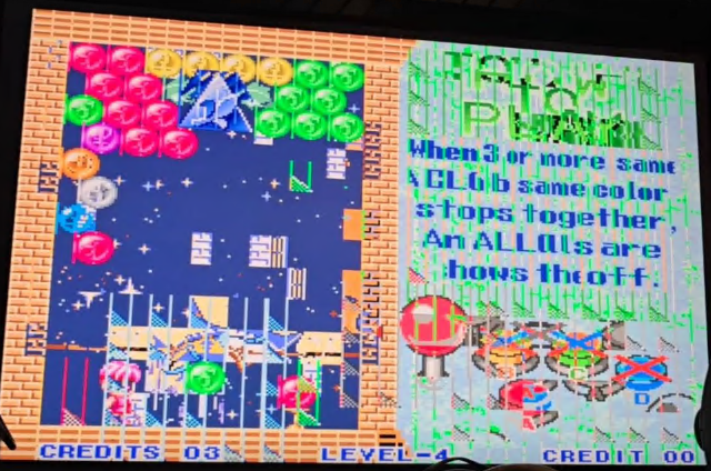

Here how look a grapics corrupted grapics
This is not the best example but i have no time to find another sorry.
Hi there, The is some kind of image, but its unplayable, tested another cartridges and work flawless, not a monitor or mvs problem.
I1ve posted a image of how the game runs, just block of solid colors and sound, I didn't have time to work on cart, probably only next week, I've another shock troopers to change board to test.
