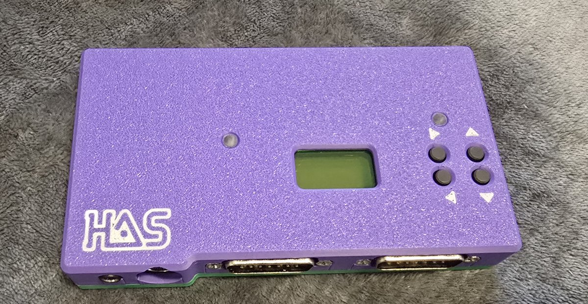

When freshly starting the HAS, everything is working fine.Have you tinkered with the CSync setting in the new HAS? You can try that. You can also safely use the TTL level CSync. It has a 470R resistor in series, so your receiving consumer equipment won't see the 5V CSync, but around 0.7V max, which is safe.
But after 1 or 2 minutes, I loose the video signal.
Indeed, activating TTL Csync level solved the issue, thanks a lot.
I don’t understand why (I’m far from having your technical skills
