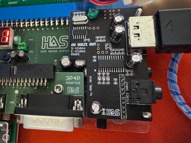

My adapter doesn't populate the Composite Video pin. @merrygoomba I apologize for this. If you got my adapter solely to use it with the hdretrovision cable based on my earlier response, then please drop me a line, and I'll refund you.
I will have one user test the adapter with a fix that maps the CSync to the Composite Video pin as a workaround for the hdretrovision cable. I'll share the results here.

The fix was tested and confirmed to work perfectly with the HD Retrovision SNES cable :)
It requires a bodge wire between the CSync and the Composite Video pins, as shown in red. Set the CSync on the HAS to 75R (deselect "TTL CSync Level").

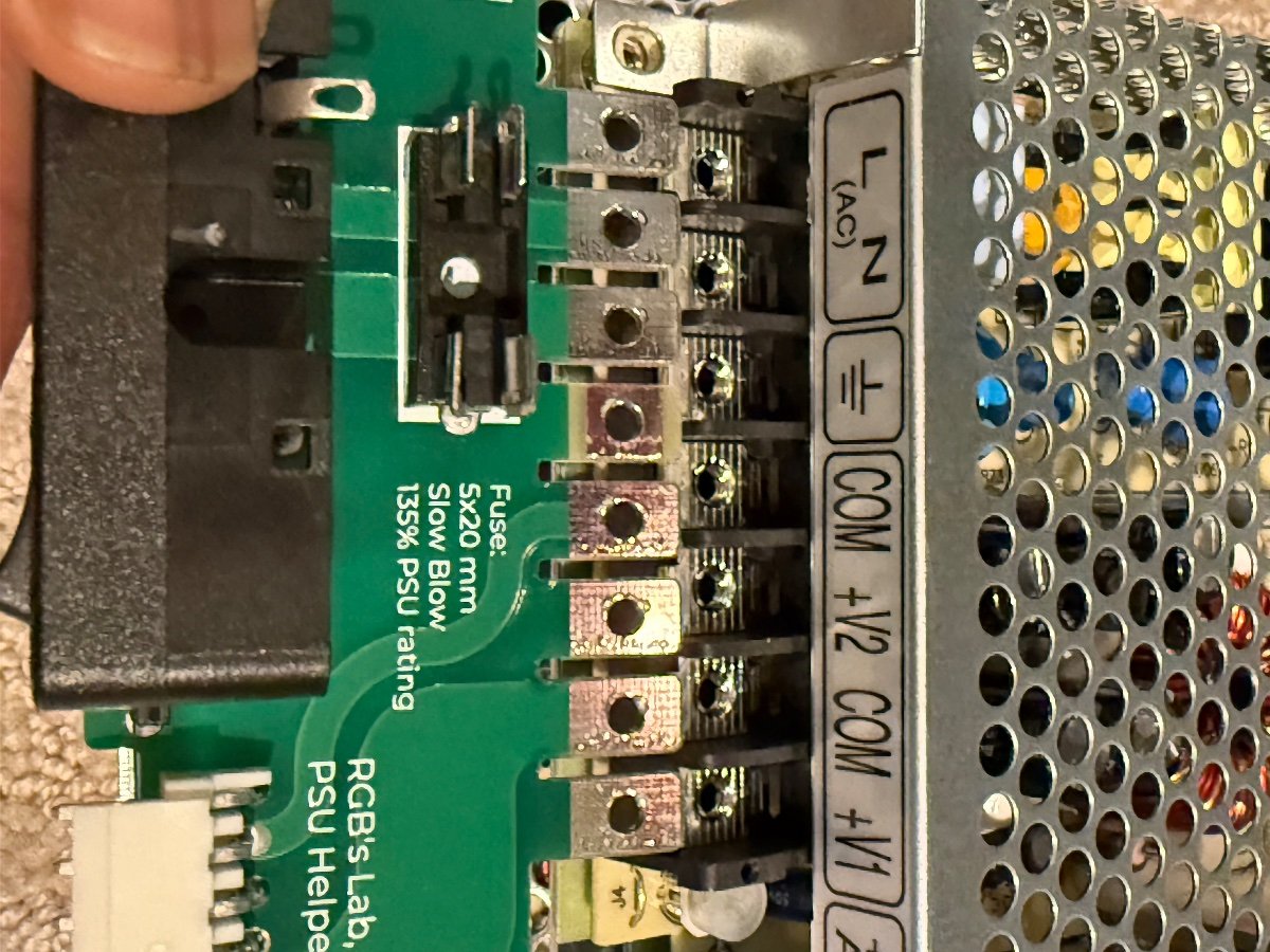

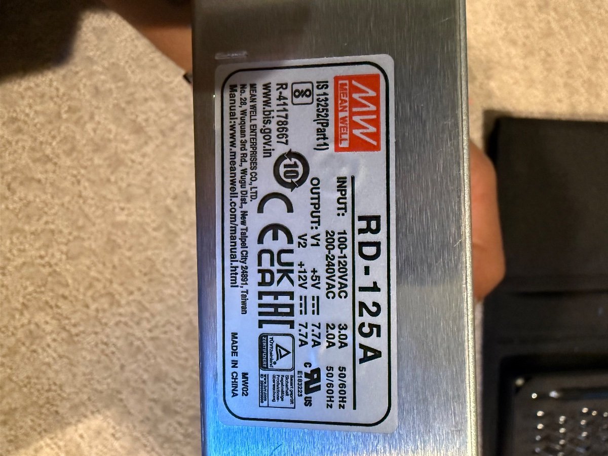

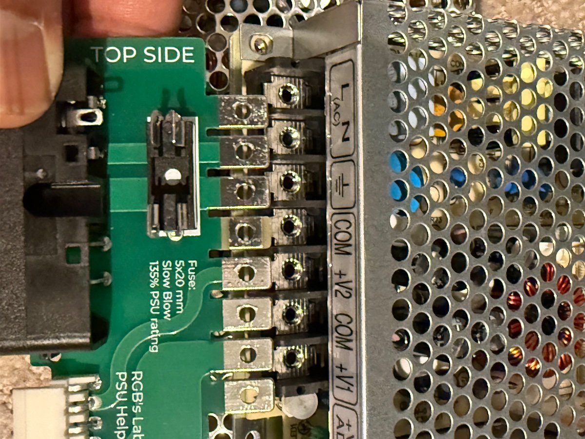

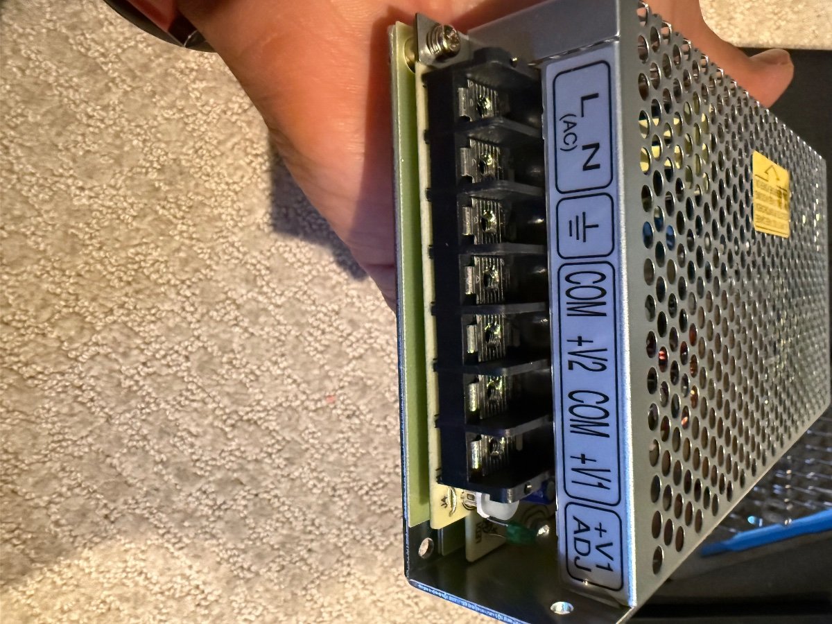

@RGB Just got the new HAS in along with PSU adapter. Also big ups to this man for including the HD-15 to SNES Adapter. I really appreciate that brother.
I do have a question for the group about the PSU adapter fitment to a Mean Well RD-125A. For some reason the PSU Helper PCB is not lining up with my PSU. Could this be an off print of either the PSU Helper PCB, or the Mean Well?
Photos below for reference.
V/r
Kelly
V/r
Kelly
Disregard guys, I am an idiot. The FAQ says Mean Well models RT, & I have a RD Jesus Devonta Christ. I got the wrong model.
Ha, I did the same thing recently! Not a good feeling at all after you spend 30 minutes probing voltages only to realize you accidentally ordered the wrong supply and didn't even notice.

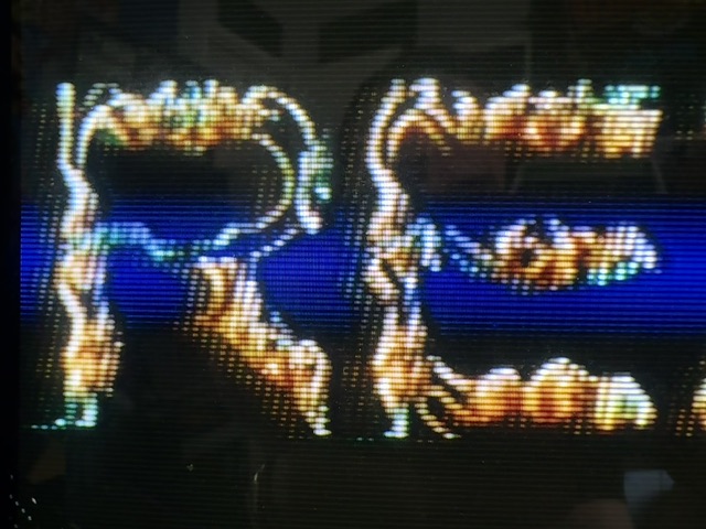

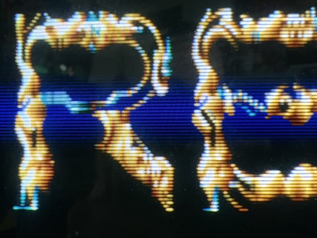

So a quick recap: with few electronics experience (again, I’m a software guy), but a lot of patience, will to learn and understand and the help of a good multimeter and ChatGPT I traced down the problem to the HD74LS05P after tracing all the paths between the DAC resistors and several ICs… basically it handles the common dark bit and the shadow register… it seems to be stuck on the pins for the blue channel, resulting in darker blues and therefore in a yellowish image.
My technician will replace it and possibly socket it along with the two HD74LS273P.
I'm glad to report that after replacing the HD74LS05P, the white and the colors are perfect. Both the HAS Supergun and the SCART cable were perfectly fine.
Thank you again.

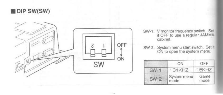

I had the DIP switch on the Atomiswave set to 15 kHz (up), as my Trinitron can't accept 31 kHz.

Photo below shows DIP and their expected positions for AW.
