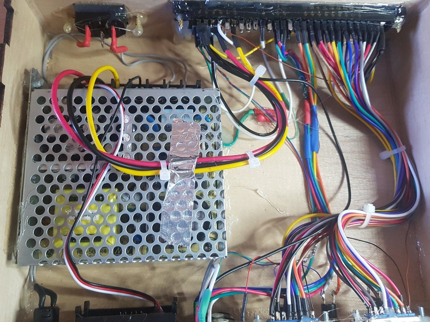

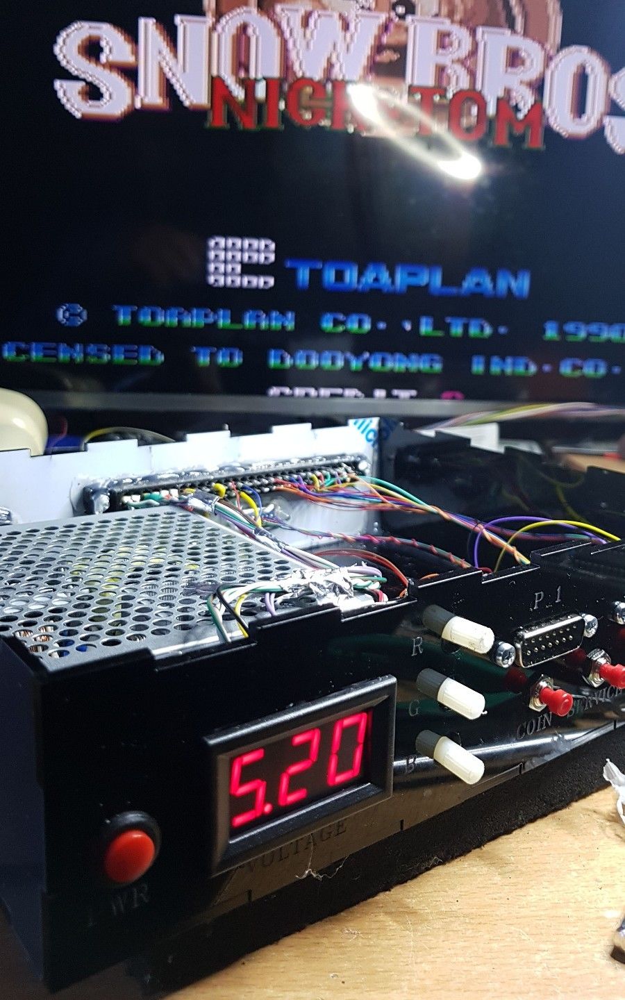

Hey guys, question for you. Since the HAS is currently unavailable, I came across this Supergun on eBay.
https://www.ebay.ca/itm/223131925915?ssPageName=STRK:MESINDXX:IT&_trksid=p3984.m1436.l2649
The seller states,
" in my supergun i use meanwell with anti ripple filter + emi
varistore up to 2,5kv for extra voltage on AC system
rgbs cable home made with ferrite module by prospecta italy
sync filter by 1881
and rgb pot for control the single signal out :) "
