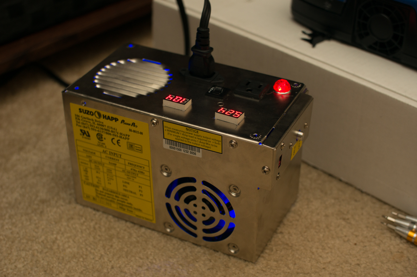

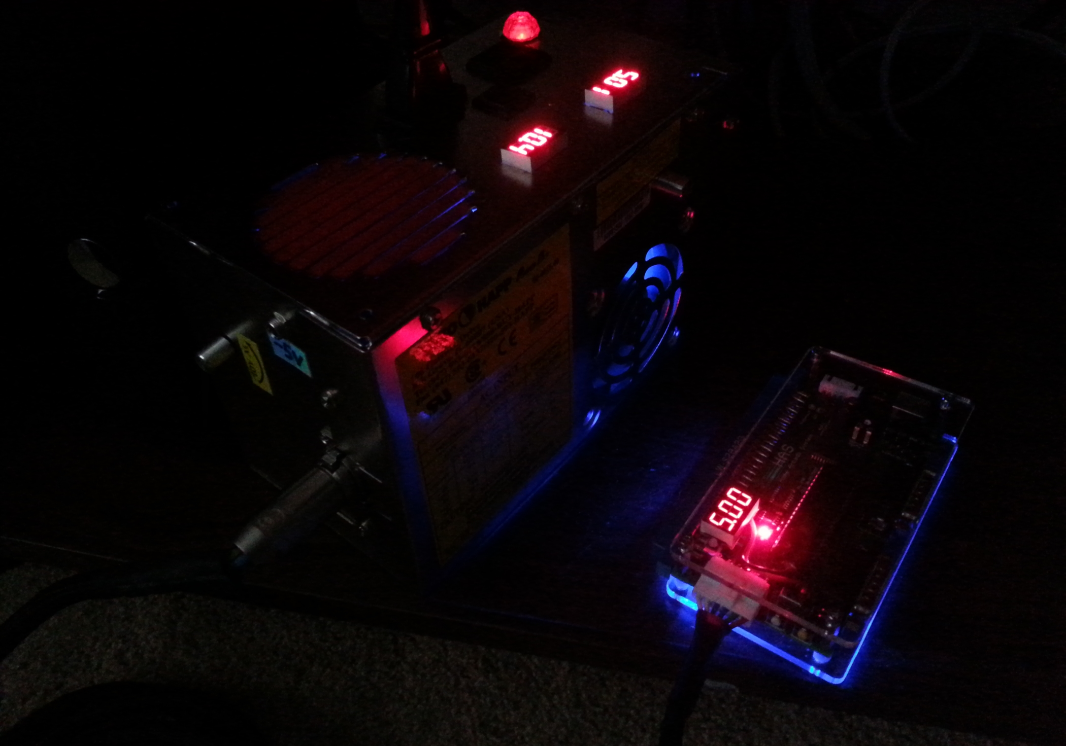

Happ Ultimates are cat/kid friendly. Here's mine, which is modded with voltage meters, LEDs, and an XLR jack for the output. I've since added a -5v jack and a fan speed controller dial as well.

You can make that yourself, since the HAS itself has no limitations on the power that you feed it. The problem that you will run in to will be with power hungry boards like CPS2. Laptop PSUs simply won't cut it for a lot of boards that you'll encounter.

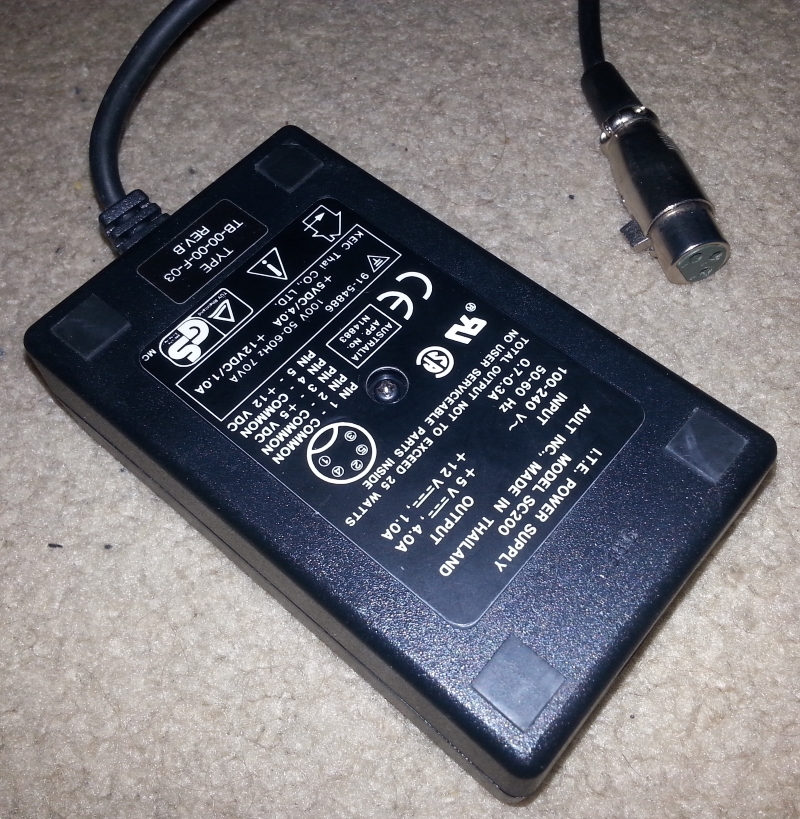

I started out using a modified laptop PSU (5V/2A), then moved to the beefier SC200 (below) and both had problems with certain boards. Both also introduced lots of video noise that disappeared after I moved to a proper arcade PSU. They also both measure significantly below their voltage ratings when measured at the jamma edge. Basically, you'll want a real arcade PSU pretty soon after starting the hobby.
