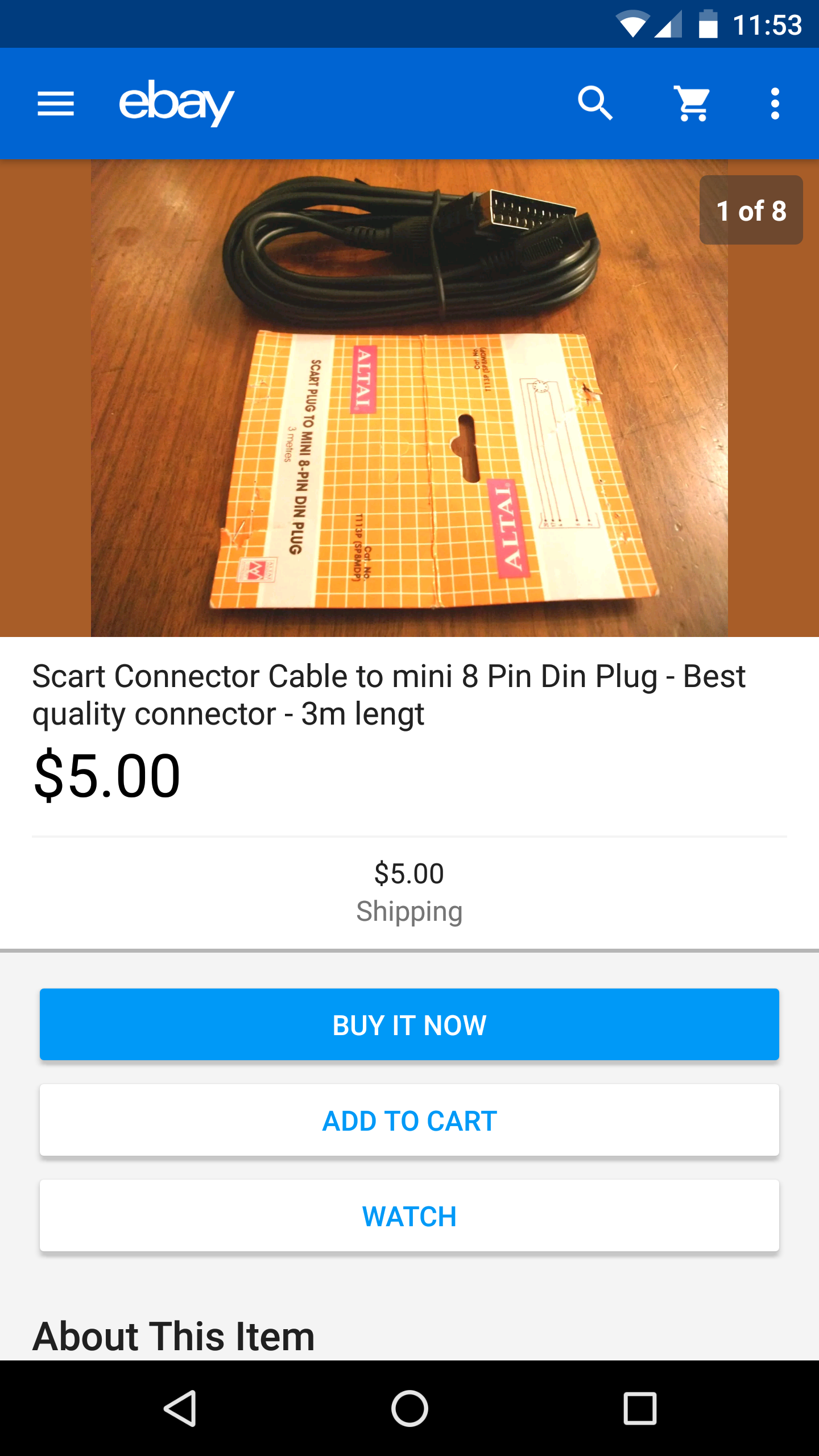

So this is what I'd need for "plug and play"? My soldering skills are still at the armature level so modifying the box my be disastrous.

Nope, but here's one that works.
