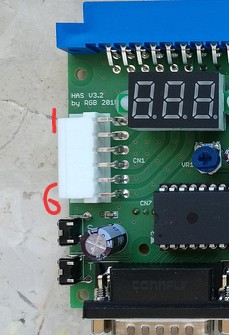

Hey RGB,
I'm having some issues getting sync with my HASv3, OSSC and CPS2 18-in-1. (The CPS2 and the HAS works fine via SCART, but when I bring the OSSC into the mix, things take a turn...)
My setup is as follows:
-CPS2 18-in-1 (the weird little daughterboard between the CPS2 and the HAS is part of the 18-in-1, for anyone curious.)
-HASv3 8-din to SCART adapter
-OSSC (with SCART input, DVI output)
-DVI-to-VGA cable to 31k Nanao MS-2932 (Sega Naomi high res only) monitor
I can't get sync to hold. See attached screens.

While I appreciate your suggestion of the Taito scaler, I evidently already owned all of the parts I needed to get things running, and was seeking some help to troubleshoot my issue (which turned out to be the placement of a jumper on the HAS.) While I may pick up that Taito scaler in the future to free up my OSSC for other stuff, I was looking to get things up and running as is, if not for just right now.
Anyway, my issue has been solved. Thank you everyone for your assistance!
