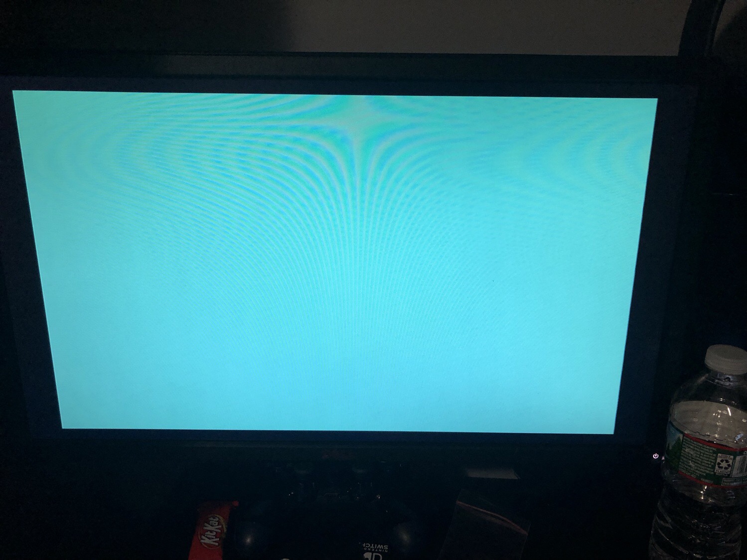

Someone help im getting a green screen ?( :/

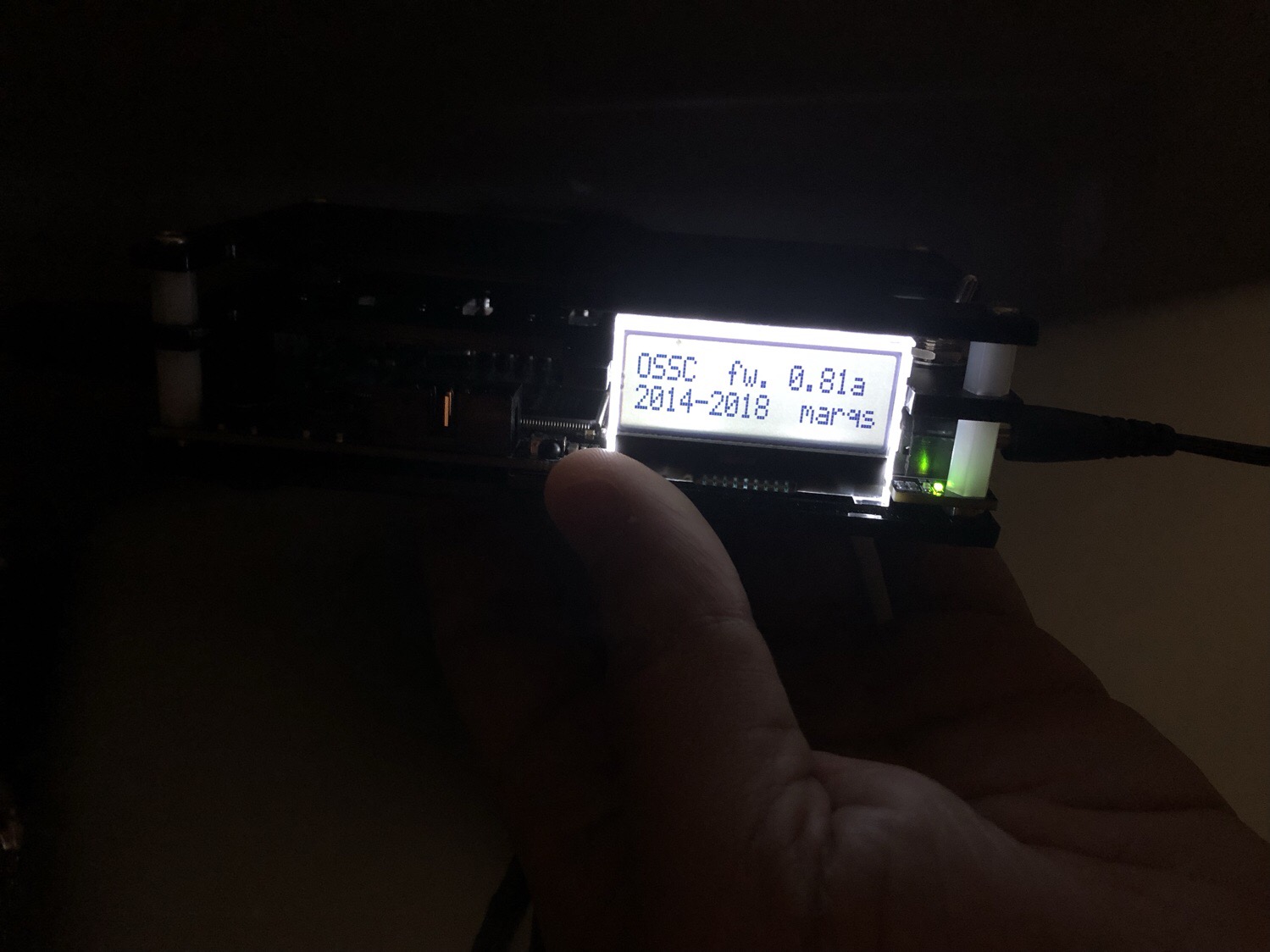

@KingSopz How is the OSSC connected to your display, and what kind of display are you using?
There is a little switch on the HAS near the kick harness connector and the AV out--try flipping that? (I believe that toggles the CSync Processor between a few different options, but check your HAS manual for details, as I have a slightly older model that used jumpers.)
The OSSC is displaying the correct sync information (59.63)... I question the CPS2 setup, it's "normal/common" for them to solid color screen like that.
I suggest you reseat the B board, it looks like the CPS2 A+B connection problem.
This. I recently moved my CPS2 Multi from my cabinet to a supergun set-up, and after I plugged it I noticed red screen and lines on the screen. Re-seating the B board fixed it up.
Hey guys i bought this A+B board dark soft from a guy in italy and last night was the first time I turned it on , maybe in the shipping stage something got loss, i know beginners stuff about the darksoft kit but i never mess with one :/ , @jassin000 been teaching me the basics of the cps2. If you have time jassin000 maybe i can take it to him so we can figure it out together that way i get some hands on leassons. But tonight ill try reseating the B board.
@KingSopz that's probably a good idea. But definitely reseat the PCB and press it firmly. If that doesn't work, short the EXE5 (or is it EXC5?) point with a screwdriver or something similar.
I tired this still no luck , i have someone around my area thats gonna help me this weekend to resolve this issue , ill get back to you guys with whats causing this

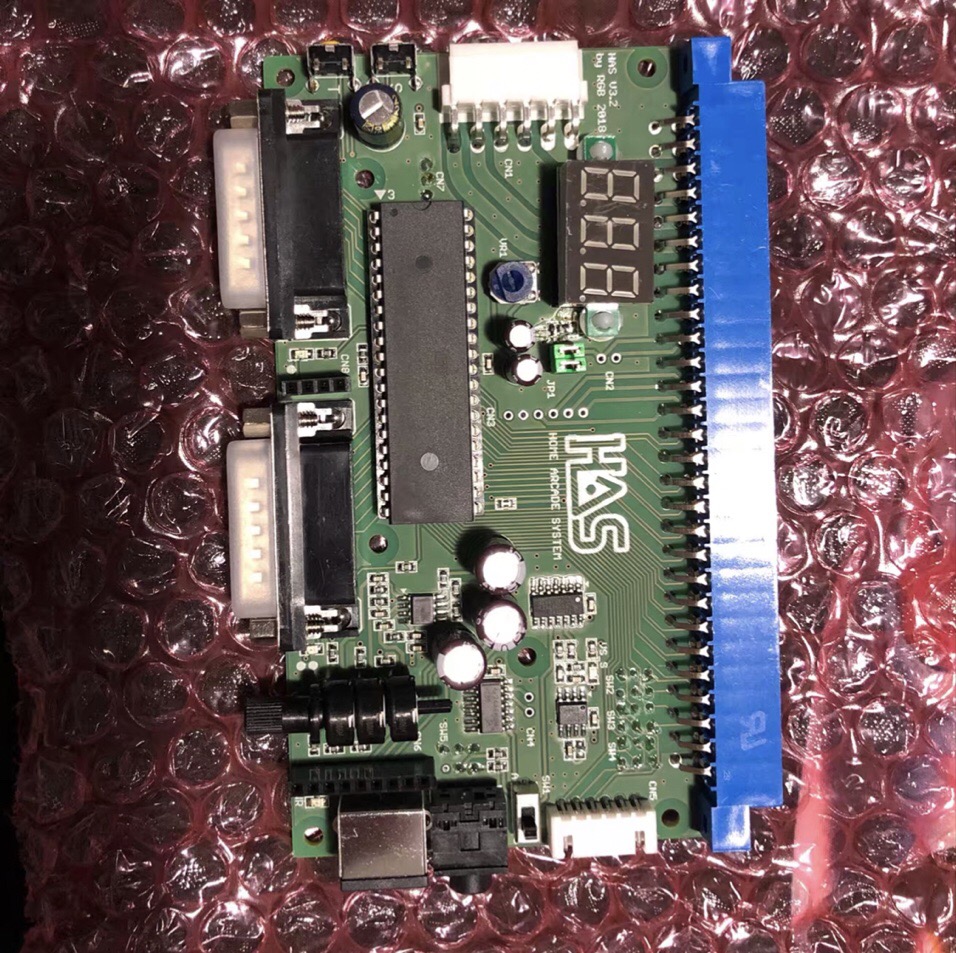

Thanks to @ekorz we got it resolved :thumbsup: , was simple as the darksoft milti not being press down enough :whistling: , thanks a million!.
Ps. @RGB do you have extra Voltage guage, mines worked the first day I connect the HAS but then it stop working. @ekorz did some testing on it and its differently that piece but the HAS its self works perfectly (See picture)
