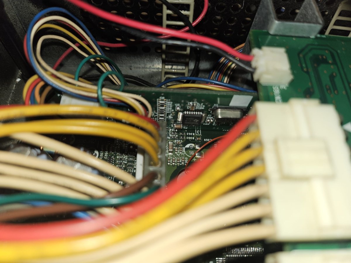

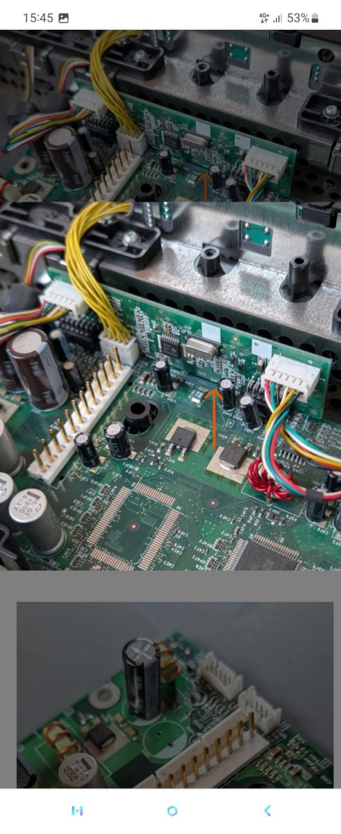

There's nothing special with 1.0's, you just need the USB riser -- the MCP requires it.
The v1.0 is the only one to mount this small additional PCB of the inputs.
It must be absolutely kept on the chihiro conversion, otherwise you will have the error 02.
This small pcb mounts an oscillator crystal and other logic.
