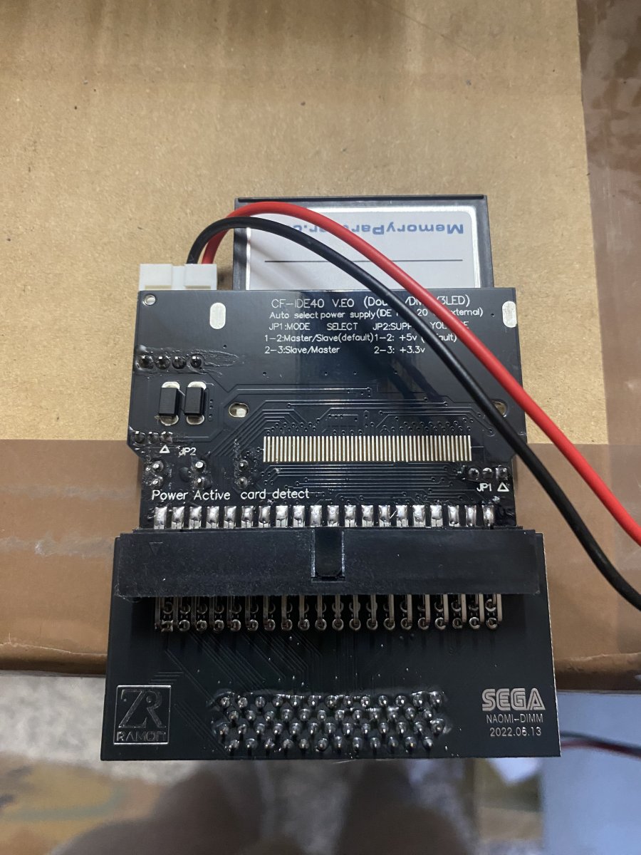

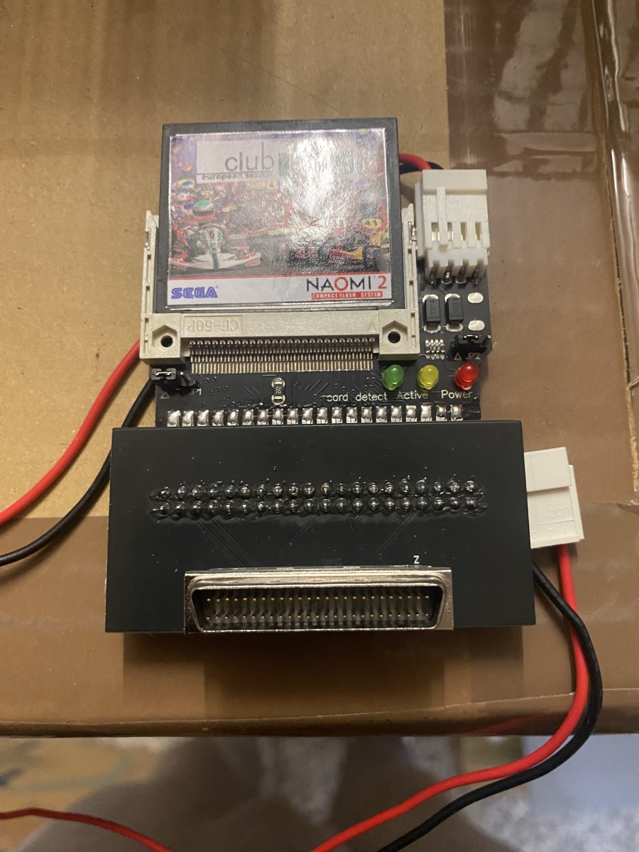

is the problem my pic or my adapter see pictures
this user had same problem I have, he said his problem was with the cf adapter.
I use this cf adapter, link below , I have two, both gives same feedbacks

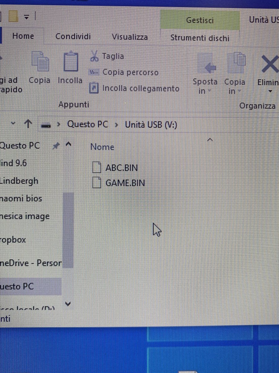

@rtw With your tools, can i check if the cf has been written correctly to work with your cf zero chip? Maybe the cf has not been written to work with ABC.bin
Just check if the card contains a file called: abc.bin

So i guess my problem is with cf adapter or with cf
I tested everything with 2 naomis and with 2 net dimms
Is anyone using the above cf adapter?

Can i modify the cf without rewrite it from zero?
Or can i get the cf id from this cf?
Because i don t have the adapter to read the sector
i rewrited the cf from zero burned the chip from first post but i still get error 26
