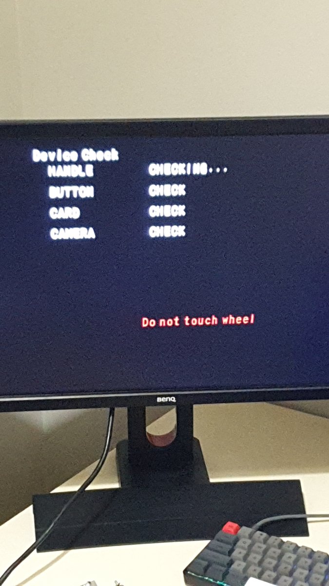

Good afternoon, I tried to netboot MKAGP1 and got into the Device Check menu (see pic).
After some minutes tho, the Triforce reboots and I get error 33 gateway not found.
So the problem is that when game is loaded first time, it boots, but then can't load from ram, except for its test menu, which after 5 minutes reboots into error 33 as well.
Is this normal beaviour without a pic? Or did I have some success?

If you are using the linux script triforcetools.py, try uncommenting the time limit hack to leave the netboot host connected. It's not the best fix but I've had that work for me on a Chihiro Type 3.

Sadly I used transfergame.exe + crossover connection since I couldn't set up the network on my arch linux install...
I even tried using a normal ethernet cable to connect the dimm to my router but that didn't work either.
If you have any advice on setting the network on linux, let me know.
In general what I do is set the router with no DHCP. Use a /24 (255.255.255.0 netmask), and then you would want to configure your linux laptop for any static IP in the range you use, be it 1292.168.1.x or 10.0.0.x or whatever. From there you also configure the system in the same range (I'm sure you get most of this already). So router at 10.0.0.1, laptop at 10.0.0.2, and system at 10.0.0.3 for example.

Hi guys, great news!
Everything works perfectly, everything I throw at it boots fine! (even mods like MKAGP1/2 or FZero GX for Type1!)
I've had good results with the tool suggested by @rtw , so thank you for the advice :)
Right now the only error 33 that I got was when I loaded FZero GX and didn't input anything for too long.
sorry for the mess... I still have to set everything up properly!
EDIT: NVM, apparently the dimm works even without the pic... so I don't know what's going on.
Maybe the pytool automatically detects if there isn't a pic and uses the time hack?
I truly don't know :/

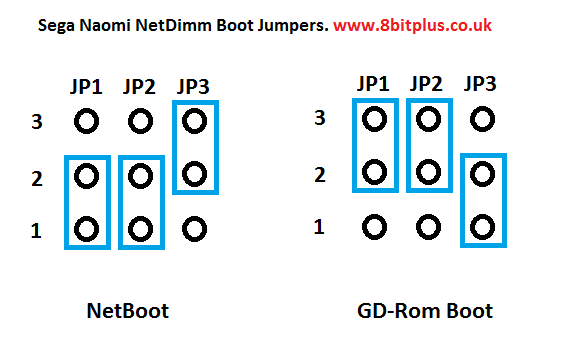

Your jumpers are set to GD-ROM when you try the CF yes?
Yes jumpers are ok
