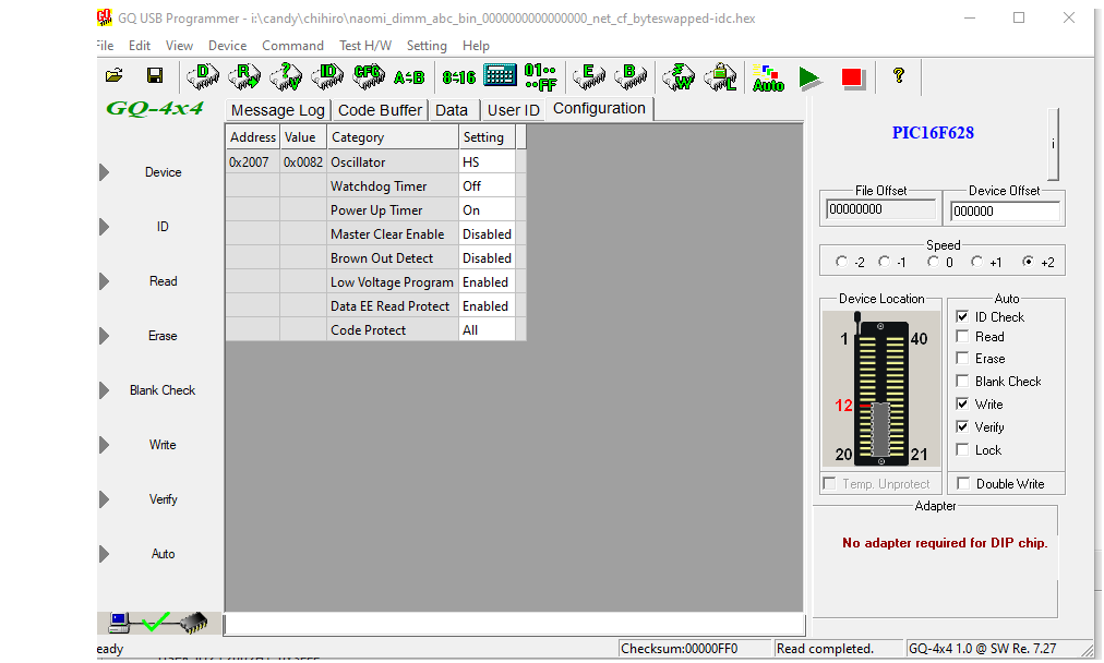

Just sharing my experience using the GQ-4x4 to create a zero pic. I just picked up this programmer and used the OP's BIN files and settings and wasn't having any luck. When I tried using the byte swap function on the buffer before writing it wouldn't verify (this was mentioned as a possible thing to check). I found idc's post and used the HEX files that were provided and that wrote just fine and worked on my Naomi NetDimm (via netboot).
I did notice three things:
  • With this HEX file it auto populates the Configuration automatically, which has a different 0x0082 value due to some "CP" bits set OFF (you can see this by clicking the Configure Device button and scrolling down in the Standard CFG Word Configuration box). I tried doing the same with the BIN image but it kept failing to verify when I did that.
  • The buffer with the HEX file and the BIN from the OP with byteswap applied looked similar, but some of it was different. Byteswap definitely looked like it was probably necessary but I can't account for the differences unless the code for each PIC used to create the BIN/HEX was slightly different. Both were for the NET/CF version.
  • The "USER ID" in the idc image had 4 "3FF0" settings, where as the original BIN posted had "3FFF" for each
If anyone knows the settings for the GQ software to make the original BIN files to work that would be great to know and document, but for any others with this device you may want to check out the HEX files posted by idc. It would also be useful to know what the difference between idc and rtw's files are as far as functionality, to explain the difference in the buffer code.

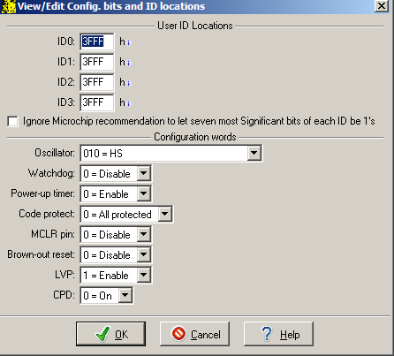

The following programmer settings should be used.
Oscillator: HS
WDTE (watchdog) disabled.
PWRTE (power up timer) enabled.
Code Protect: All protected
MCLRE should be set to internal also called "disabled"
BOREN/BODEN (brown-out reset) disabled.
LVP (low-voltage programming) enabled.
CPD should be 0, meaning that data code protection is on
This should give a config word of: 0x1e82
Huge thanks to @zeruel85 for verifying these settings

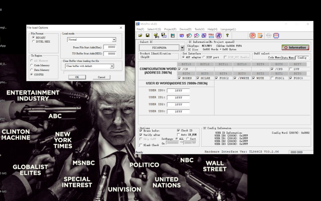

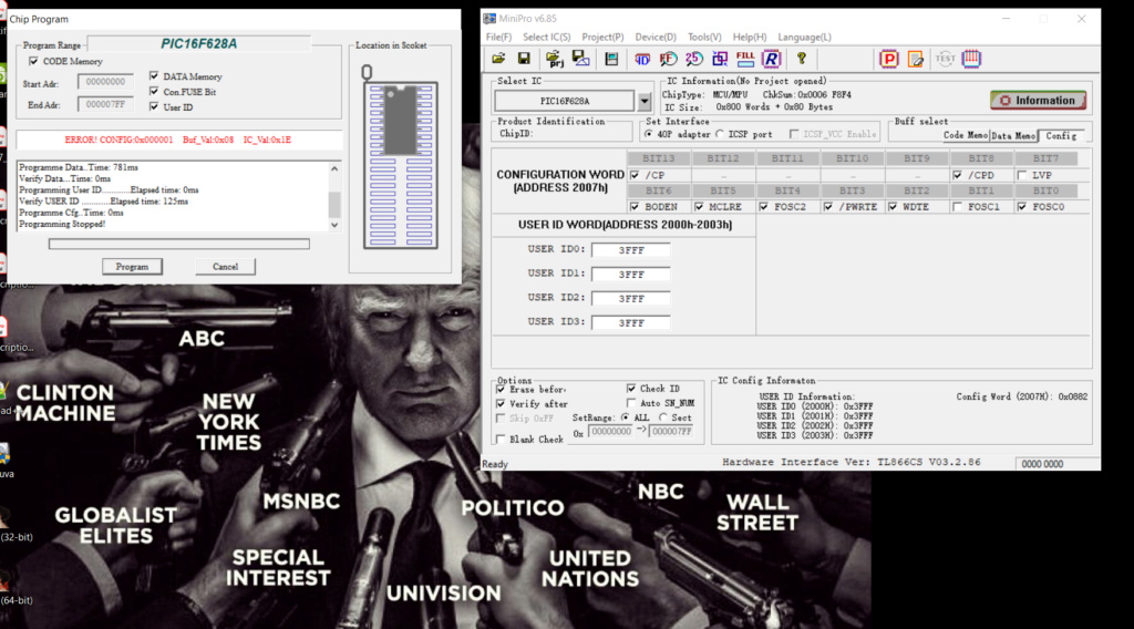

I tried with this set:
but dont work:
finally I found the good setting with minipro here
but I dont find with topall8 (top3000 programmer)
